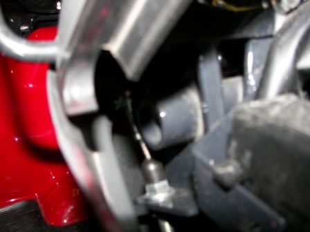

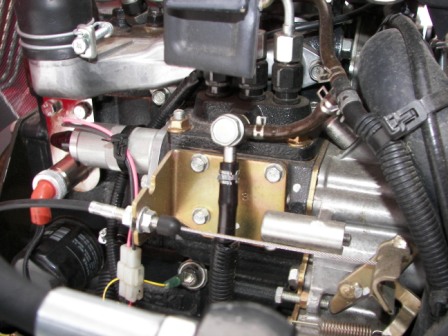

Purchased GC2410tlb new in November. It was stored outside (like at the dealership) for a couple weeks and since has stayed inside unheated garage. Only use has been in moving a couple buckets of wood every week or so, otherwise it grazes in the garage. Snowblowing I do with my JD 316 for now. So the first cold spell in December I think it was, I go to start the beast and the throttle won't move. Easily traced the issue to the vinyl sheathed cable that connects to the throttle lever from just behind the dash (see pic 1) sweeping down under the engine, then up on the other side where it mounts near the injector (pic 2). Initial call to the dealership was told to just warm it up (takes 40-60 min to thaw). Today on my second call they said they'd order a replacement cable and call me back when it comes in. Expect that'll take care of immediate problem.
My question is, "Has anybody else experienced this problem?" I'm just concerned that it might reoccur. Thoughts??? Lemme have em!! :)

Ive had a few of the 1500 series do that. I took them off and sprayed a penetrating oil down the sheath and worked the cable back and forth. It has worked so far. You might try this a few times a year just to keep the crud out of the line.

Thanks for response. I grew up on a farm with tractors, but in those days the throttle "cable" was a rod. The design on this GC2410 cable looks sensible enough even with the dip down under the engine it really doesn't seem to invite seepage... even has rubber grommets protecting the ends of the sheathing. IrvingJ had suggested there might have been something like a power wash involved but the dealership says they wash by hand. I guess if the hood were raised, and a hose pointed at the wrong spot, then it might push water into the cable under the right circumstances.
