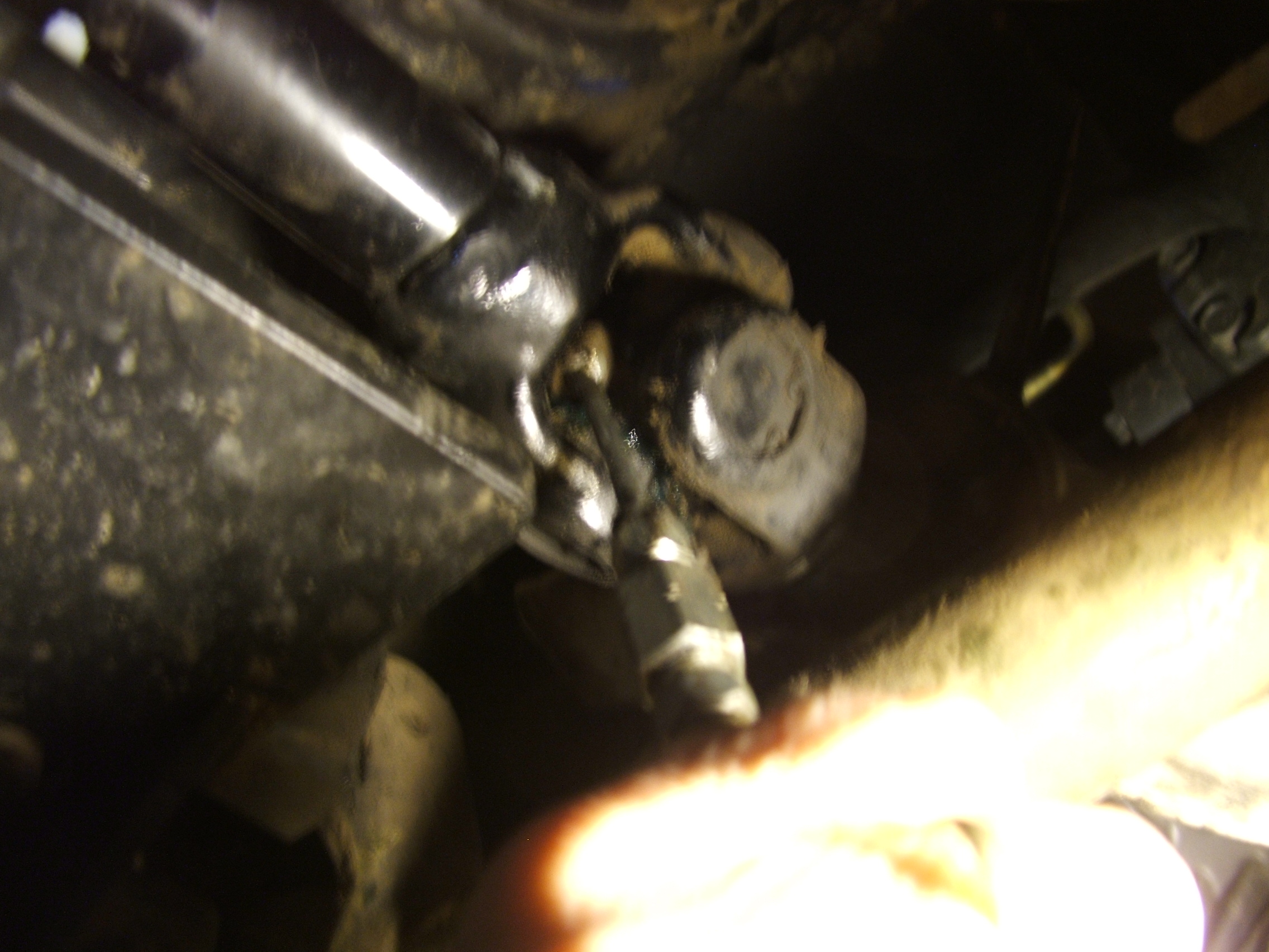

I was at my dealership last week and a customer was in there getting his JD2210 fixed after the engine to transmission driveshaft failed from lack of grease. It also broke the front case on the transaxle as it beat itself to death at engine speed after breaking. My tractor has 400 hours on it and has never been greased. I decided I would tackle the job of greasing the two u-joints on this shaft. I overheard the mechanics tell this guy that the only way to grease them was to disassemble the tractor, removing the floorboard, steering column cowl and fenders. I crawled under the tractor and could not see either joint and only about 4" of the shaft.
I crawled out and came to the house and googled it. I was referred to a thread on another website and from there learned a very easy way to do this task. On the left side of the tractor, brake pedal side, there is a 2"x3" rubber plug snapped into the steering column cowl. I removed that plug and here's what I saw, the front u-joint!!!
After reviewing the previous mentioned thread I cut a rectangular hole in the floorboard. The floorboard is double layered where I cut so it was kind of a pain but nothing like removing the floorboard and fenders as I was previously told to do.
With a grease gun needle tip I was able to grease both joints. I've contacted my dealer and ordered another rubber plug to cover the second hole. For info purposes the part # is M807480. I suppose you could get a plug from anywhere and then cut the hole to match. But you need the hole to be about that size and cut rectangularly to make it easier to get the needle tip on the zerk.
Monday I'm gonna go to my dealership and do the mechanics a favor and take them these photos so maybe they can pass it on to their customers and save them a LOT of money on repairs!!! :cool:

Congrats! At 400 hours you may have caught it in the nick of time. Hopefully. For I had never bothered to try to lube that shaft in the 8 years and 700 hours I owned my 2210, and paid the price. The tractor developed a bad shudder and upon examination the u-joint bearings were shot. Not easy to prove since you can't even see the &&$#&* shaft! I diagnosed it by pure logic. I posted the story elsewhere on these forums but I had to disassemble the entire tractor; ROPS, fender, floor, cowl, and dash. Then do the ship-in-a-bottle operation through a small steel plate in the right side of the frame to release a large C-clip from the front ujoint in order to remove the driveshaft. There was nothing left of the bearing but red powder! Now that I have new bearings I intend to install an access plug like you did. I will have to partly disassemble the rear fenders anyways as I had broken a couple of the PLASTIC clips that secure the fender to the floor. POOR ENGINEERING! Tough little tractor, but poorly built. Good luck!

This is incorrect. You do NOT have to buy the entire shaft. After completely disassembling my tractor etc. and discovering there was nothing left of my PTO "spider bearings" as they are called except for some reddish brown powder I went to JD and ordered up 2 spider bearing kits. I think they were about $30 each. Pounded out the powdery old ones and tapped (gently) in the new pin bearings, greased GENEROUSLY, and good to go!

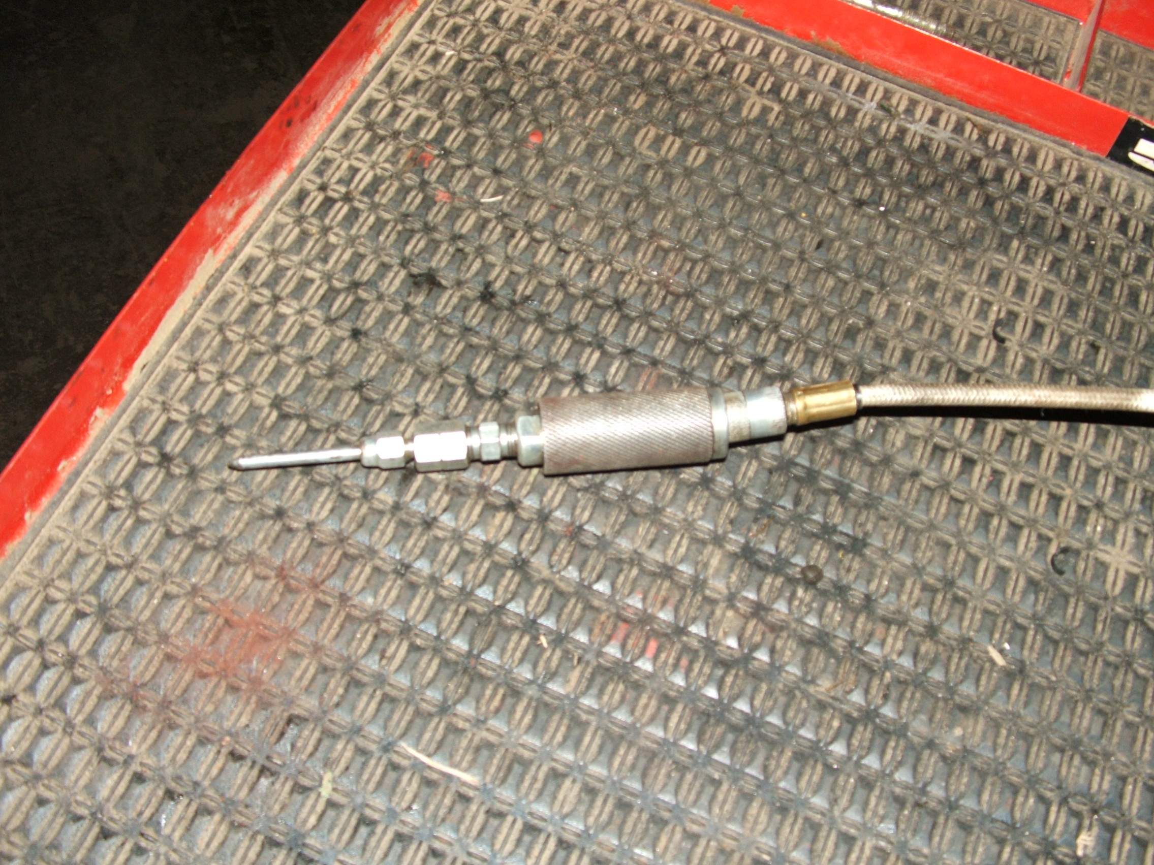

I always done my 2305 with good success from underneath. Are you using this?

Hey Henri88 long time, yes I used a needle like that, i just was not convinced the grease was getting to the joint, was very hard to keep the tip on the zirk and maintain a good seal to transfer the grease, we do have a access cover which I removed, but no sign of the u joint, just the backside of some cooling fins.
