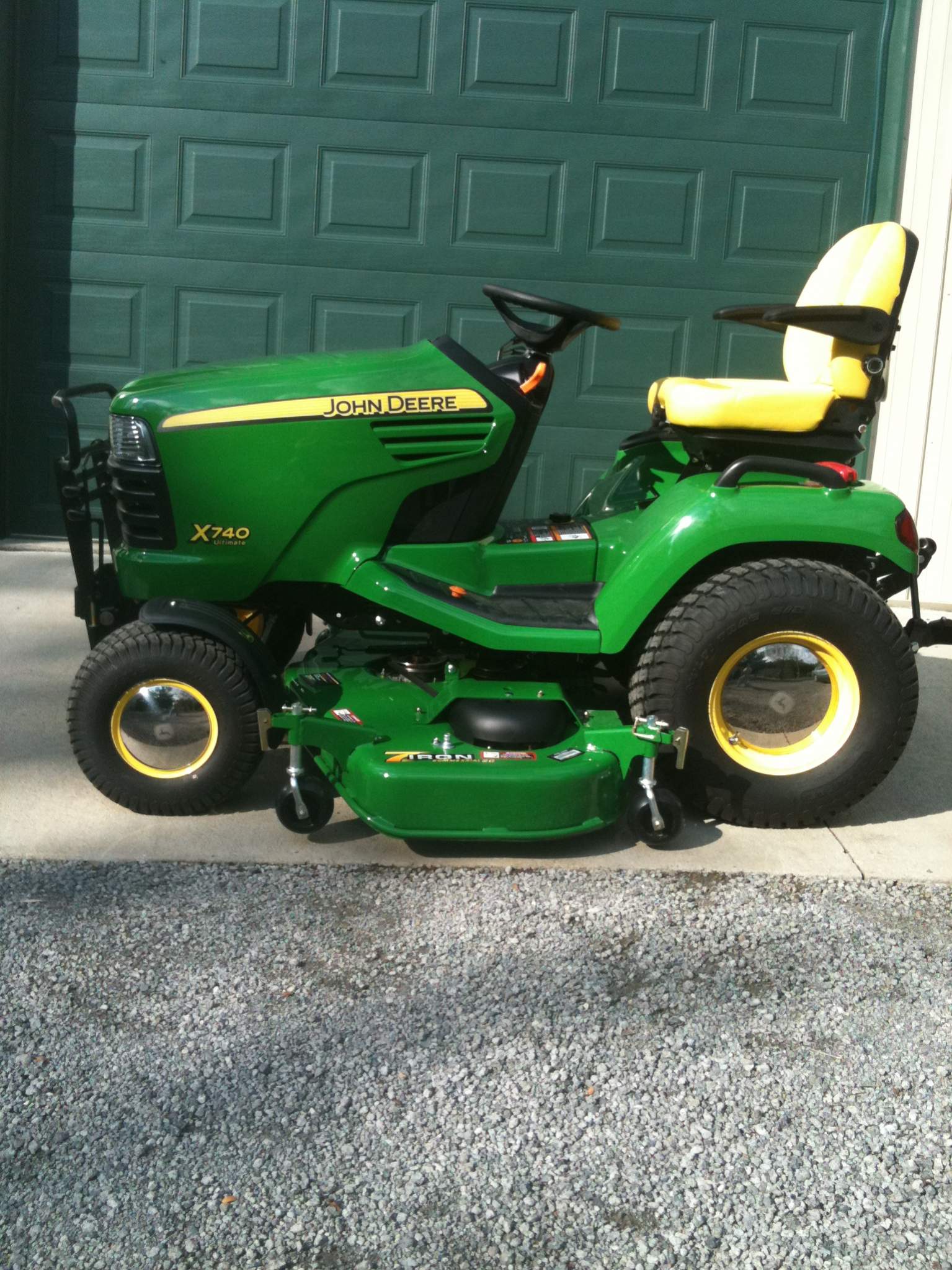

Kioti<really> (few crappy dealers)But you state you have a really good dealer within 2 hours? Which way is it? I fully disagree with your STUPID comment.I own both Deere & Kioti products and have good luck with both.Your comment is pretty shallow. Just buy a john deere product and not ask for anyones opinion? Bleed green & don"t look back,LOL.It"s your $$ spent.Here is a little green to make you happy!! Added some Kubota and Kioti to.Laffin..
