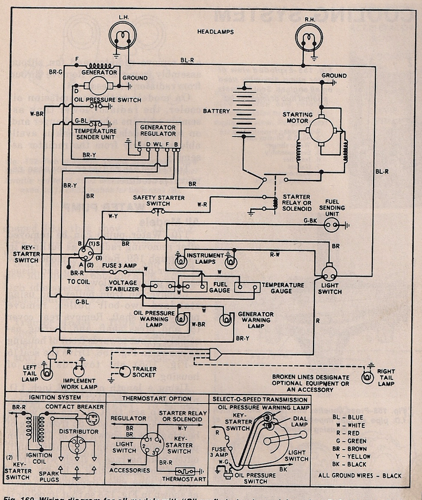

But there is one thing I noticed while walking in from my truck today - I see three bundled wires near the generator, but one is just dangling there. Two are connected to the back of the generator, but a third is hanging there. It looks like it might be a yellow wire, but the PO painted everything blue, so it's a little hard to tell.
Does that piece of info help anyone diagnose anything?
Thanks!
   / New (to me!) ford 3000, runs great, charging issue? #9
The oil pressure sender is just aft of the power steering pump, or where it would be located if it had P/S. That wire would be a female spade connector.
The coolant temp sender is in the front center of the cylinder head next to the thermostat housing. That wire would have a female bullet connector molded 90 degrees to the wire.
   / New (to me!) ford 3000, runs great, charging issue? #10
I have an I&T manual for your tractor I scanned the two wiring diagrams in it. Hope this helps.
It's the same wiring diagram for 2000,3000 ans 4000 series tractors. The first diagram is for tractors with a "C" prefix in the serial number and the second one is for tractors with an "A" or a "B" prefix in the serial number.
