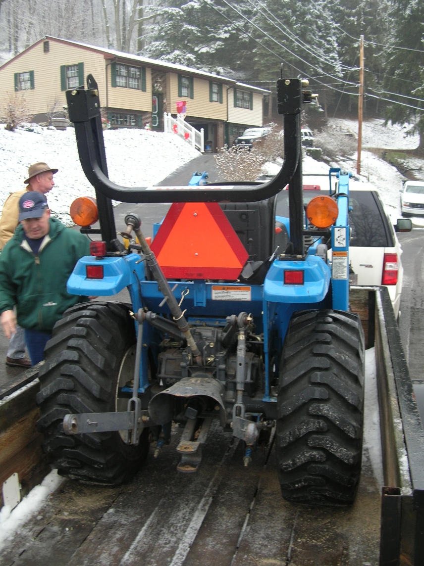

In the picture it does appear that it is HST. But those do not look like AG tires, they're Industrials or R-4's, if I'm seeing right. The 1999 TC18 is strictly that, no D or DA.
Mine is a 2003 with HST/914 mower/LA12 loader and sold for $12,000. $400 for the trailer may be a great deal depending on its condition. If you're looking at pulling trees over and skidding 20" diameter logs, be careful as the tractor is only 1400 lbs plus loader weight.
I'd say 9K may be a decent deal if it has been maintained well.
