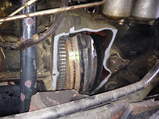

2.00 star(s)
Anonymous Poster
45DI Tafe
Unreliable and Unsafe
Model Year: 1999
Hard to find parts, hard to find service and repairs. Cast parts on tractor are weak. Like steering arms rod ends that wear out in only a few hours. I started the tractor this morning and the engine ran away could not shut it off. The flywheel came apart blowing the side of the engine case apart and blowing holes thru the barn walls. If any one had been standing beside the tractor they could have been seriously injured or killed. I am lucky that I was not seriously injured or killed today by this tractor. This is a poor quality and unsafe tractor. I would not recommend this tractor at any price. You can't get parts any where but London, KY. And their parts are limited. If you have one of these tractors becareful!
Pros: None.
Cons: Everything unreliable and unsafe.
Photo Uploads:
