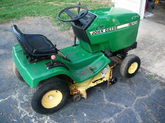

The Early John Deere 130
Model Year: 1986
Hi, The original model 130's were made from 1984-1986. They came with a Kawasaki nine horsepower engine and Peerless five speed transmission. They are known for their durability over the newer LA-130s. You could have got one with a 30" deck or the wider 38" deck both single blade deck's. They offered a snow plow and snow blower for these machine's that ran off the front mule drive system. They had an electric PTO clutch made by Orgura.
