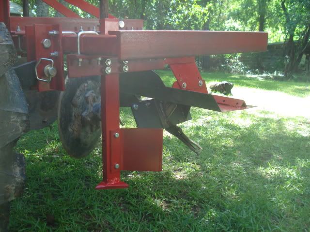

Seeing the pics reminded me of why I got rid of my Disc Hillers and built this instead:
That really looks good and simple too. I see you paint your designs to match your tractor too!!:cool:

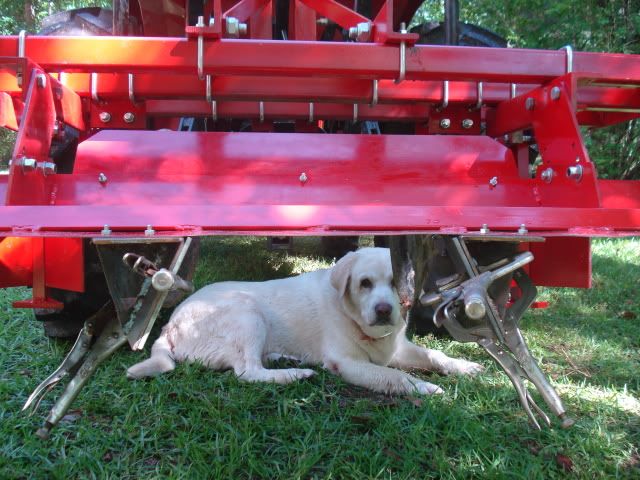

I finally got the head of R&D involved in my design.
Her helper taking a break in the sun.

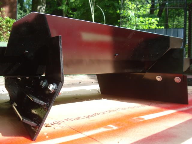

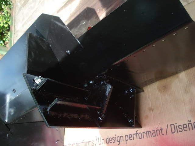

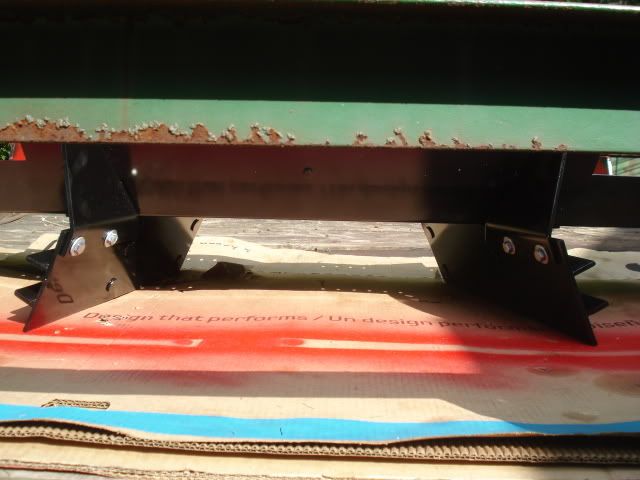

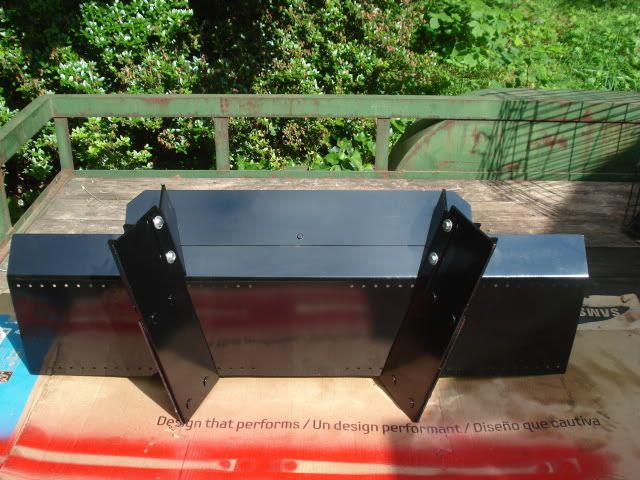

Would you have pics of your forming pan or is it just a "flat pan"?
Updated pan design change - Riv-2.1
I did not get to the farm this weekend as I help the USFS once a month and this was the weekend to help out. I did get a chance during the week to upgrade the chutes on the pan as I brought it home from the farm. I made them longer and higher to catch more dirt. Hope to try it out next weekend to see how she does.
