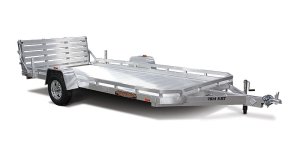

I am in the process of buying a all aluminum utility trailer. I am looking at 6-7' by 12'. I have pretty much settled on a Aluma or a Legend. The Aluma has a all aluminum deck, rail/sides that are bout 6" tall and a bi-fold back ramp/gate. The legend has a full ramp at the back, a wood deck and rail/sides that are about 15" tall. Has having a tailer or shorter side around the trail have any advantage - taller over shorter or shorter over taller? The pictures below show the rail difference.

IMHO,
I would not have a wood deck ever again. I am a maintenance free fan.
I am also not a fan of full tilt up rear ramps as they act like a parachute and reduce tongue weight when empty.
Side rail height to me doesn't matter much as I only use it for tie downs.
I would pick the Aluma I guess. NICE looking trailer too.

My preference would be the higher sides and wood deck. Plus the dual axle and higher load capacity for a 12' long trailer. Once you have a trailer like that, you will find more things to haul with it. Or your friends my ask you to. Wood decks last long enough for me and can take a beating in the mean time. Not as slippery when wet and better for cribbing and blocking thing in place. Again, just my personal preference.

If you ever intend to put pallets on the trailer the side rails will be a problem. My trailer doesn't have any sides, but instead has stake pockets so I can put sides on with a 2x4 stake. I currently have 16" tall sides (3 - 8' long pieces out of a sheet of plywood) but have run with 4' tall on occasion. You may want to consider how you'd attach solid sides so you can haul stuff like dirt or gravel.
