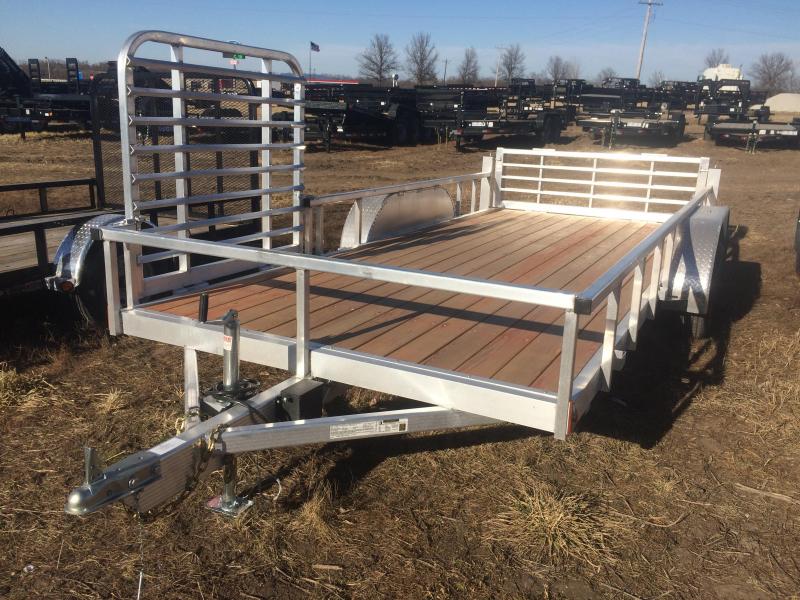

I am in the process of buying a all aluminum utility trailer. I am looking at 6-7' by 12'. I have pretty much settled on a Aluma or a Legend. The Aluma has a all aluminum deck, rail/sides that are bout 6" tall and a bi-fold back ramp/gate. The legend has a full ramp at the back, a wood deck and rail/sides that are about 15" tall. Has having a tailer or shorter side around the trail have any advantage - taller over shorter or shorter over taller? The pictures below show the rail difference.
Had to choose between both you have listed,went with the Aluma 7X12.Been a great trailer went with the ramp gate.

Hauling brush around my property, hauling the zero turn and Gator occasionally. Don't want a tandem axle. Would mainly be pulling it with a Jeep Liberty. I want the higher weight capacity that the aluminum offers because I want to get a Kubota RTV some day and it is a little heavier than your standard side by side.

If you ever intend to put pallets on the trailer the side rails will be a problem. My trailer doesn't have any sides, but instead has stake pockets so I can put sides on with a 2x4 stake. I currently have 16" tall sides (3 - 8' long pieces out of a sheet of plywood) but have run with 4' tall on occasion. You may want to consider how you'd attach solid sides so you can haul stuff like dirt or gravel.
The Aluma has stake pockets.

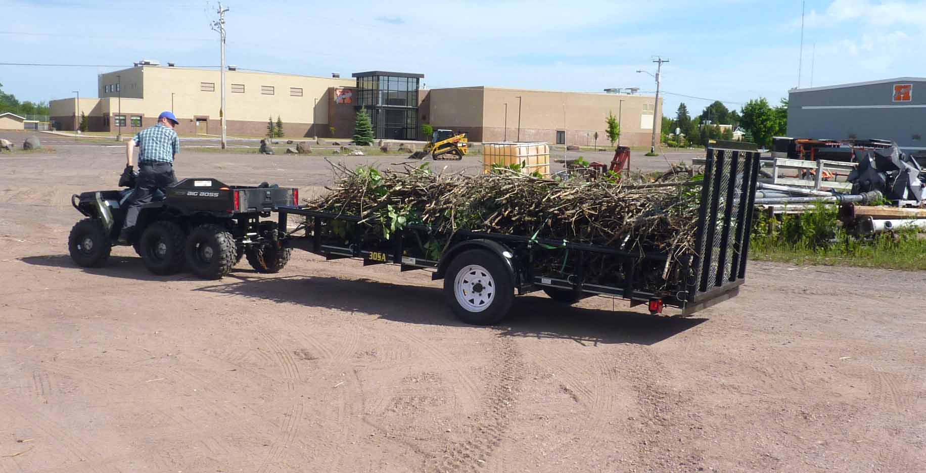

We recently got a single axle, 5x14 Big tex trailer. We wanted a 12ft one but this used one popped up FS and we got it. Since then, we've been hauling brush with it and became very, very happy that we accidentally got the 14ft. We use our 6x6 to tow it.
