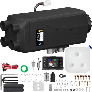

Been thinking it would be nice to have some heat around when plowing and eventually blowing snow on my uncabbed tractor
Noticed these inexpensive 5000-8000 watt vevor heaters for ~$120 that have four port output. Thinking if I can find a place to mount it could direct 3 ports to the operator to keep warm-er than no heat, and one to the intake for even faster cold weather starting.
Should be able to T into the diesel fuel line so no tank needed and also the interface runs on 12 volts and is only supposed to draw about 50 watts so no need for a separate battery.
The unit also has a flexible exhaust to direct it away from the area where the heat is.
Anyway ordered one and we will see, and if it just works for some extra operator heat that is OK to. Or this could be a complete fail... Will update when it arrives and get it installed.

Looks to be fairly compact at 4.5" square. Wonder if a person could mount it under the hood?
   / Cheap heat for uncabbed tractor plus intake preheat?
Yeah it is fairly compact but has a fairly long axis.
Just seems like it would be pretty adept for use with a diesel tractor.
I "think" it will fit under my oil bath air cleaner and should be right next to the fuel line as well.
My fuel tank runs directly under the hood so that area is out, but I probably do not need to use the included fuel pump- but anyone with a tank down low like under the step the pump will be nice to have.
The heat output should be above 20000 BTU when cranked up.
   / Cheap heat for uncabbed tractor plus intake preheat? #4
I've got two of these diesel heaters (5kw and 8kw) and they work very well. I use one that has thermostat control to heat my wife's greenhouse. The other that lacks thermostat control I use in my workshop to take the edge off of cold.
They are very popular with the European RV crowd and there are tons of YouTube videos on them (ICWeld on YouTube put one in his wife's greenhouse). On startup they use a glow plug that pulls several amps, once fired, the current is minimal and used for the injection dosing fuel pump and two fans.
Because the fuel pump delivers a known quantity of fuel to the heater, under pressure to atomize, you have to use the pump supplied. The heat output level is adjusted by the controller by varying the cycle speed of the injection pump.

A great review - includes a complete braekdown of the units construction and function - Looks like a great workshop heater !
There is a huge selection of models too > VEVOR Diesel Heater | VEVOR US

I was going to use the hoses and the four outputs Mainly for my Feet one for each foot and maybe one aimed at the chest Thought it might be neat to direct some hot air at the engine intake since it would also be right in the same area.

Don't know about the Vevors, but I have an older (bigger) Espar unit in my boat. Great heat output, but be careful of the exhaust routing as my original burned through due to alignment issues. I'd also be leery of material quality & maybe invest in a CO monitor if pointing towards face. The Espars were set up similar to the old VW Bug exhaust heaters & if the heat exchanger burned or rusted through, it was direct exhaust to passenger compartment.
