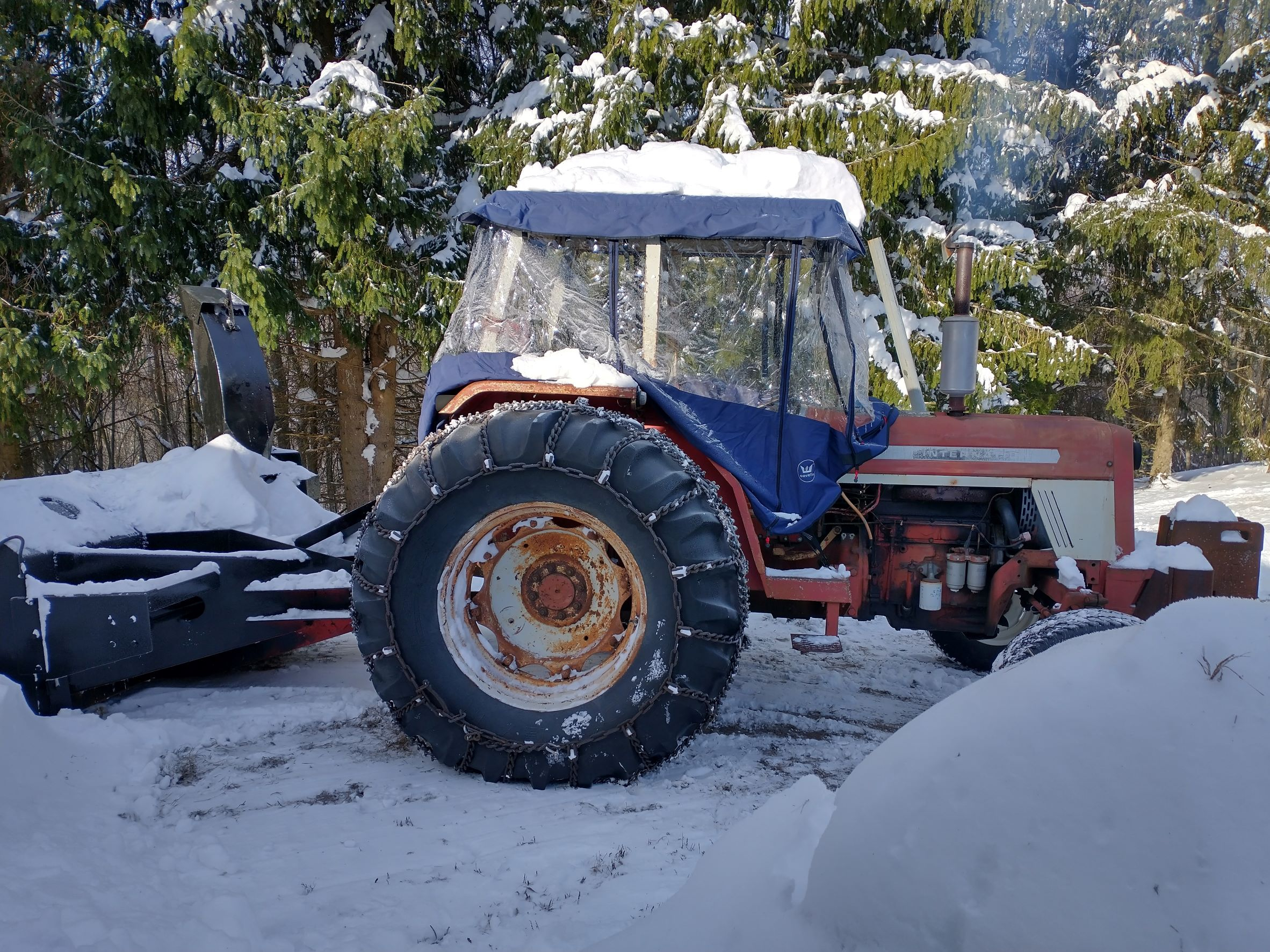

What I did for my non cabbed tractor which has a canopy was to get a golf cart cover,
it provides wind and snow protection which makes for nicer working conditions.
That with the mentioned heater might be nice, but just keeping most of the wind off is a large help.

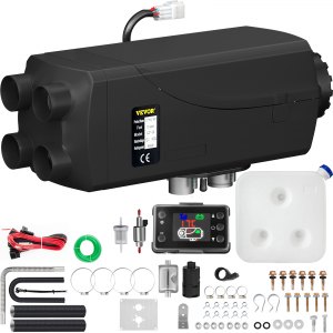

Don't know about the Vevors, but I have an older (bigger) Espar unit in my boat. Great heat output, but be careful of the exhaust routing as my original burned through due to alignment issues. I'd also be leery of material quality & maybe invest in a CO monitor if pointing towards face. The Espars were set up similar to the old VW Bug exhaust heaters & if the heat exchanger burned or rusted through, it was direct exhaust to passenger compartment.
Lucky for us the VW cars leaked so badly there wa always an adequate supply of fresh (freezing) air.

Been thinking it would be nice to have some heat around when plowing and eventually blowing snow on my uncabbed tractor
Noticed these inexpensive 5000-8000 watt vevor heaters for ~$120 that have four port output. Thinking if I can find a place to mount it could direct 3 ports to the operator to keep warm-er than no heat, and one to the intake for even faster cold weather starting.
Should be able to T into the diesel fuel line so no tank needed and also the interface runs on 12 volts and is only supposed to draw about 50 watts so no need for a separate battery.
The unit also has a flexible exhaust to direct it away from the area where the heat is.
Anyway ordered one and we will see, and if it just works for some extra operator heat that is OK to. Or this could be a complete fail... Will update when it arrives and get it installed.
