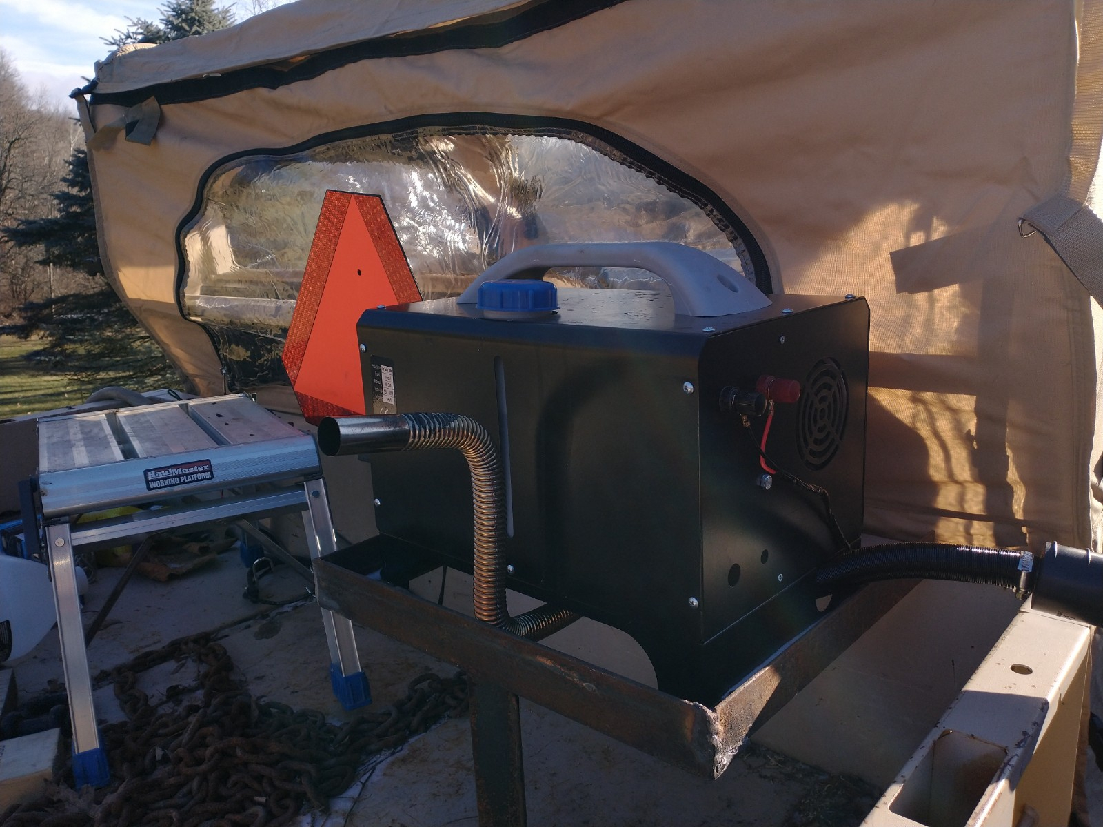

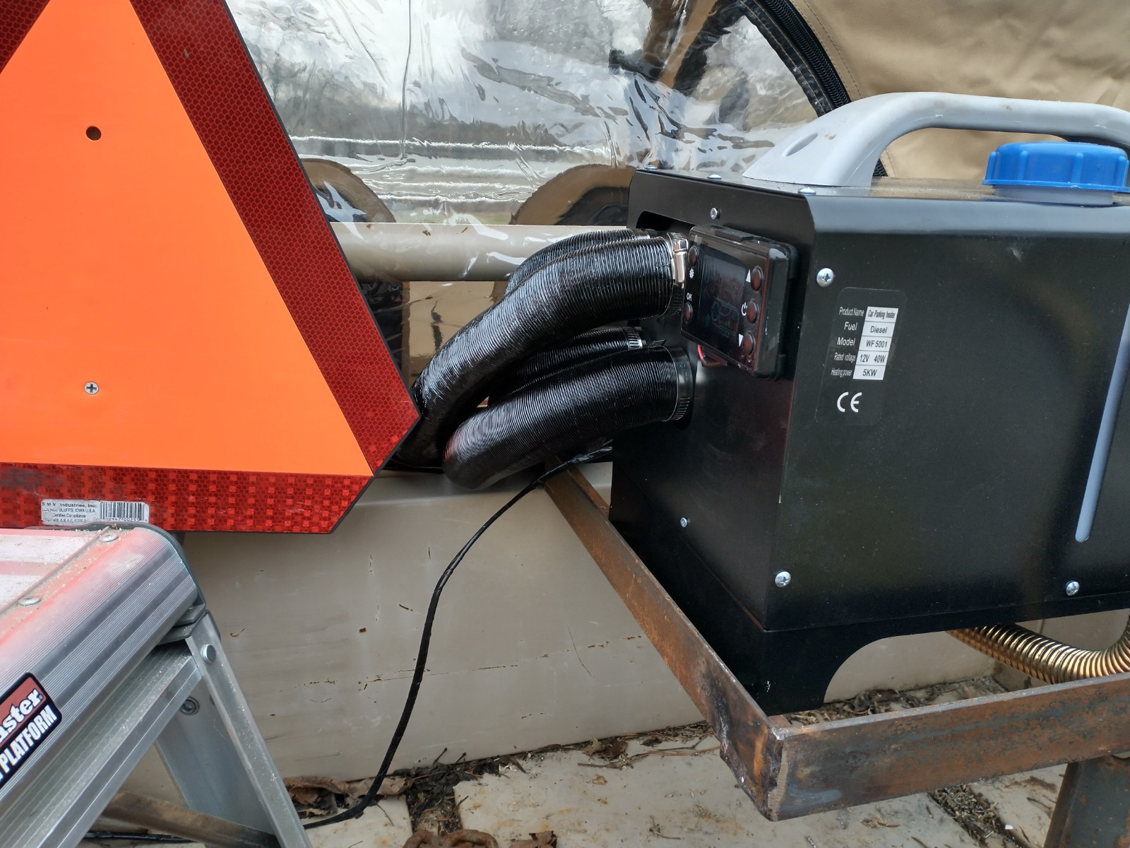

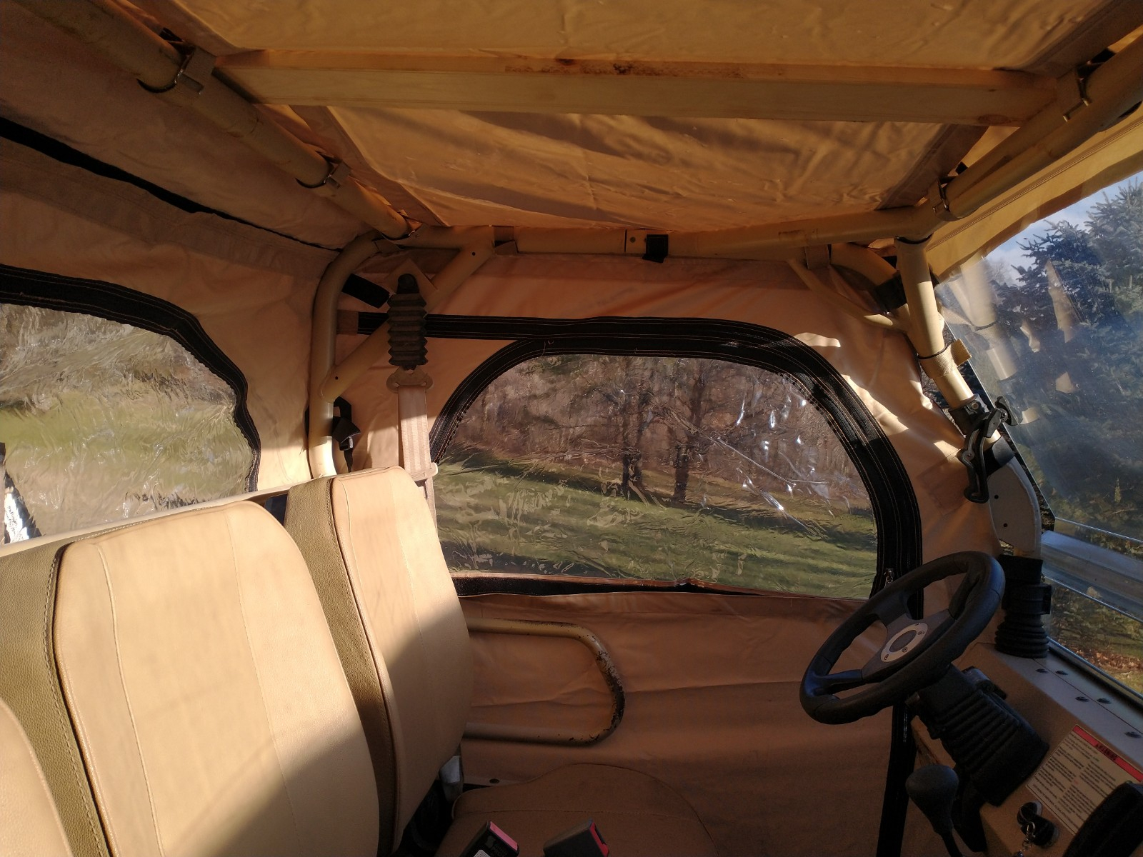

I ended up getting one of the smaller heaters and installed it in my SxS works great, I ran two ducts down in the footwells and two over to the windshield.
I thought I had more pictures of the inside heat ducts but I couldn't find them.
Looks Good Lou and effective mounting solution.
I like the four tube heat output as well and that is also my plan to direct heat to multiple places.
Good to hear it works great.
