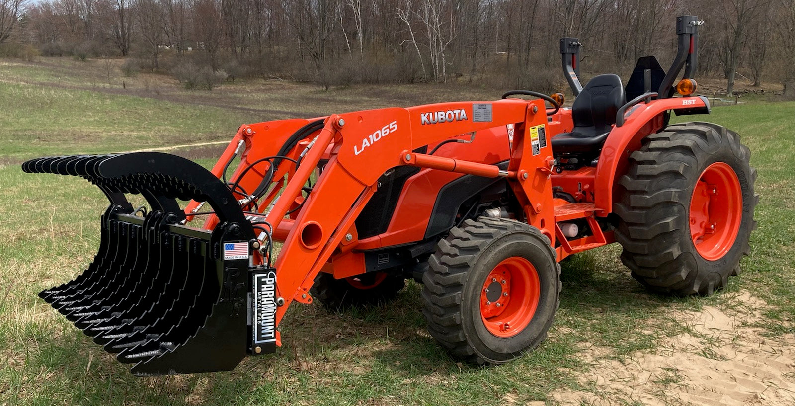

I am looking for a new grapple. The one I first got for my Branson 3515h did not hold up. It is bent up from the soft steel used in it.
I was looking at EAs wicked 55 but since that company is in limbo right now I have been looking at alternatives. EA uses ar400 I believe but I found a nice looking grapple at paramount fab. It uses grade 50 steel.
1 what’s the difference between the two types of steel.
2 what is the best steel to use that is strong and lightweight in a 55-60 inch grapple .

Thanks for all the replies. I bought a cheap grapple when I got my tractor and I have bent it up pretty good. Can still use it but I don’t have a huge tractor a Branson 3515 h but I think my grapple is more suited for a sub compact. I like the clamshell style. I was thinking of a replacement that matches up closer to my loaders capabilities. I want something strong but 400lbs or less.
