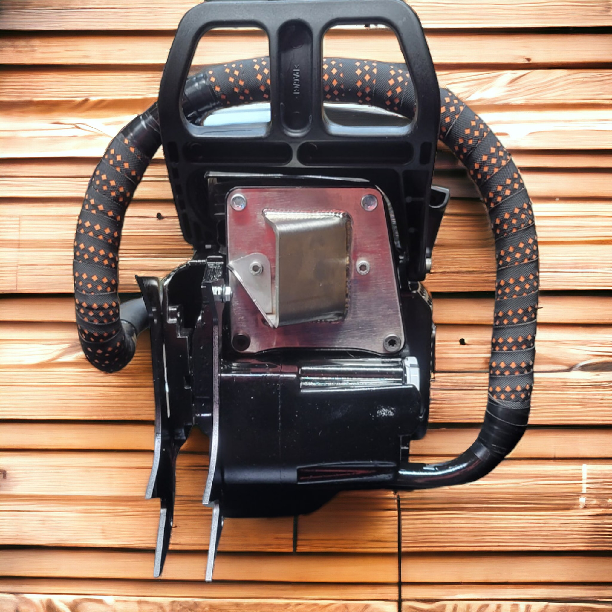

Want a better built cover and proven better even on dyno. Egans straight shots. IMO.
For some reason I didn't think Egan was making one for the 261 yet. I own a couple of his mufflers and really like them. I also like that he dynos the saws and shows you exactly the gains from them. People woul be really surprised if they knew how much power these muffs add to a saw.

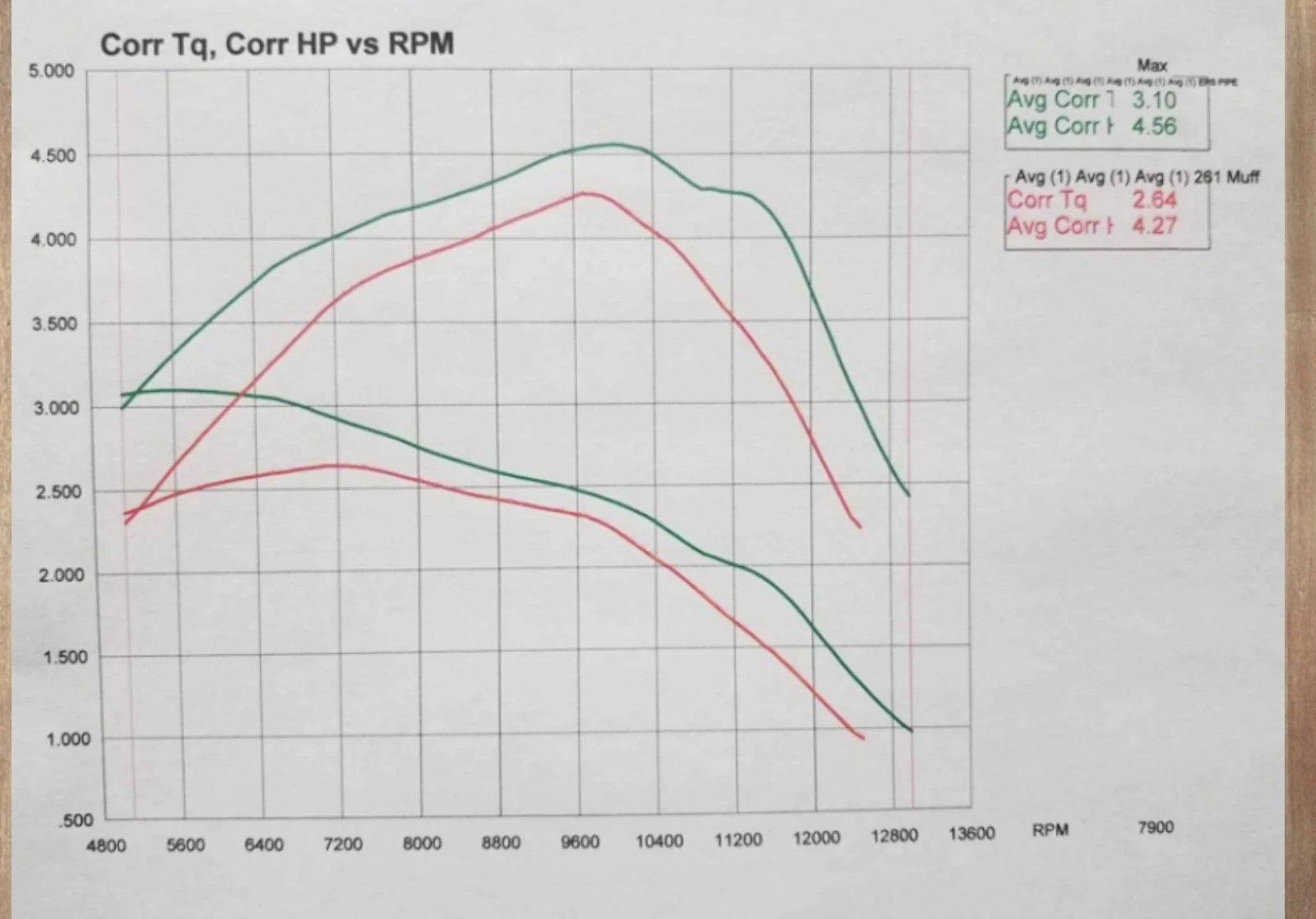

Here is a dyno of just muff mod on 261.
Nice! Looks like roughly +28% torque and +32% HP at 12k RPM. When you load it up, and RPM's drop (e.g. 8k) the margins get thinner, but still not bad. Also, RPM's are unlikely to drop as much with the higher torque up high.
Any word on how it affects operating temperature and reliability? Whenever I bring up mod's to my local saw shop, that's always their first response. I'm running some 30 and 40 year old saws every weekend, and one of them was bought off a pro that used it almost daily for most of it's life. These things last a long time in stock configuration.
I have ported mufflers on many of my saws and run some every single day for a couple hours and 6-10 hours on weekend days. Have a few years on some of them with no issues.
