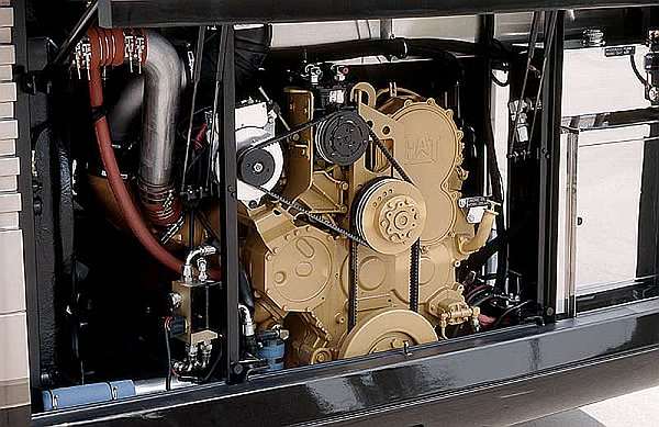

I'm not as excited abot the 500hp, as torque in the 1250+ftlb range :D
Our first out Engine has an 8.9L Cummins. It is 350hp, but torque is through the roof.
crbr said:
Bragging rights start when GM puts a 500 HP Cat in a light duty truck. Call me when they come in. :D

Chuck_Lind said:
What would the price be for that? Let's see...right now it's $8200 extra for a Durmaxx/Allison combo. Same truck with a CAT engine...at least $25,000 or more for that option; assuming they would ever have that combo.
I'll take it.

Based on what was discussed here, in all good fun, I was thinking and calculating..... For the price of a truck, say $36K (with the gasser standard) and no $7500 optional increase, that still leaves a man or woman with a $36K truck. I am one my third on in 7 years. I was hoping to have had the 2001 last me for 15 years (as did the last 87 model gasser did).
All said, 36 + 25 (for the Cat) = $61K .....and the stipulation to all of this is longevity and medium to heavy duty use, relative to these light duty Duramax, PowerStroke, Cummins..... Face it, they are all light duty and disappoint folks upon failure on lack of performance, because one's expectations of the investment is high (myself included, as stated here). I have worked this 2500HD to its limit and still want more.
With that being the point, I'd pay $61K for a heavy duty Cat 500 HP to last me 15 years. I'd come out much ahead.
Three of them up to now at avg 42K = $126K. Half of what the Option Cat 500 at $25,000...
Like I said, I'll take it and not gripe about it one bit... As a matter of preference, send me two... :D
Thanks for the auction... Now go make me a saMMich and deliver me my truck with the 500 Cat... :D
