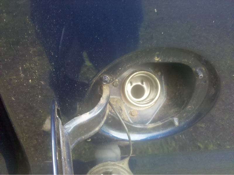

Could those of you with a late model Ford superduty gas pickup take a look and advise whether there is a little flapper that the gas pump nozzle must push open to fuel the truck? Last week, for the first time in 4 years my truck didn't want to accept fuel, even though it had only 1/4 tank. There's either something obstructing the fill line or the vent line. I tried inserting a fish tape, but it wanted to snag on something, which seemed odd. Here's a pic of my fill opening. I'm wondering if the flapper dislodged. I doubt it was ever there, but thought it worth asking.
TIA,

check in behind the filler and under the truck; the vent hose may be kinked or disconnected from the emissions canister that it attaches to. Check for build up of mud or road crap, if none visible then you may have to replace that unfortunately expensive canister. hope it helps.
/ '08 F250 Gas fill #3
I have never owned a Gas Superduty but have had 3 diesels. No flapper. Also had about 10 F-150's and Ford SUV's and non of them had a flapper. I am wondering if someone did not tamper with it? Maybe broke off a siphon hose in it?
I would also check for blocked or kinked hoses. You may have to drop the tank or just remove the claps from the hose that connects the filler neck and tank and take a look.

Thanks all. I've inspected as thoroughly as possible from the outside ( under the truck) with no evidence of anything amiss. I am concerned that someone may have messed with it, because the problem started after I spent a night at my workplace and a night at the dealer's waiting for an air conditioning condenser. It may be the charcoal canister because I just got a check engine light as well. Hard to understand with only 15K miles.

I tried inserting a fish tape, but it wanted to snag on something, which seemed odd/QUOTE]
This makes me think there is a ball/float blowback preventer in the line that is jammed.
On my truck there is no evidence of this little item from the outside. It would prevent syphoning of fuel from the tank.:)
It should not be difficult to disconnect the filler hose and cap portion.

scan the truck to see what code is in it. You say the CEL came on at the same time as your problem? That might help you decide what direction to look, espescially if it is a vent valve code.

It turns out it was the vent valve. Service writer told me it was "full of dirt." I asked if it was a normal service item and he said no, but to let him check something. Then he said it would be covered under the emissions warranty.
