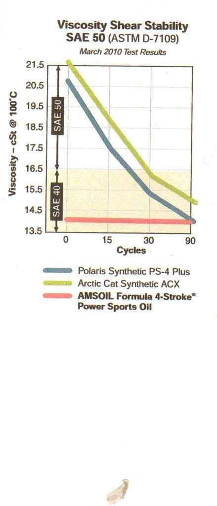

Wow... went out and looked at all my bottles and they all say 0W40 except for the newest one, it says 2W50... I hadnt noticed...
I am running a good 0W40 synthetic. Noticed the 2W50 when I was going through my manual. I change every 50 hours anyway.
   / 0w30 vs 5w20 #59
but for how long will it stay a 50, not long at all.....
