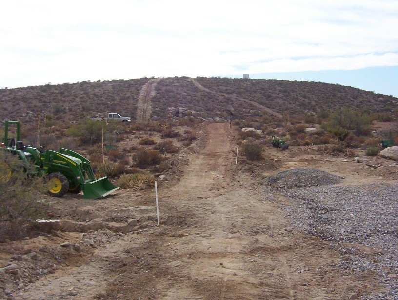

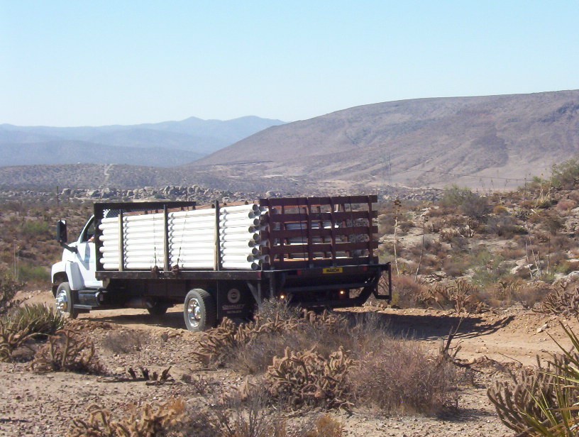

I went with the recommendation of the Well Drilling Company and used PVC Schedule 40. I have 1.5 inch going up, and 2 inch coming down to my house and cabin/ bathroom building. Then I have a 4 inch line that will run to my fire hydrant.
I took off Wed. and starting laying pipe. I got about 500 feet of 1.5 inch layed and about the same of the 2 inch. I am working from the well up. Sunday I am planning on putting in risors around the house site, cabin and bathroom building, adding some valves and back filling the first 500 feet. This will allow me to drive in rather than walk and then I can use my tractor to haul the heavy 4 inch galvanized line through the wash and get the rest of the materials up the hill.
I had planned on putting some 10 gauge wire in conduit and running it in the trench for a float system that would start my generator which would kick on the well when the tank went low. ( the county will require this I am sure) I did some research and learned that I can do the same thing with a remote wireless device like a key fab!

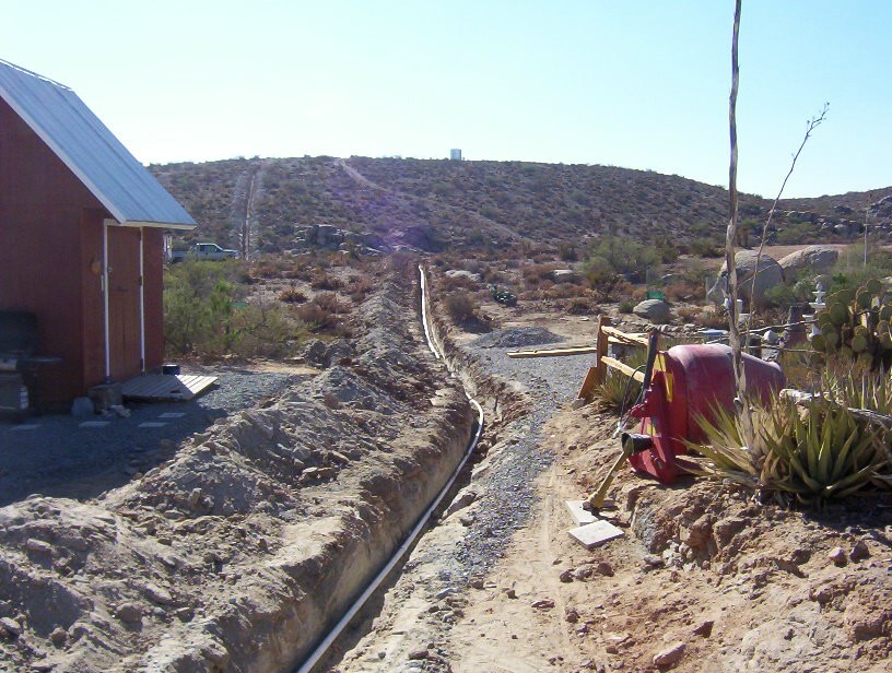

I back filled the bottom section so I can now get into my cabin. The feeder line is almost in, I have about 100ft left and I can start filling the tank, by the time the tanks full I should have the 2 inch line done.
The photo here shows risers from those I will run lateral lines to hose bibs.
