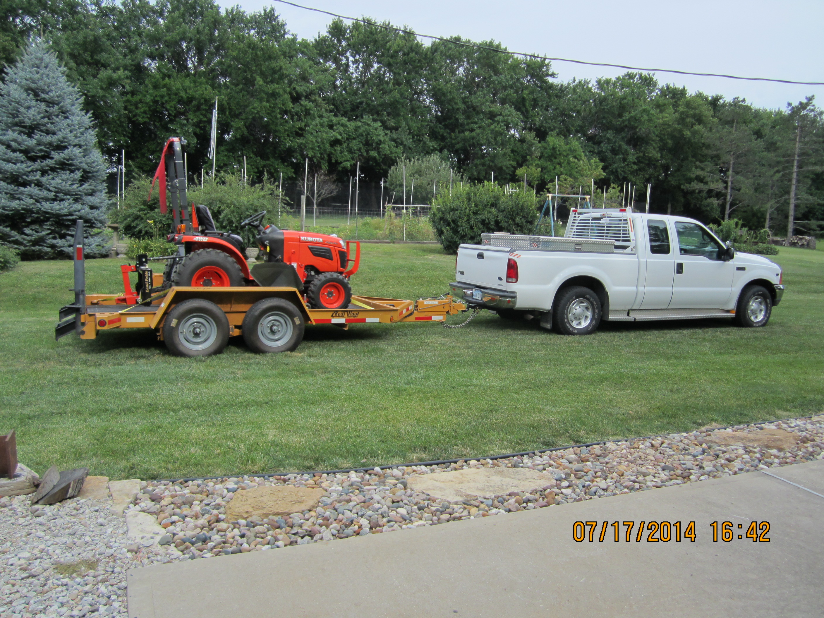

Not expert but here's some of my experience........I like sides on my trailer where i can add 2 x 12's so as to haul gravel, rock, dirt etc. Going to the quarry to pick up 3 tons of gravel makes the trailer much more useful. Then there are the times when my kids needed to move their furniture from place to place. It's real handy then. An, Oh yeah, I trailer my CUT around for mowing, tilling etc. 724.JPG
I wish that it is about 4 feet longer however.

Very nice trailer!!!
Thanks. It has worked great so far and tows like a dream. The price was right too at $3,400 for a 20' 10K trailer with spring assist ramps and spare tire with mount.
