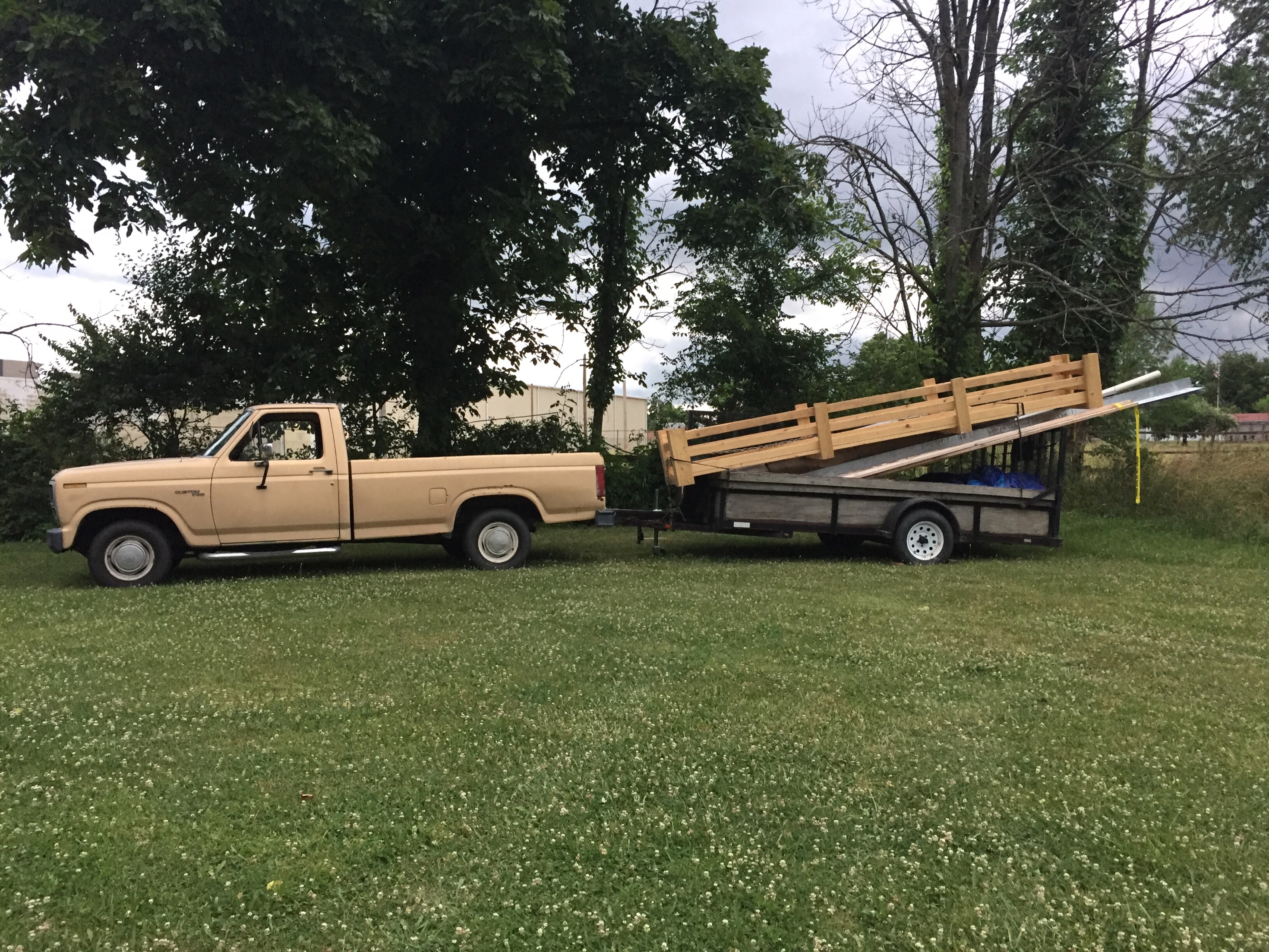

Flip up ramps are nice but you can't have anything extend past the rear of trailer. Sometimes this is needed to get the correct weight balance on the trailer.

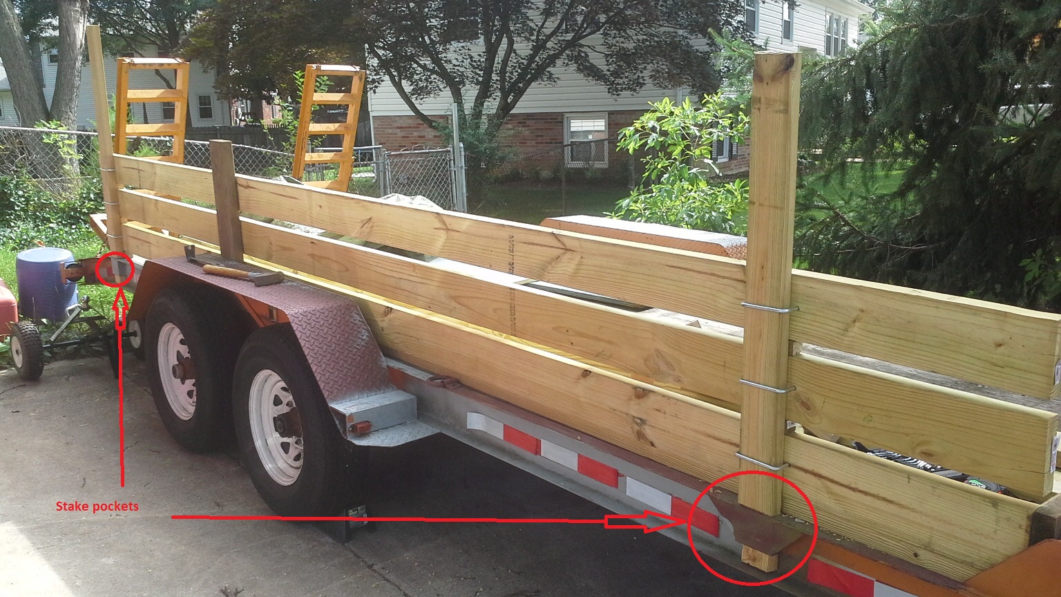

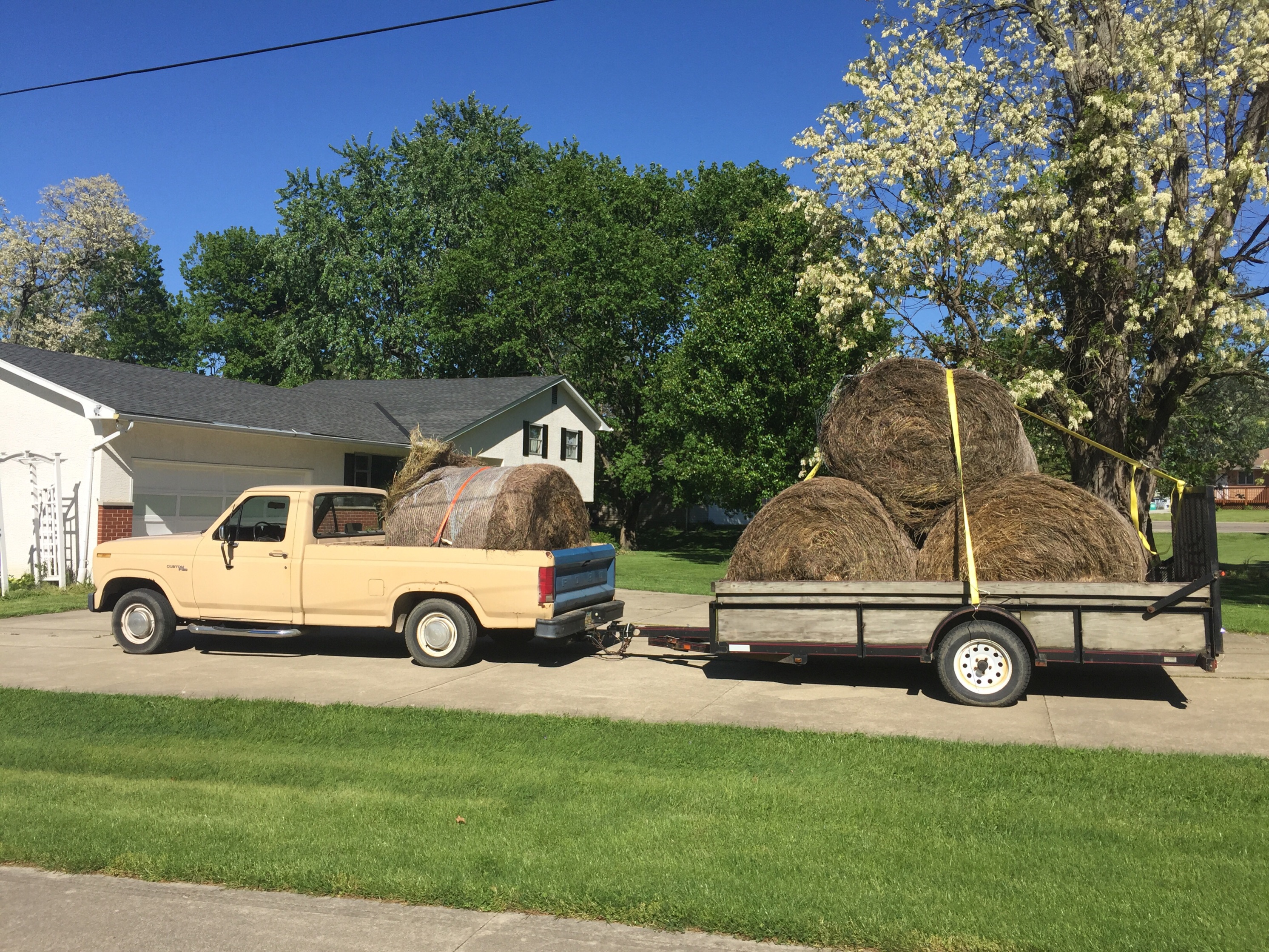

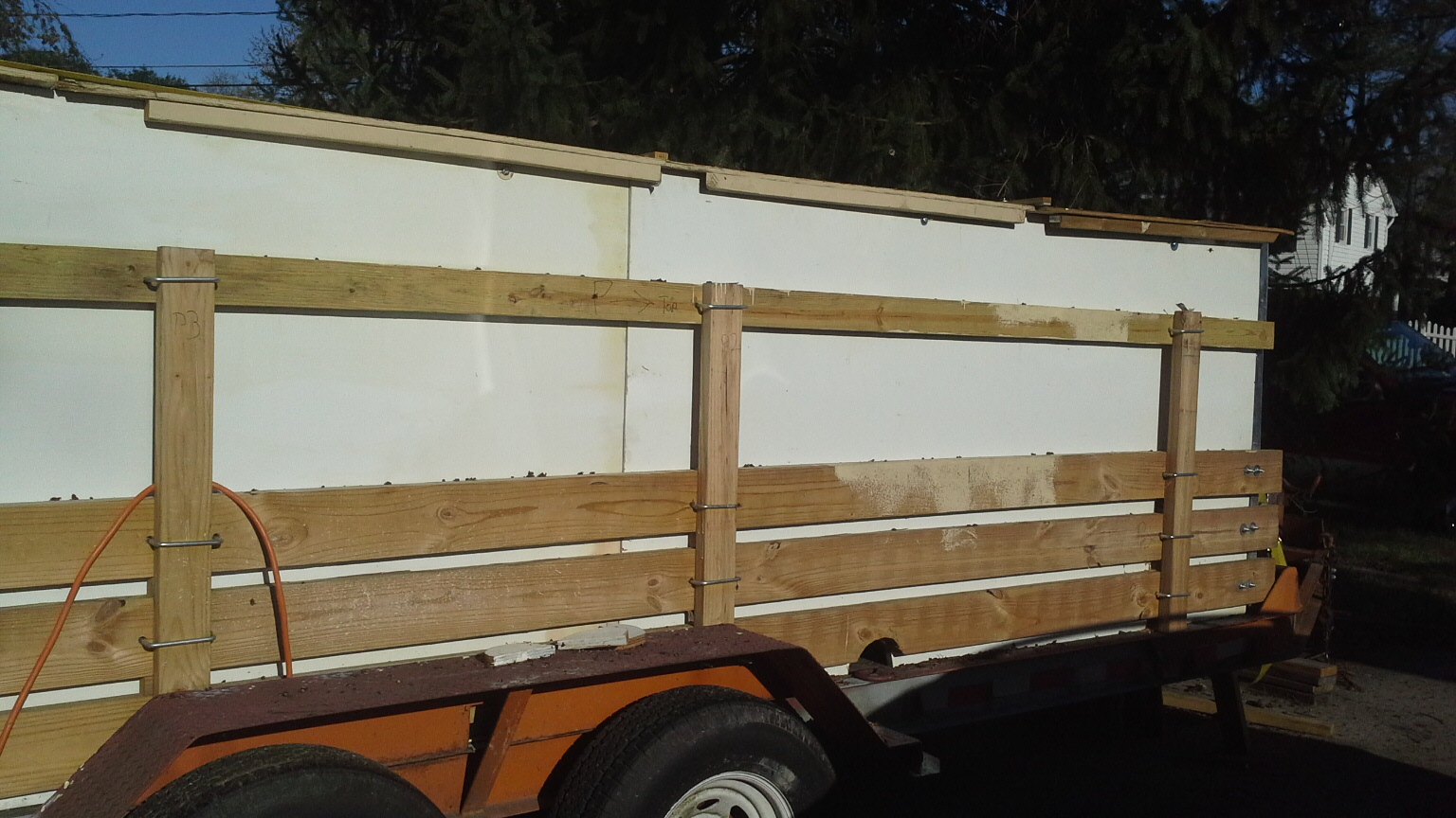

Not expert but here's some of my experience........I like sides on my trailer where i can add 2 x 12's so as to haul gravel, rock, dirt etc. Going to the quarry to pick up 3 tons of gravel makes the trailer much more useful. Then there are the times when my kids needed to move their furniture from place to place. It's real handy then. An, Oh yeah, I trailer my CUT around for mowing, tilling etc.View attachment 503985
I wish that it is about 4 feet longer however.
Cheers,
Mike
If you've got stake pockets sides are easy.
You could always pull the pins and take the ramps off and put them in the bed of the truck after loading.
