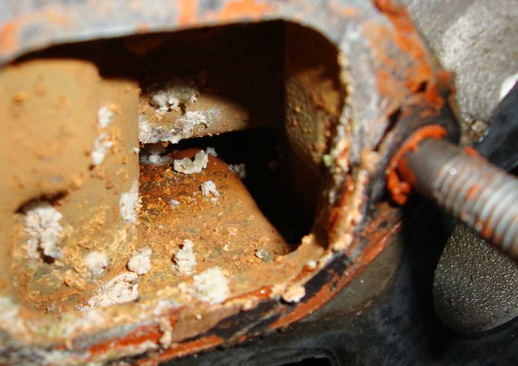

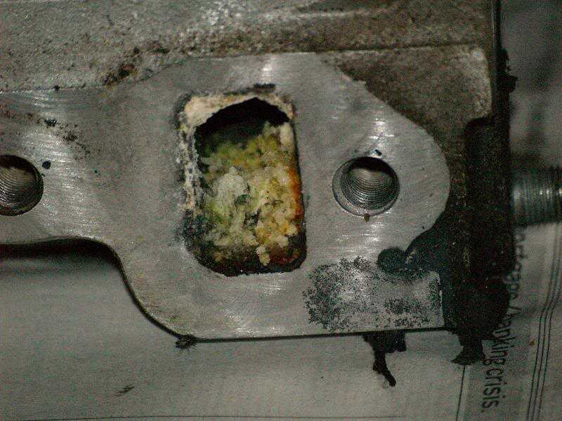

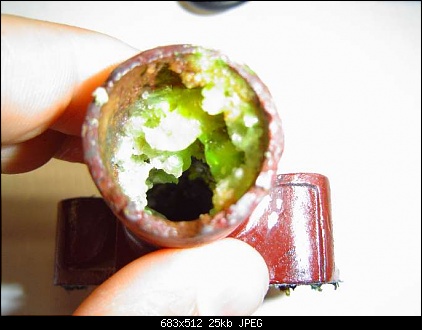

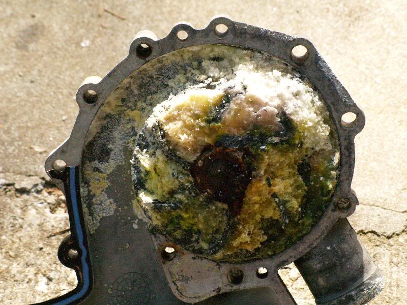

I am not a member and can not access pic. My deposits when dry look like wall joint compound and gritty, caukly
The Kubota dealer has never seen this type of coolant problem.
   / $1000 Coolant Change #42
man, a product that can cause that kind of damage if mixed with another similar product shouldnt even be allowed to be sold. it would be like mixing unleaded with supreme fuel would cause sludge to seize up your engine.
   / $1000 Coolant Change #43
That's weird. I can see them without a membership. In the posts the deposits almost look like spray foam.

HOAT mixed with OAT damage.
Glycol and OAT
   / $1000 Coolant Change #48
I see them too and I think you got it. I hope I'm wrong.
