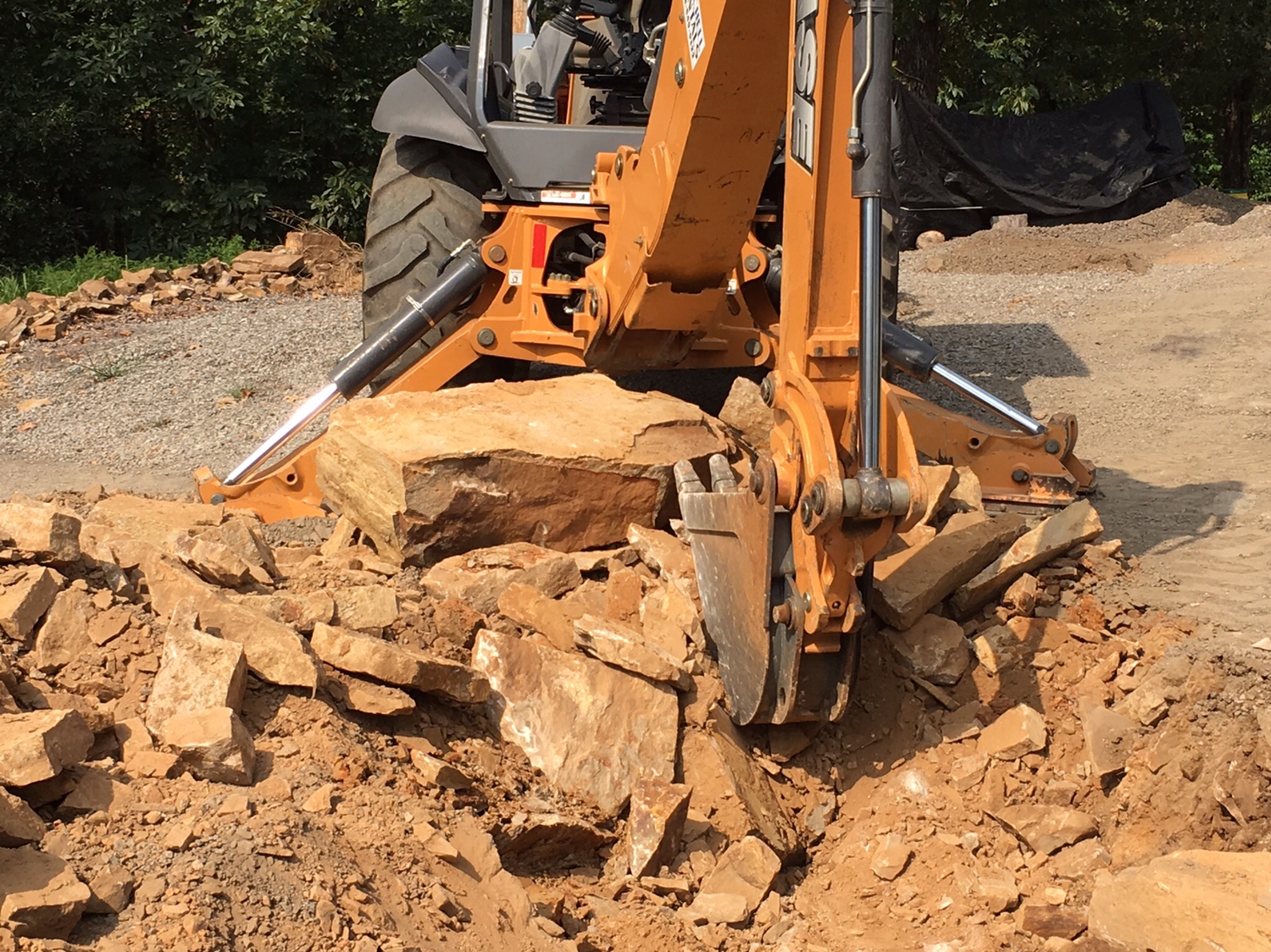

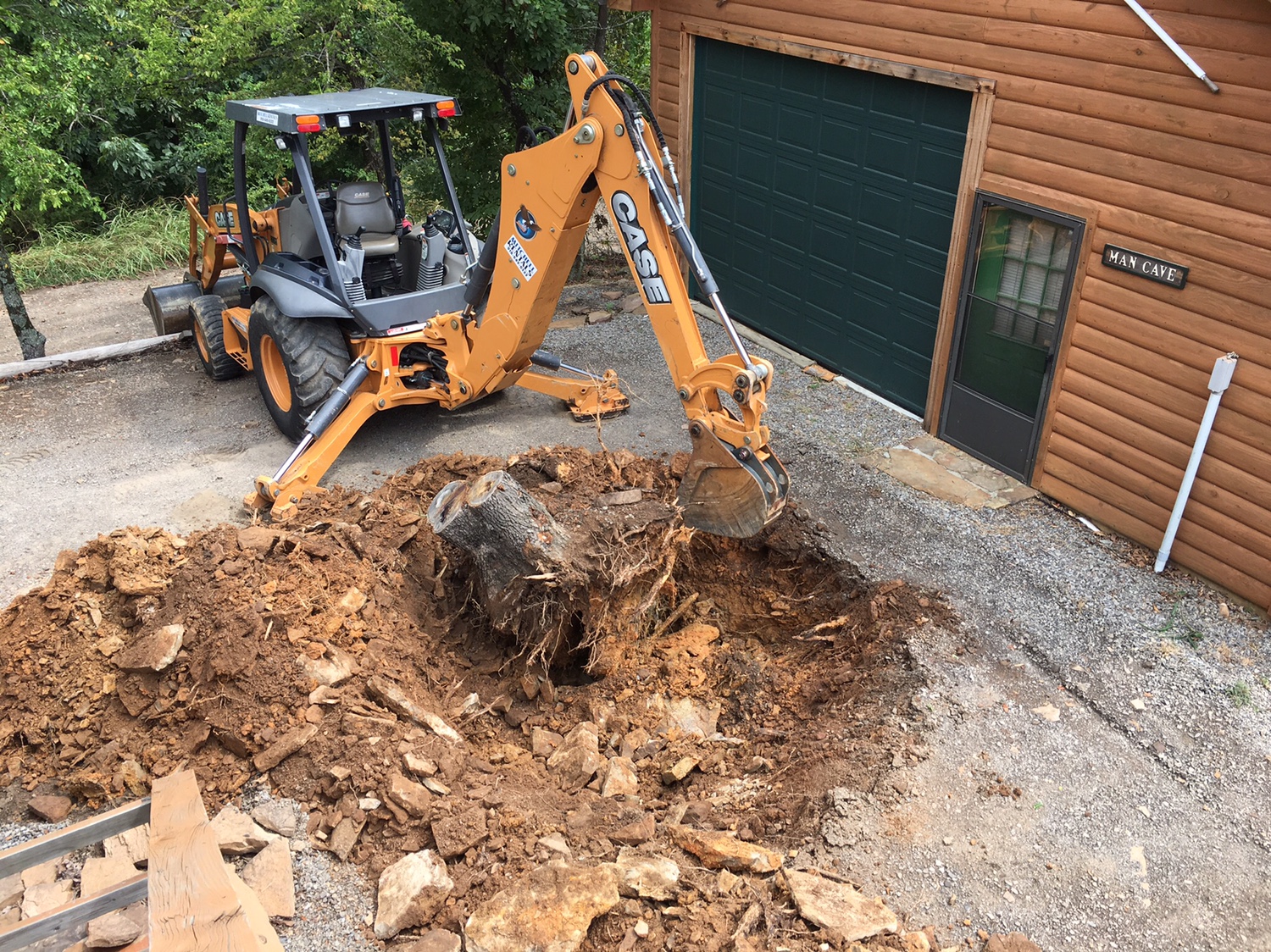

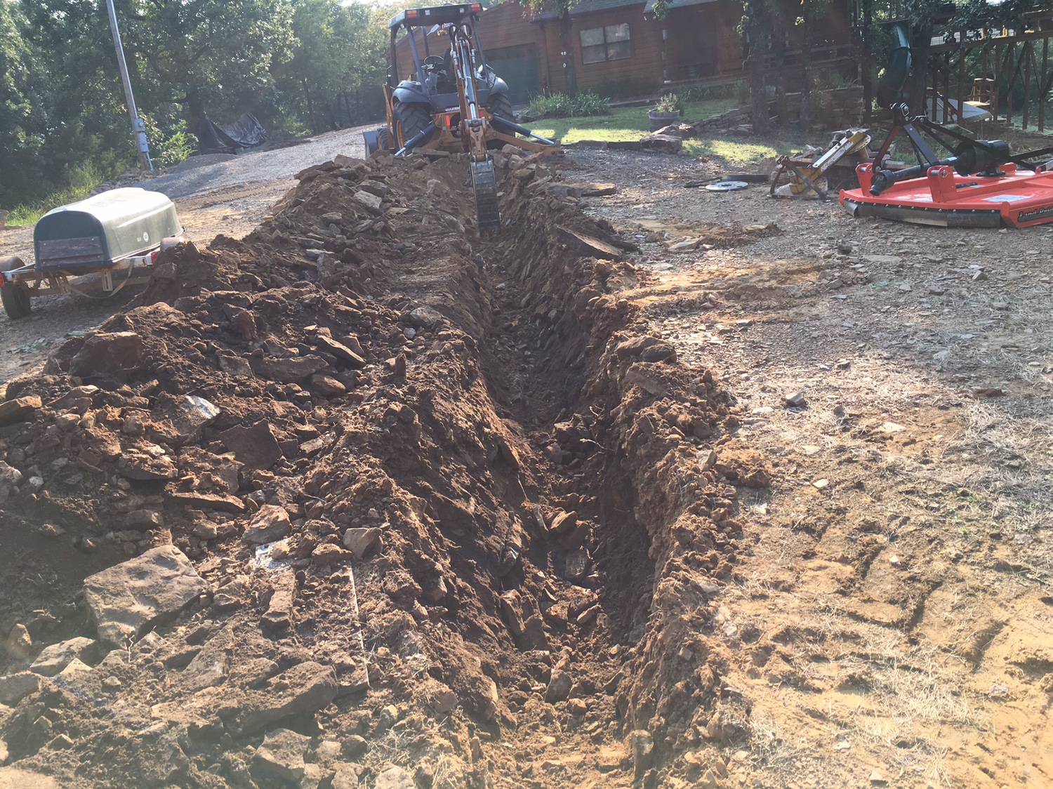

I rented a backhoe for mine and the company put a 12 inch bucket on for me.
It was surprising what the thing was bringing up!
Though I rented it for a week, most of the actual trenching was done in a day and a half. I dug out stumps with the remainder of the time.
