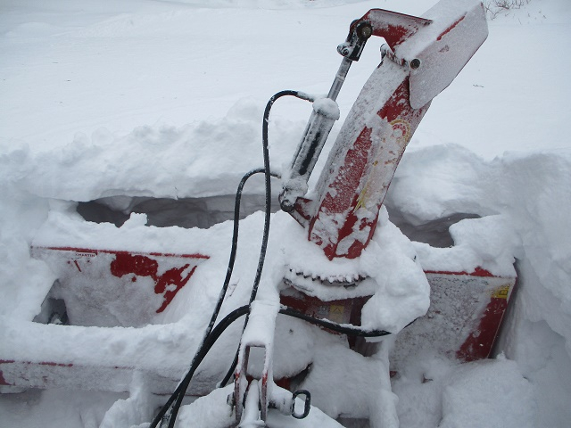

I'm in NS. You will be dealing with anything from 5cm flurries, 10-15cm light storm, 20-40cm winter storm or the odd 50,60 cm or more dump.
Snow can be fluff, or solid packed drifts or slush.
Rear mount 3pt PTO blower and front end loader with bucket (full hyd with down pressure!) is very versatile and most economical and will handle it all. Snow blower gets the snow away and into places you can't push. I do 99% of my snow removal with 3pt rear facing snow blower, all gravel driveways.
4wd makes it easier with the hill. good set of chains wouldn't hurt. I don't run chains and I handle slopes and hills with ag tires ok. I do lots road travel so chains don't work well for that.
If you have a low budget and you are starting your snow removal at top of the hill, an open station 2wd 6000-7000lb diff lock loaded tires with studded chains with loader and 3pt blower would work. Clearly something 4wd with cab is much nicer but also way more money.
No experience with truck plows, I just observe those get parked for driveway jobs in bad storms and once you run out of room to push you are done. Same goes with snow blade on a tractor. You get high banks or run out of room to push.
Quad or SXS would require plowing continuously during storm until you ran out of room to push snow. Basically a toy better than a shovel.
Front blowers are really nice but very pricy and often limit the tractor from doing anything else.
Photo is from one NS storm last winter. I wake up and clear snow. I don't plow multiple times, I do it once.
