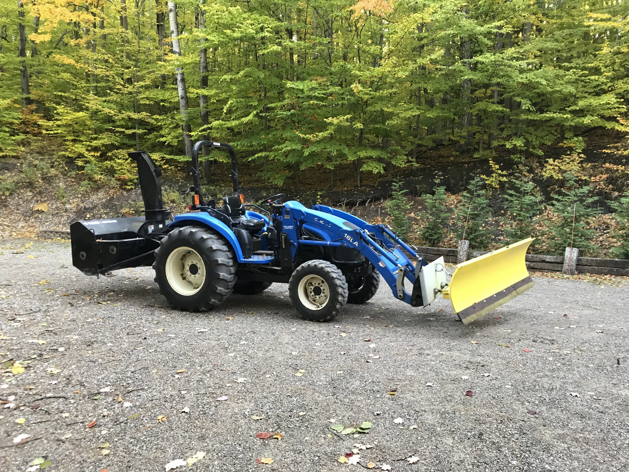

we live on a peninsula on the great lakes...tons of snow... 3/4 mile private gravel drive ..no problem with my setup...front blade on the FEL...rear mounted snowblower....camera so my neck doesnt hurt..
