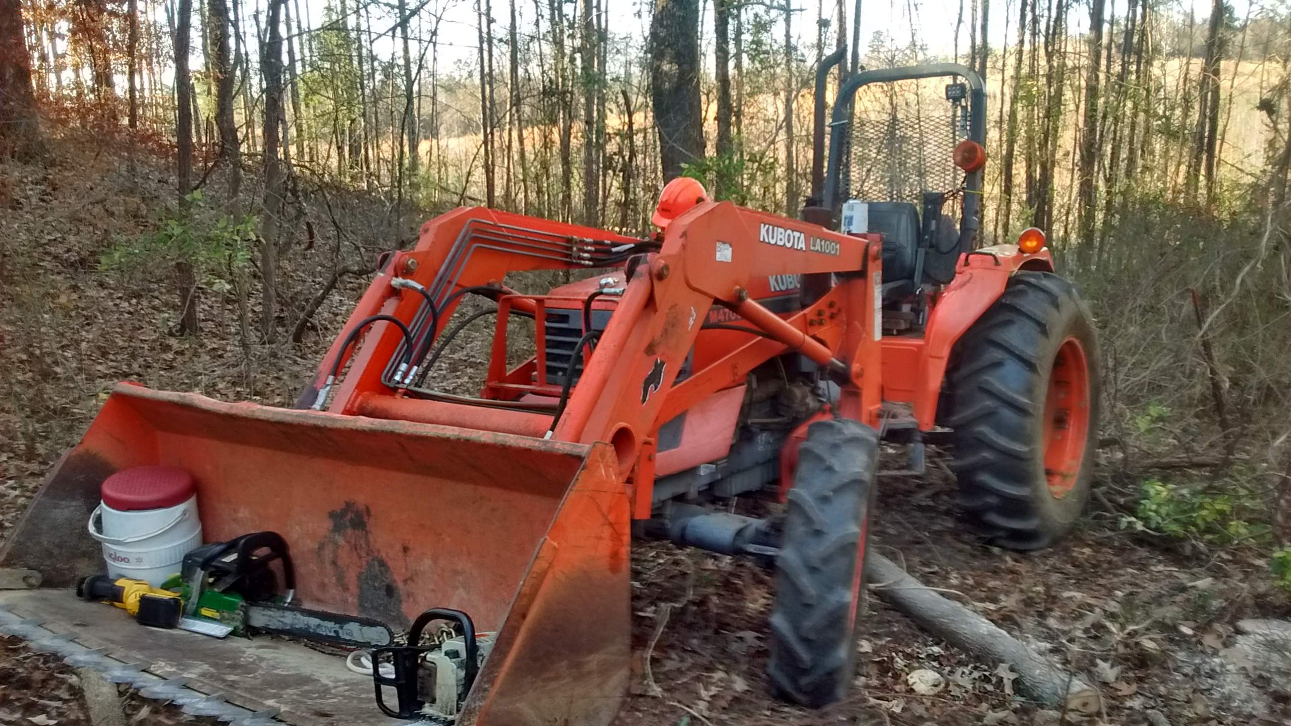

Might consider looking at "public auctions".
Right now there is an auction near me:
Auction #2152321 - Kubota M4700 4WD Tractor w/ Front Loading Bucket
I bought the same model yr tractor from the same place for $11,500 back in 2013.
attachment.php
I don't know about auctions down near you but it seems that one can get well maintained equipment from public auctions at times at bargain prices.
566575d1534176461-10k-budget-12-acres-mixed-img_20151207_150524186_hdr-jpg
In Ohio public equipment auctions have well used expensive equipment. Typically several thousand more than similar equipment at farm auction
