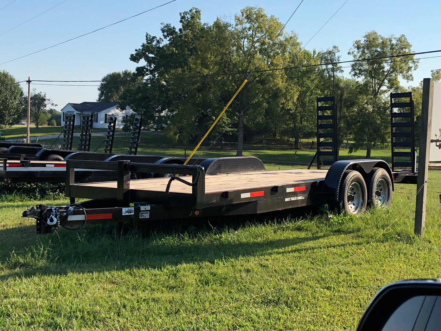

I am looking for a 20? 10K trailer. It will be hooked up to my 08 Tundra that is able to tow 10,400 lbs. I have a brake controller and am looking into a WD hitch. It will be used to haul my tractor, other farm equipment, and hay.
I have it narrowed down to a gator 10K that I can get through my local dealer for $3,700, or an off brand trailer from Direct Trailer Source. The trailer from DTS is also 10K and costs $3,250. The biggest difference I can find so far is that the gator is powder coated, and of course the name brand. I don稚 plan on selling the trailer any time soon, but having the gator name definitely gives me a little peace of mind in case I do sell it. The gator does have a bit of a lip around the side, which I知 not crazy about. The trailer from DTS is flat with no lip.
I知 not opposed to other trailer brands, but I don稚 have many other brands at dealers around me. I知 not opposed to driving to look at one if someone has a favorite.
Btw, here is a pic of a 14K from DTS. View attachment 573824

Well, we went and looked at the Gator trailers and the Direct Trailer Source trailers again. After climbing under both of them and doing a thorough inspection, we looked at the Gator 14K. It has the upgraded 16" 10 ply tires, cross members 16" on center (DTS has them 24" on center), upgraded jack, upgraded lights, spring assist ramps with DOT tape on the back and sides, and no lip around the edge. The dealer priced it at $4900 and then said he would take $4800 out the door.
After some discussion, I'm going back this week to negotiate with the guy and buy the 14k Gator. It's worth the extra $$$ for the upgraded frame, axles, tires, lights, ramps, powder coat, and no lip. I will post pictures once I tow it home!
