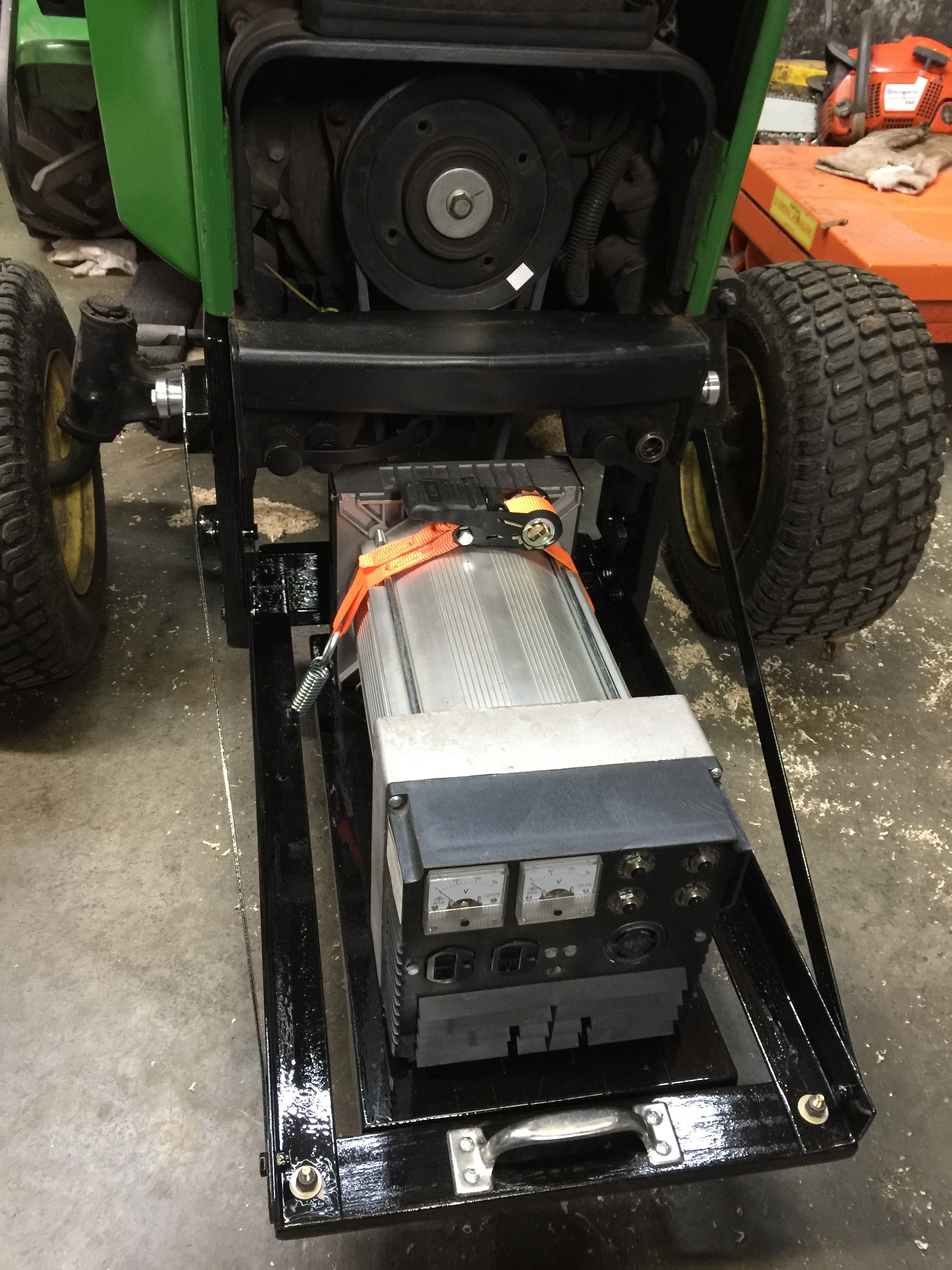

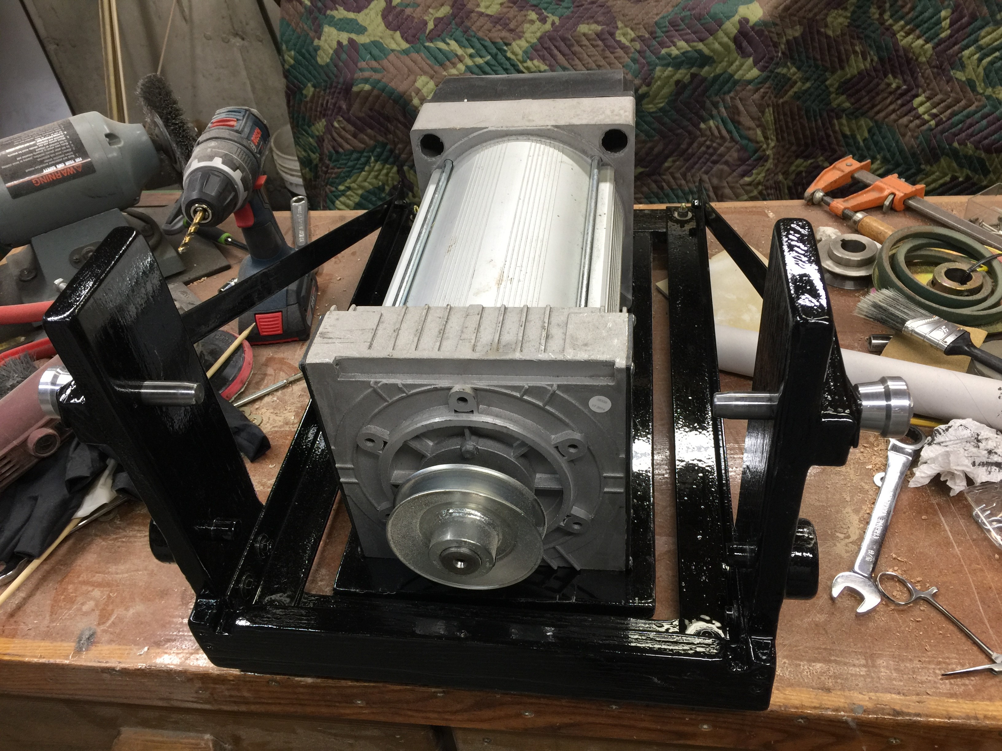

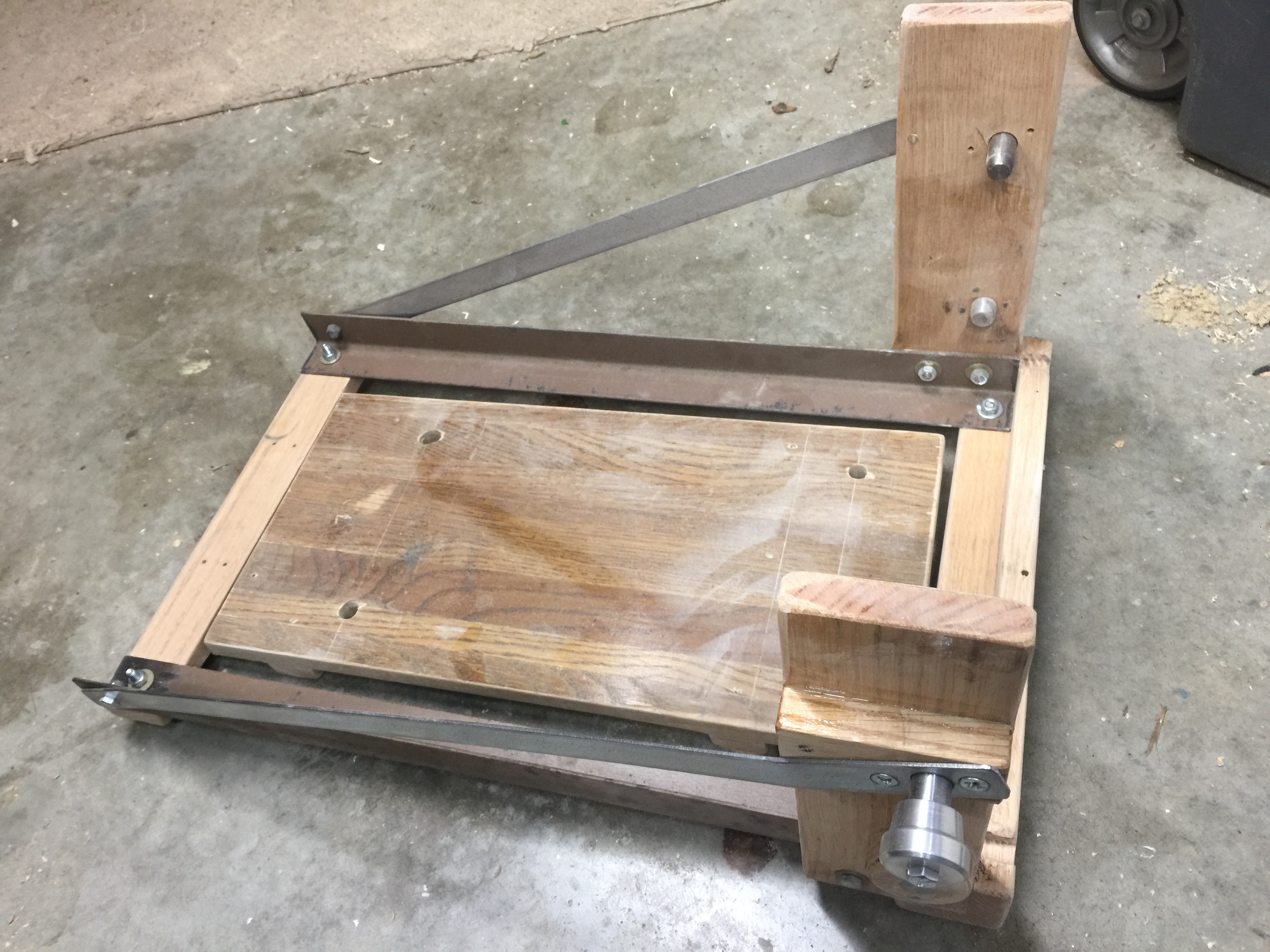

Appreciate the input from everybody! Tractor Seebee has hit on what I have already done. The generator head is bolted to a wood base that is hinged on one end. The pulley end is then hanging on the belt. Up to now, the belt tension has been limited to the weight of the generator head (about 45 pounds). While testing, if I want more tension, I just put my foot on the generator.
I gave it some thought this weekend and here's the first approach I will try. I'll use the KISS approach. If I add a couple eye-bolts to the side rails, then I can simply take a ratchet-strap and run it from one bolt, over the top of the generator and down to the other bolt. I'll also add a spring in the middle there to add some compliance to the tension. I have it apart right now since I'm preparing to paint. Once I have it painted and back together, I'll post some pics.

The final details on this generator mount have been completed, using two coats of black POR-15 paint and adding the belt tensioner. The first pic shows the mount just before painting. Once the black paint is on, it's hard to see the detail of how it's built. Using a ratchet strap with springs for belt tension works perfectly and is super easy to adjust. Simple and sweet.
