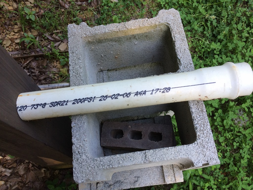

Please put down your pitchfork and look at the picture again, it does say DWV, but it also says 280PSI.
I suspect that it is schedule 40 or 80 pipe that is also DWV rated.

I only have a small section left with partial markings. All I can tell for sure is 200psi. Looks like "SDR21".
p.s. yeah, here it is - Cresline Plastic Pipe Company

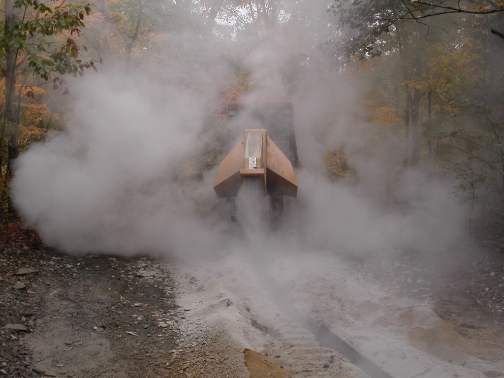

Just as a blatant thread hijack, the rocksaw was one awesome (and expensive) piece of machinery.
Aaron Z
Correct. That pipe can be used for multiple applications. pressure, waste, vent, or waste. The way it is here. If the pipe isn't labeled for it's use, inspectors won't allow you to use it. With this pipe stamped this way, I can carry one type of pipe for draining condensate, water drain (waste), or as water line repair.
If I were going to replace it all. I would use pex over anything else.
