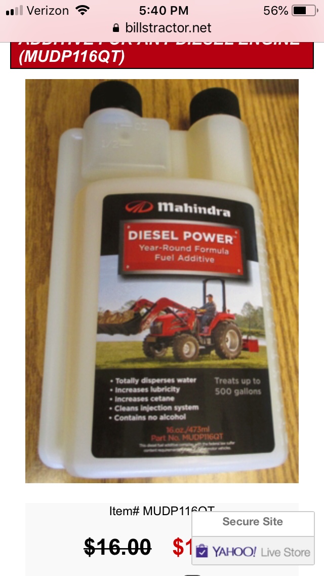

I use this fuel additive and haven’t had any issues...
   / 110 hrs max 25 - dies after start
#23
thanks - is this antigel too?
have to check - i tried some yellow/gold stuff from tractor supply - do not remember the name but when cold my stuff freezes. when i really need it - in case of serious snao which is rare but have had - it is useless. and some magnetic heater put on the 2nd year i had it but when i tried to use t last year or 2 years ago never worked.

I’m not sure if it’s an anti gel or not ..
