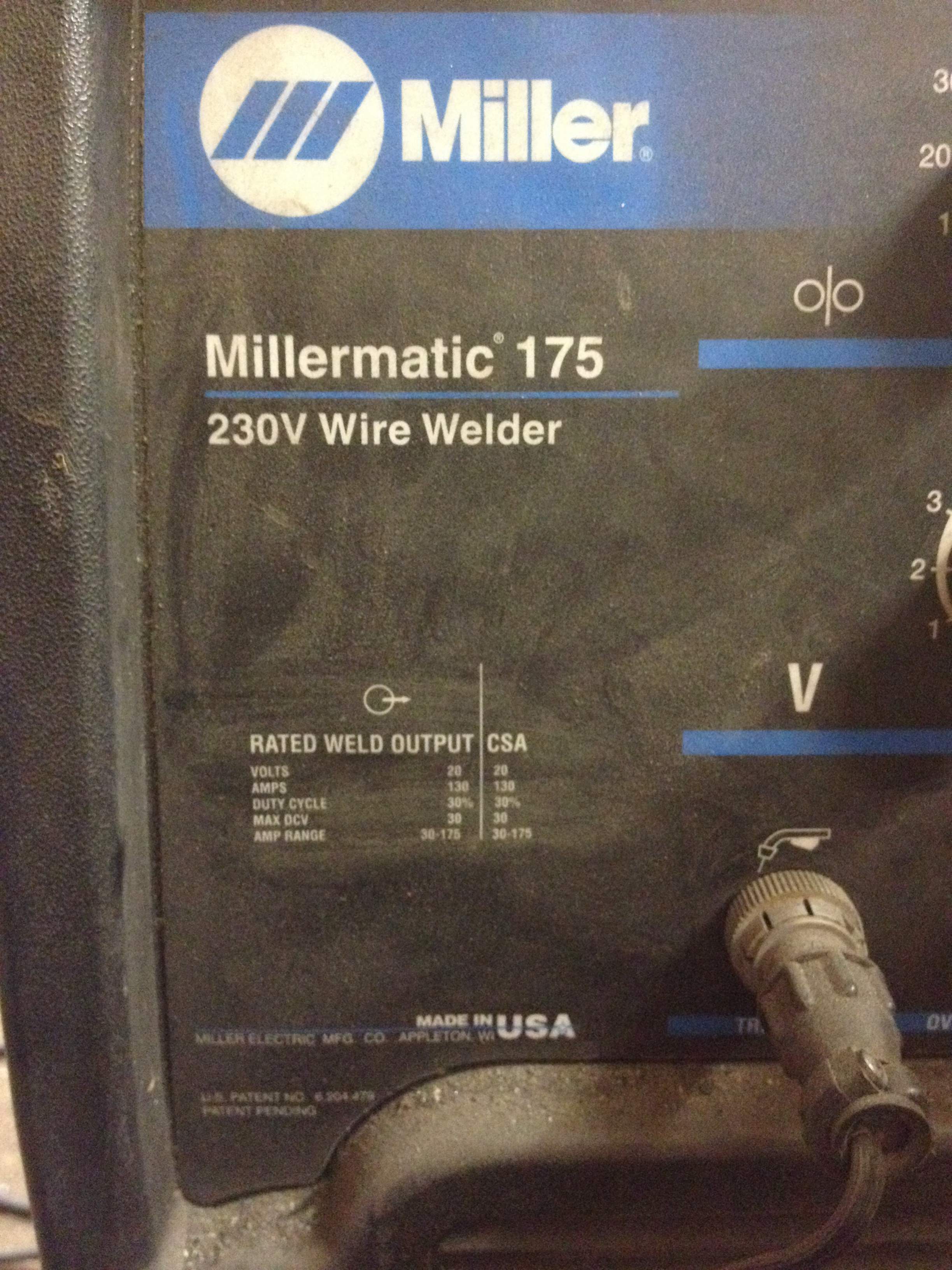

I think the results worked out perfectly and at least I don't have any doubts as to their capability after looking at the results. It worked out perfectly for everyone because the results were mixed. It passed the bend test which is a huge accomplishment and did alright in the hammer test but also showed signs of lacking penetration and the etching confirmed this.
In the end we know that these type welders are not to be used for critical welds thicker than 3/16 per CEP/Shield Arc's recommendation with some common sense they still have many applications. That is why they are one of if not the the most popular welder segments in terms of sales #'s. But I think in the end we all knew that nobody was suggesting using it for a critical/life threatening welds on thick material or for example building a heavy duty trailer.
To be honest I was impressed with how much time CEP spent and was impressed that he passed the bend test but the most surprising thing I learned from this testing was how weak so many of the 230v mig welders are, my Miller included included. Many of those machines have a rated output that is barely better than this Everlast 140. I have a Miller 175 and it has less rated output compared to the Everlast. I'm going to line them up and compare side by side before I pass judgement. But I will say if the loser is blue it's going on e-bay and I will be getting something larger.

Road, I think if you look again at the specs, you will see the miller 90amp@20v 20% duty cycle is with a 20amp imput. At 30Amp imput, I suspect better numbers. I looked for those numbers on the everlast, but it wasnt in the specs. Maybe if you ever get your machine back from Shield, you can fill in that blank for us. Right now i dont know if we are comparing apple to apple or apples to oranges.
Just for info, I have the blue 175 also, but I already knew i wanted a bigger machine, its just that now I am starting to understand why.
