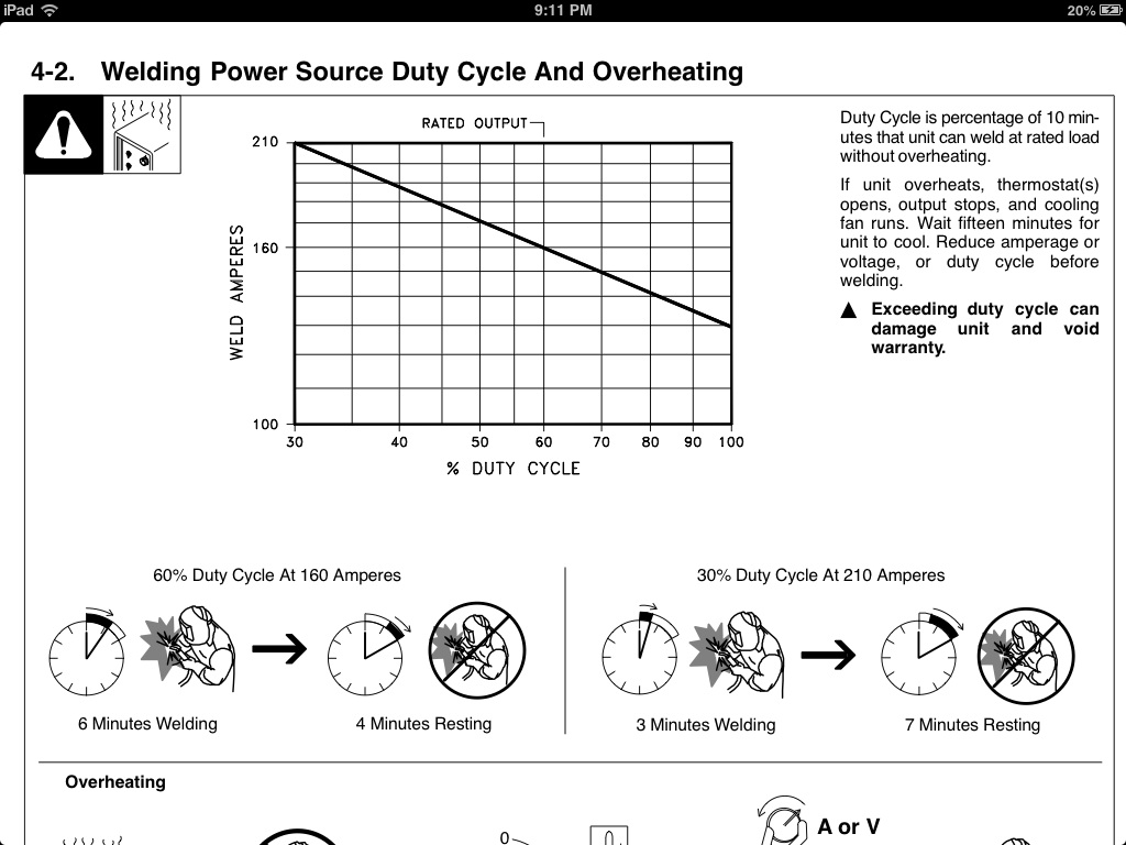

When upgrading to a larger unit (I still have a little one too) I'm a fan of the full size models since they usually have a better duty cycle.
My millermatic 210 is 30% at 210 and 60% at 160 amps.
It's the mid range I look at for high duty cycle since that's where I will normally weld at.

   / 110v welder and the 3/8 bend test #34
More amp input does not affect duty cycle. We publish the specs and the amp input values at the max output.
Well, that's what I was thinking.... plug it into a 15 amp outlet or a 30 amp outlet. If you aren't pulling more than 15 amps, you should see no difference at all, correct? Only if you exceed the draw of the outlet will it trip the breaker, or run the machine longer than its duty cycle for the power you are using will it shut down the machine, correct?
   / 110v welder and the 3/8 bend test #40
Mark, I guess the machines are designed to shut down when they get too hot, duty cycle, but My question now is, if input amps doesnt effect performance, then why all the hooplah about wireing in 30amp breakers to get more out of the machine. If I am on the right track here, ( AND I MIGHT NOT BE SO FEEL FREE TO CORRECT ME),Most migs are Constant Voltage (CV) machines, therefore volts at the gun remain mostly constant and wire speed determines the amps or heat put into the weld. More speed of the wire= more amps. Amps are also effected by wire size and by arc lenght. My thoughts are more amps available at the breaker allows more available amps at the gun. A bigger breaker doesnt effect Voltage input to machine, only amp input, but it takes volts to push the amps and the maximum amps available at the gun is limited to how many amps can be pushed by the available voltage. I have 127v at my breaker box, does that mean I can expect more performance out of a 120v mig than someone using the same machine but with only 120v at the breakerbox? Everything else being equal.
Volts x Amps=Watts. Mig welders are DC volts not AC. The formula to convert ac to dc is AC = DC / 0.636 The everlast machine is rated at 135amps@21V. This would be 2835 watts. The miller is 90amp@20v=1800watts. At 230v input is 23.5V @ 150amps=3525W. At 20v@150amp=3000W. It is evident the Everlast machine should outperform the miller at 120v, but is equally evident that at 230v, the miller can out weld the 120v machine. I havent done the math on any other dual voltage machines, but I expect similar results. With that in mind, it would seem silly to me to purchase a dual voltage machine if you only plan to run it on 120v, but it is also silly to me to expect a 120v machine to compare to a 230v machine when it comes to the amount of heat that can be applied to a weld. Both machines are converting AC to DC, power in power out. I dont know how it works, but it seems to me that somewhere in the ac/dc conversion, the dual voltage machines are loosing a ton of power, possibly only pulling off one leg of the available 230 power supply???, Or extra power is being converted to heat in the ac/dc power conversion, resulting in lower duty cycles.
