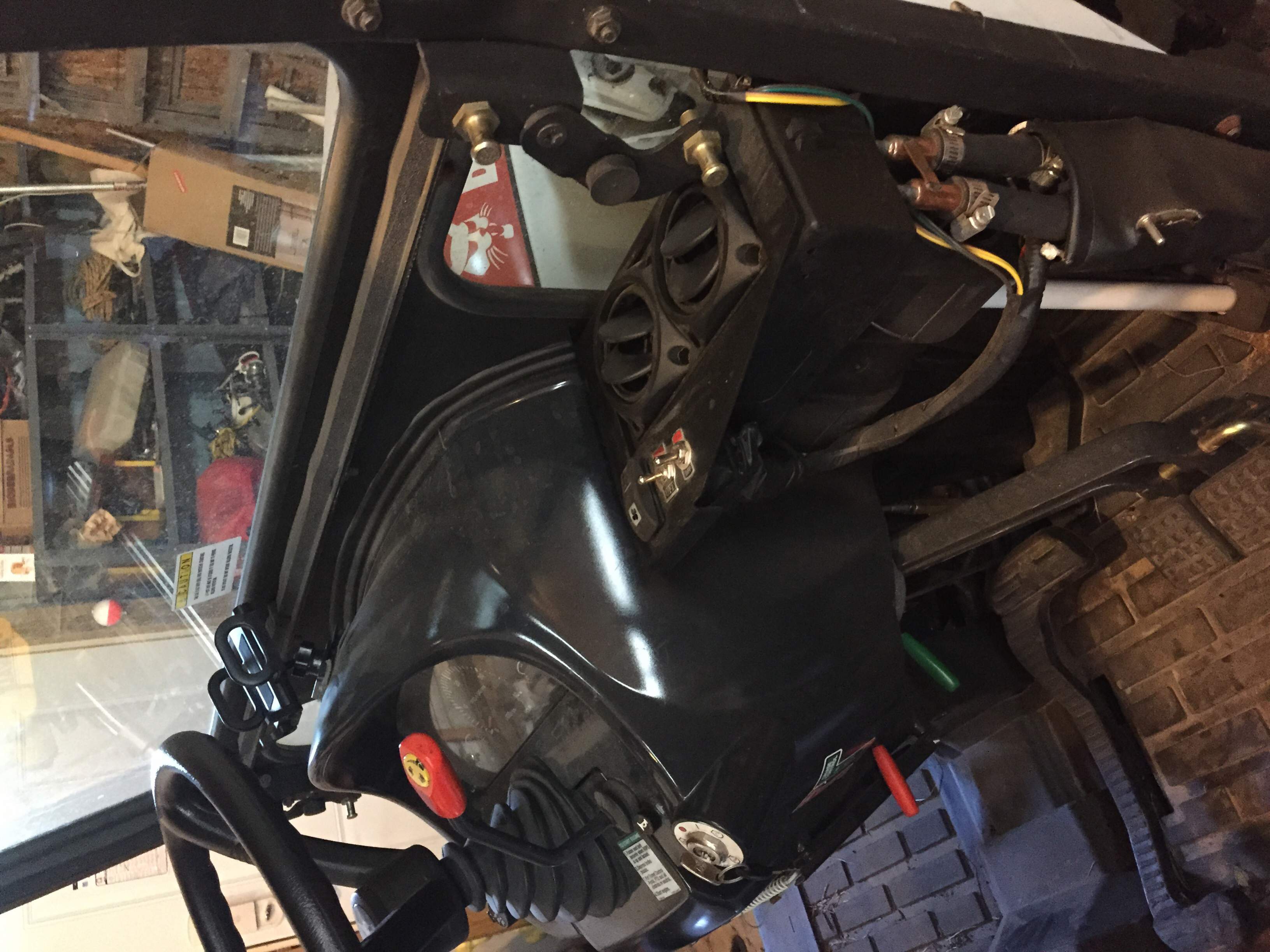

Hi all as the Summer is almost 1/2 over I am starting to think about heater for my CK30 tractor cab. Anyone know of a good makes of 12 volt heater that will work great in my cab. I don't want to be overly hot just enough to keep the window from fogging up. I saw one 300 watts on the net but so much bias against it so I will wait to hear from you guys. Also where is the best location to mount this heater inside the cab. My cab is a soft one. Thanks

I have tried both of those electric heaters that you are considering and my cab seals up very well. Don't waste your time for your money. It will help keep the window defrosted if it is shooting directly along it but that's about it. I added be heater made by cozy cab that hooks to the tractor cooling system and that thing is amazing plus it is a very powerful fan that I use to keep cool in the summer.
One thing I used to do before I had a heater was put 110 V Space heater inside the tractor with an extension cord run to it for about five or 10 minutes before I wanted to use it. That helped take the chill off as long as I didn't have to run the tractor too long. But I am very very happy with my heater now I can go all day. Most times I have to cycle it on and off because it will get too warm.
