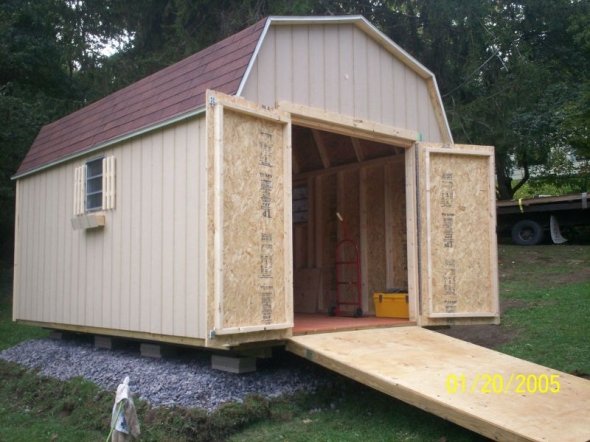

We just had built a 12 x 16 Gambrel shed with loft.
16 blocks laid out equally.
4 4 x 4 runners
2 x 6 joist 12 ft
2 x 6 16 ft sides
3/4 pt plywood.
Rest of the shed is standard.
Looks something like this.

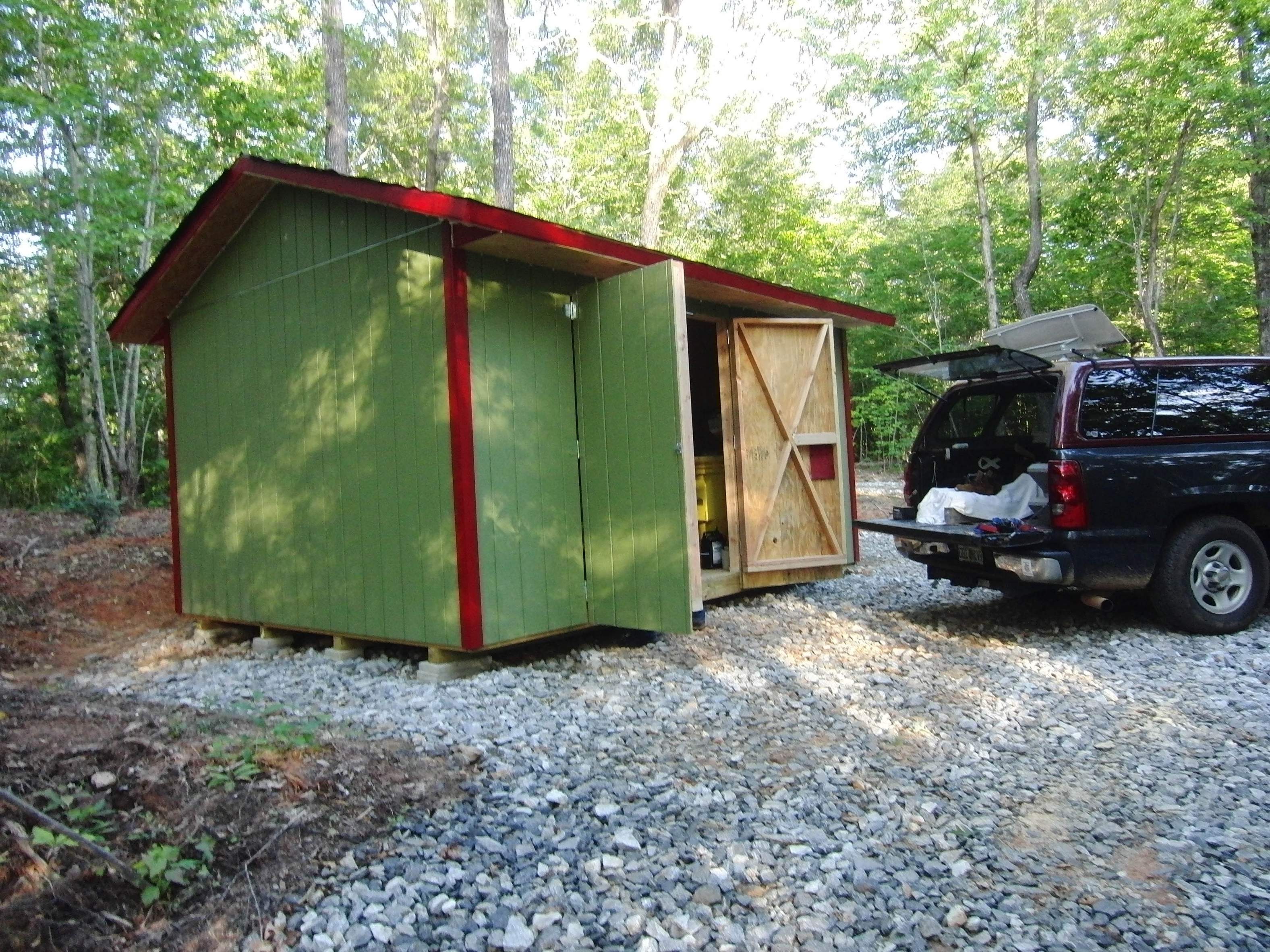

I built similar a couple of years ago. I built floor in two sections. then I built wall sections and trusses all in Florida and transported to N. Georgia and assembled on a weekend with 3 helpers.shed.jpg

To get around codes here they are just built on 4x4 runners. I have one on a gravel base that hasn't moved in 10 years.
This is probably the easiest way to do it.

Most sheds are made to be placed above the ground and float on the ground, once you put in any kind of footings, it becomes a permanent structure. some people will level a gravel under the shed.
For mine I just placed blocks on the ground, so the tops were level with each other, and used PT 4x4's as runners across the blocks, then I built the shed on top. Has held up well in 17 yrs.
