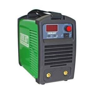

Is it a critical application? One bracket? Hire it out.
Or buy one of these fancy new fangled dual voltage STICK welders.
