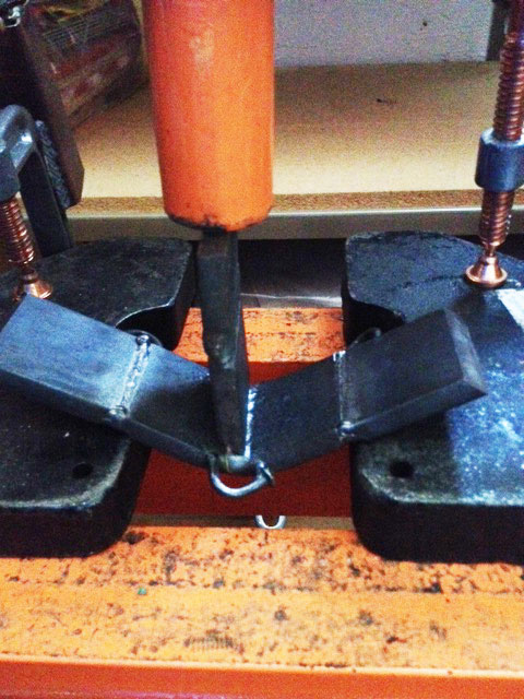

Anyway, by tricks I am referring to normal processes that the maintenance/hobbyist welder may be unaware of. For example bevel, multipass (maybe even preheat if no welders on TBN can do it without). Or heard of but haven't seen it done, and haven't seen it tested. And WANT to see it discussed, performed, tested.
The challenge is to weld thicker material than is normal for a 120v machine. Who cares if the "proper" machine can do it? Of course it can, that's not news and its not a challenge. Getting a 120v MIG'd 3/8" test plate to pass a bend test, is a worthy challenge that many people will learn from. If that's not great forum fodder then what is?
It can be done, it's just a matter of who has the time to take it all the way. Agreed it takes time, but I bet it takes less time to weld it than has been spent typing. Preparing the plate and bending it per AWS probably adds a lot though.

FANTASTIC! Sodo is going to take some time off from typing to try the bend test on 3/8" plate for us. :cool2: How it's bent isn't very critical as a weld should be stronger than the base metal anyway. ER70S-6 wire has significantly more tensile strength than mild steel to begin with, around double. Bend it around a 1"-1 1/2" round bar will work just fine. We eagerly await the results.:thumbsup:

Cool. 1-1.5" round bar sounds like a gentle bend compared to the 45deg knife edge I bent it with before.:thumbsup: Plus I've learned a few more details in the last few weeks (I think). But my welder is in one shop and the press is in a different shop 135 miles away. And I'll have to build a bending jig too (with 120v). I'll copy Bukitcase if I can figger out where he gets that polished flatbar.
You fellas stand back when you look at that pic, don't want anybody to get hurt!
391724d1411537702-120v-mig-3-8-coupon-3_8thk-7bend-jpg
I'm outta town for the next week maybe can 'keyboard weld' whenever I find a little wifi. I'll weld and bend again when I can find the time but if you fellas want to see it per AWS you gotta do it that way, thats a little beyond the hobby/maintenance guy. I'd get some part wrong and then the weld and the test will be a "fail" (to some).
