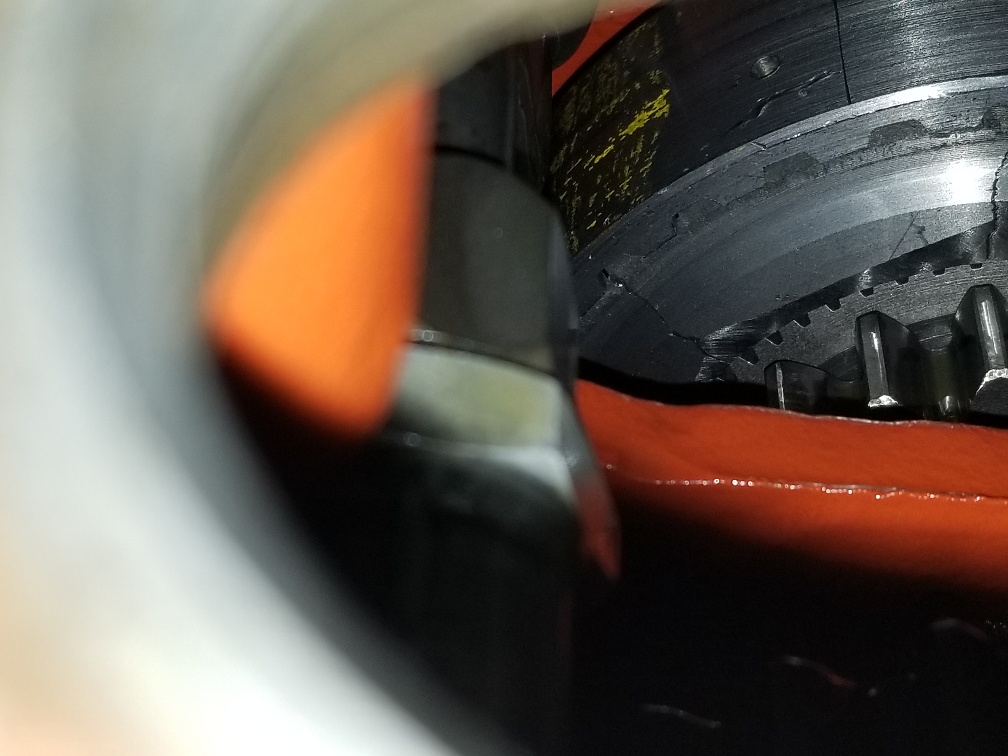

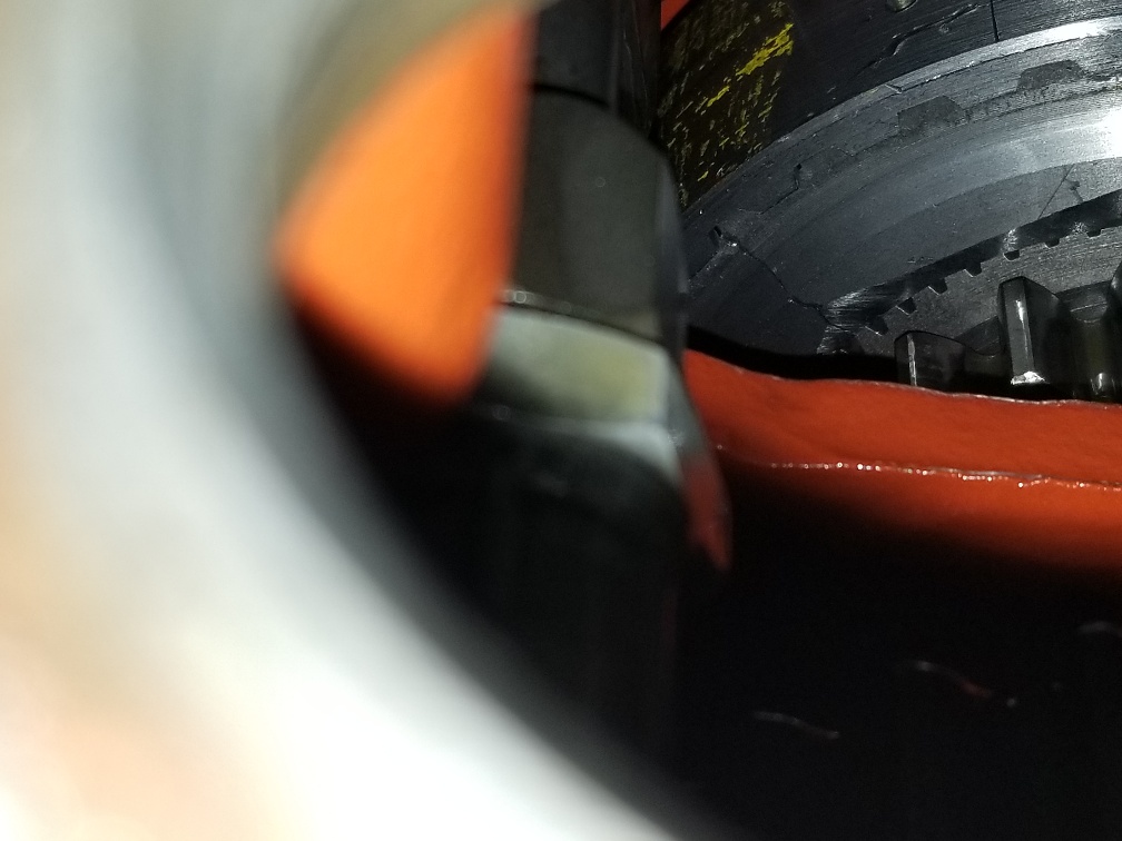

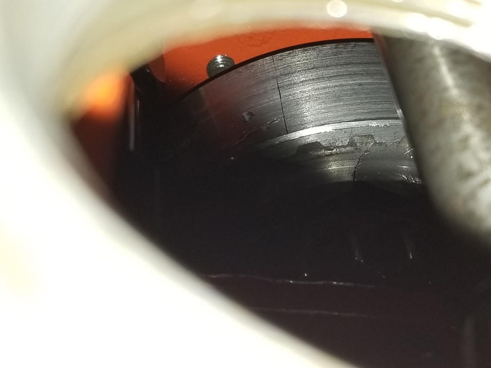

Hey ya still :( Check this out. I found these marks / cracks with a Borescope. This is looking forward from the fill hole. This has to do with the Multipower I think?
View attachment 550426View attachment 550427View attachment 550428
The multipower is toast. It's a heck of a job and finding parts can be tricky. Double check that the smaller pump on your scotch yoke pump is in good shape too. You will need to remove the lift cover and possibly your PTO shaft as well.
