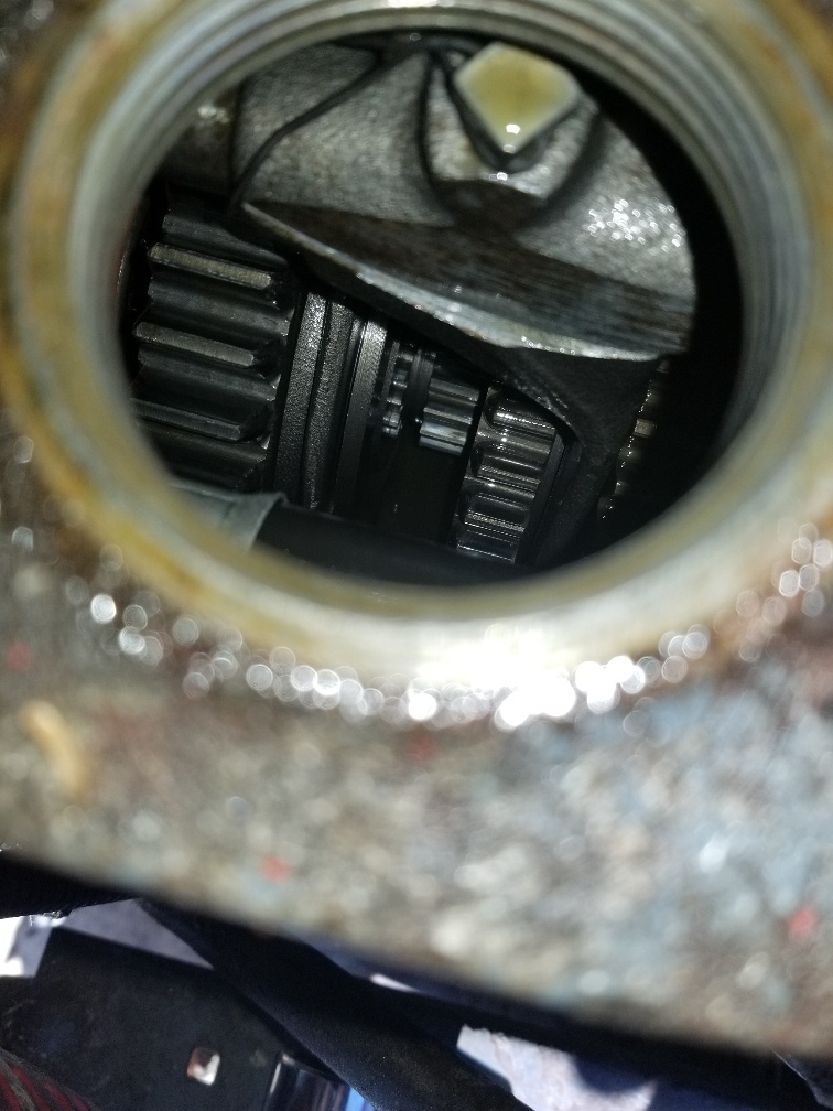

Ok Which one is the gearbox filler hole? I just tried again and as soon as you feel some resistance in the clutch i can turn the engine over. In the top 1/3rd of travel i'd say. That and the fact that i was able to roll the tractor with my trucks help tells me its not stuck in a gear. I think?
I think you locked it in gear AND sheer the sheersleeve that connect the box to the diff ?
   / 135 Locked up on startup!
#14
I wouldn't be able to roll it if it was locked in gear though right? I took this pic through the hole. It appears to move between gears ok. This pic is neutral.
#16
Yes for the left rail!
And the big gear ?
The one on the left of the pic? It moves back and forth with the lever. And i'm in Belleville, Ontario Canada.

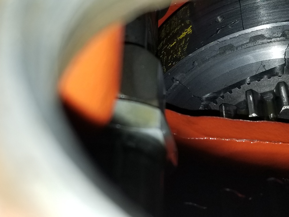

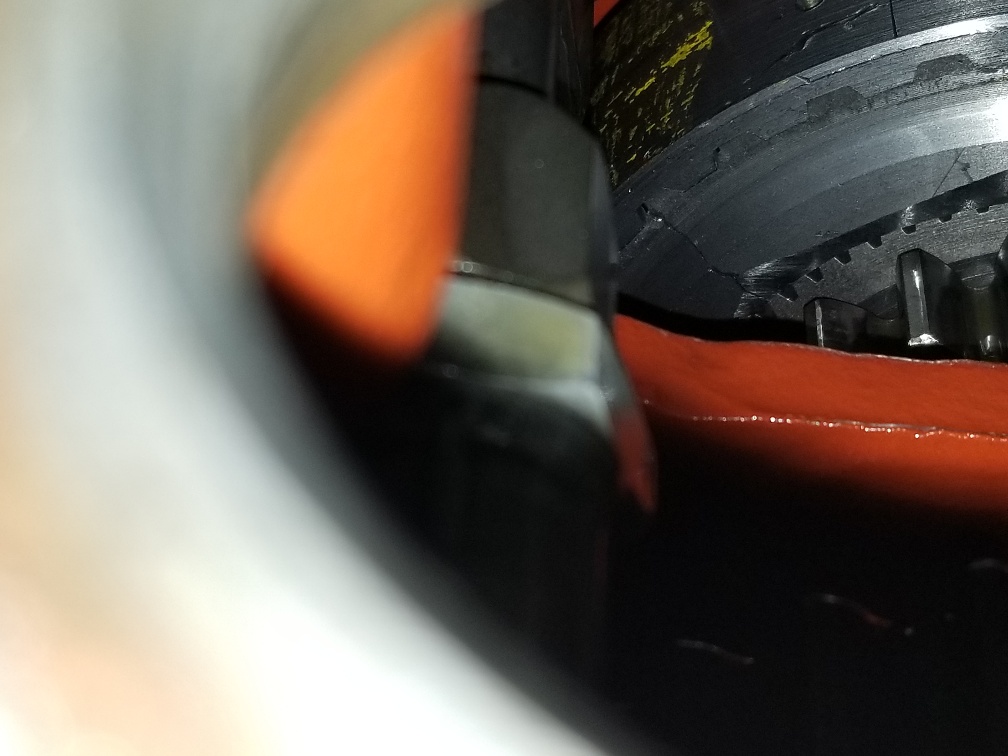

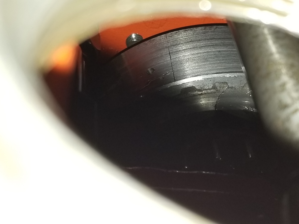

Hey ya still :( Check this out. I found these marks / cracks with a Borescope. This is looking forward from the fill hole. This has to do with the Multipower I think?
