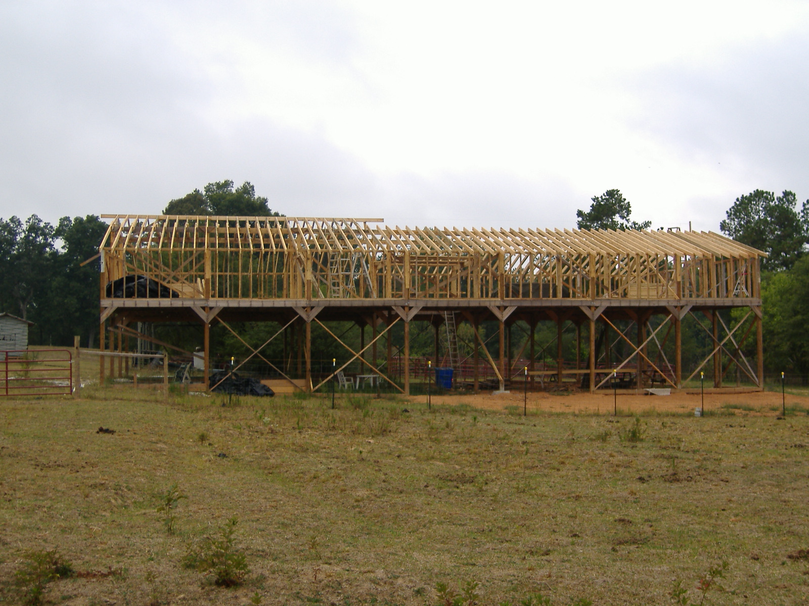

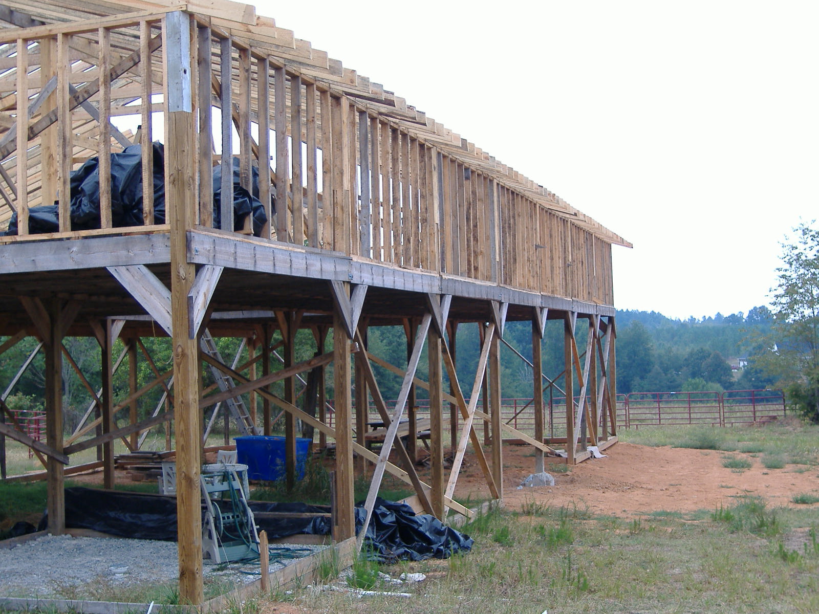

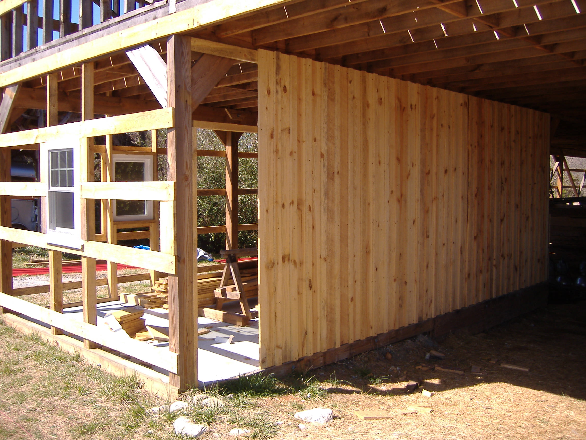

OK Here is the latest pic of the latest progress on the second floor of the barn. From the last pic this now includes the front and back hay loft walls. It will be two weeks before the lumber is cut for the roofing system. Time for a break.

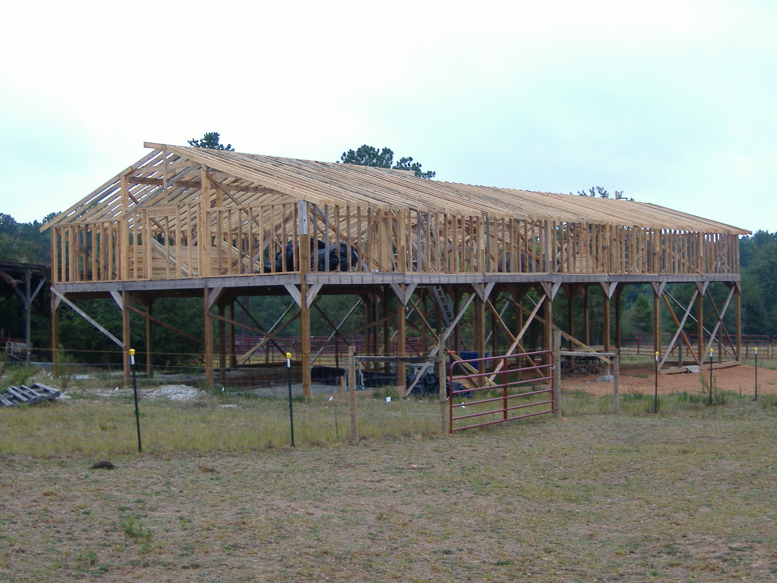

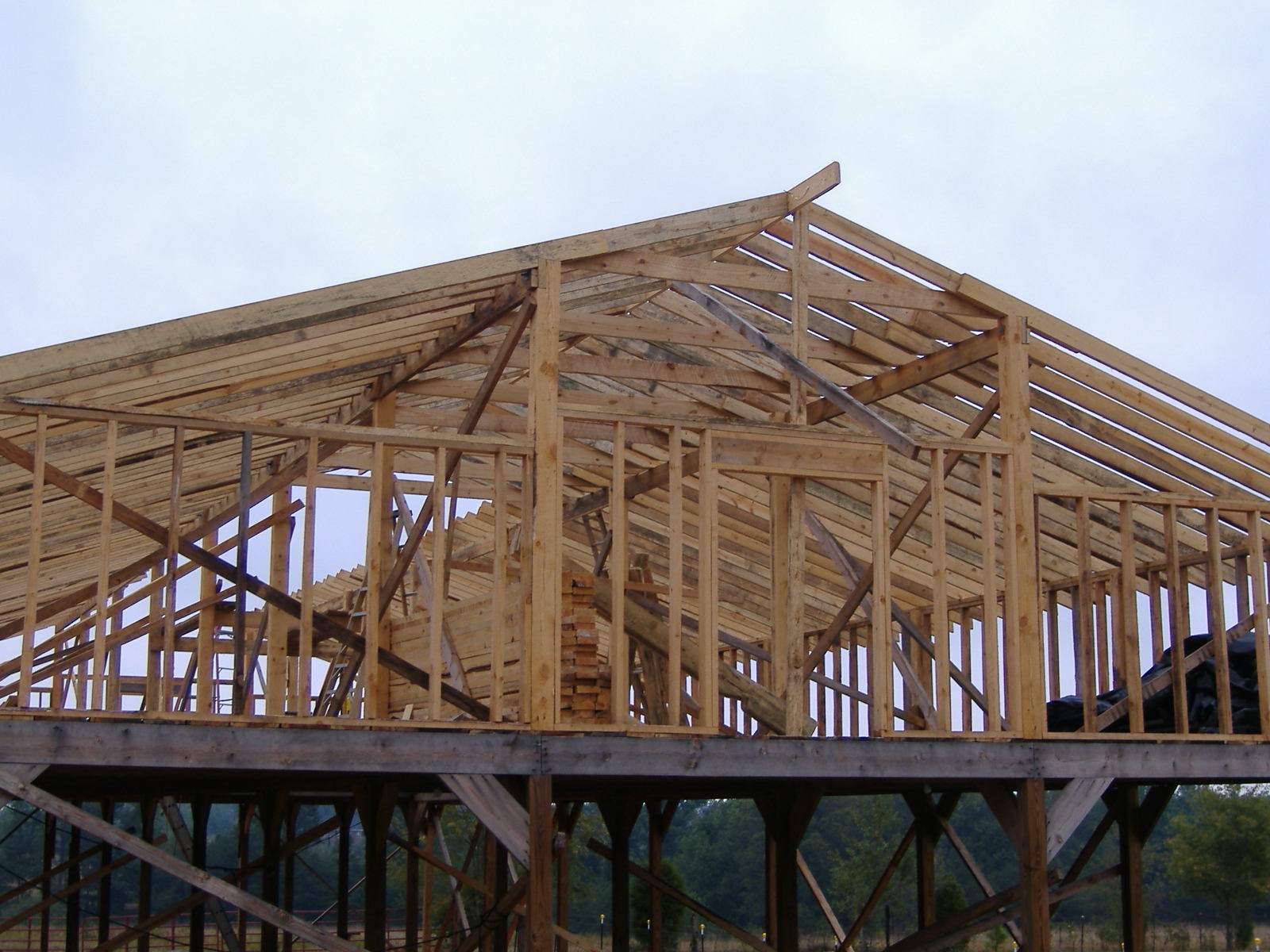

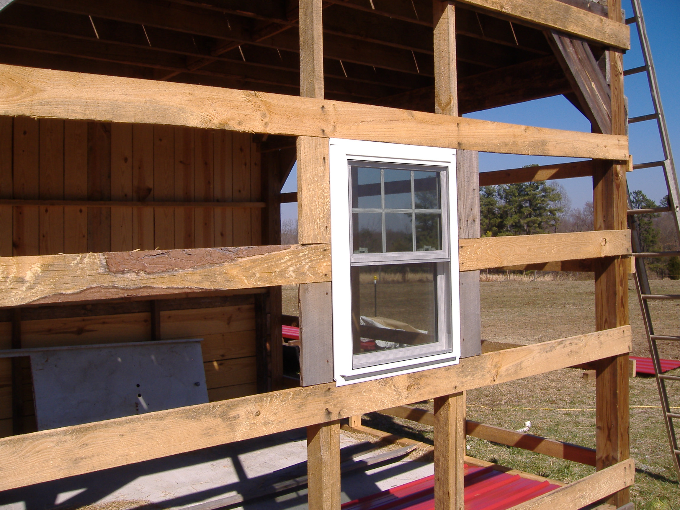

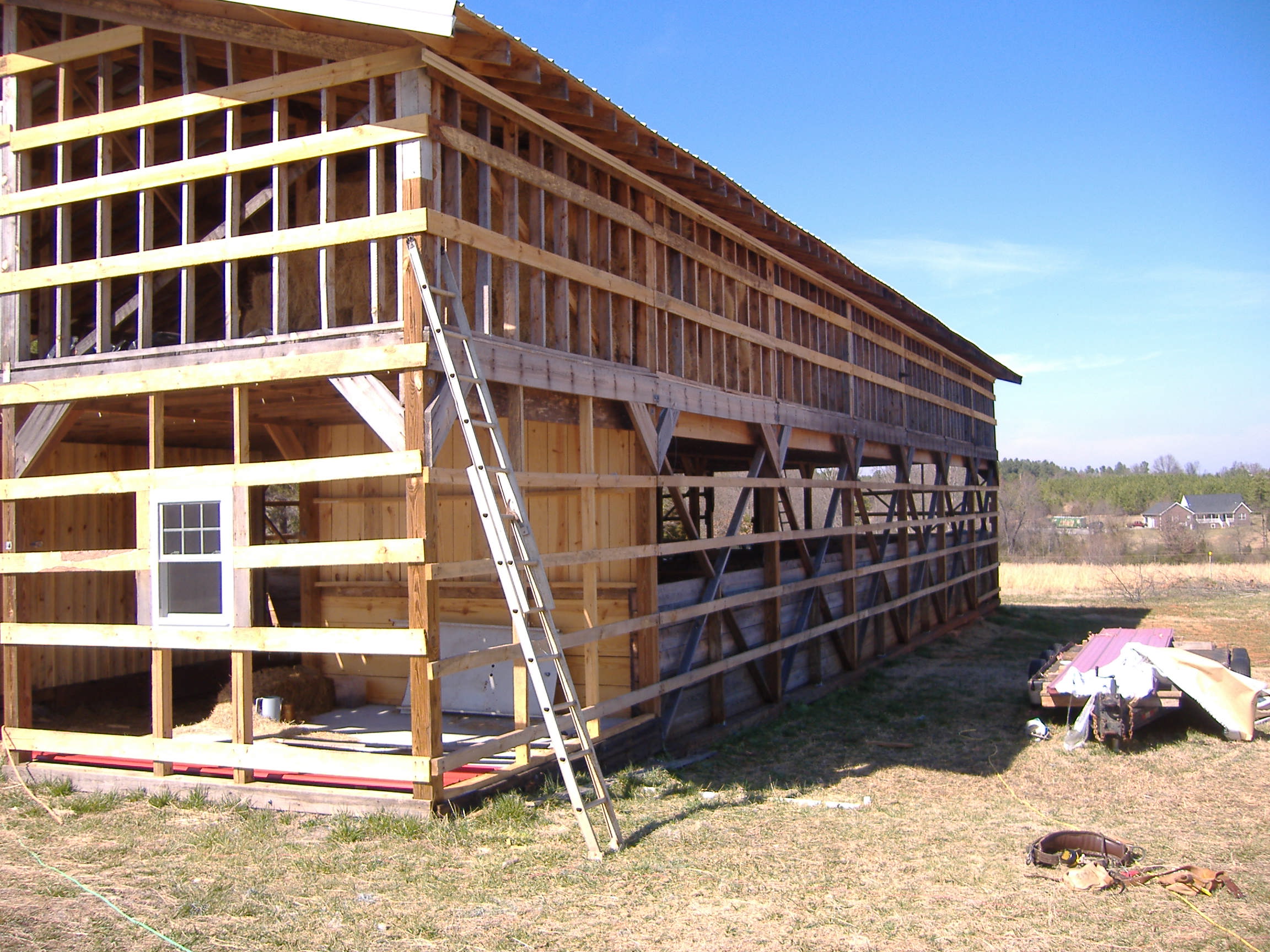

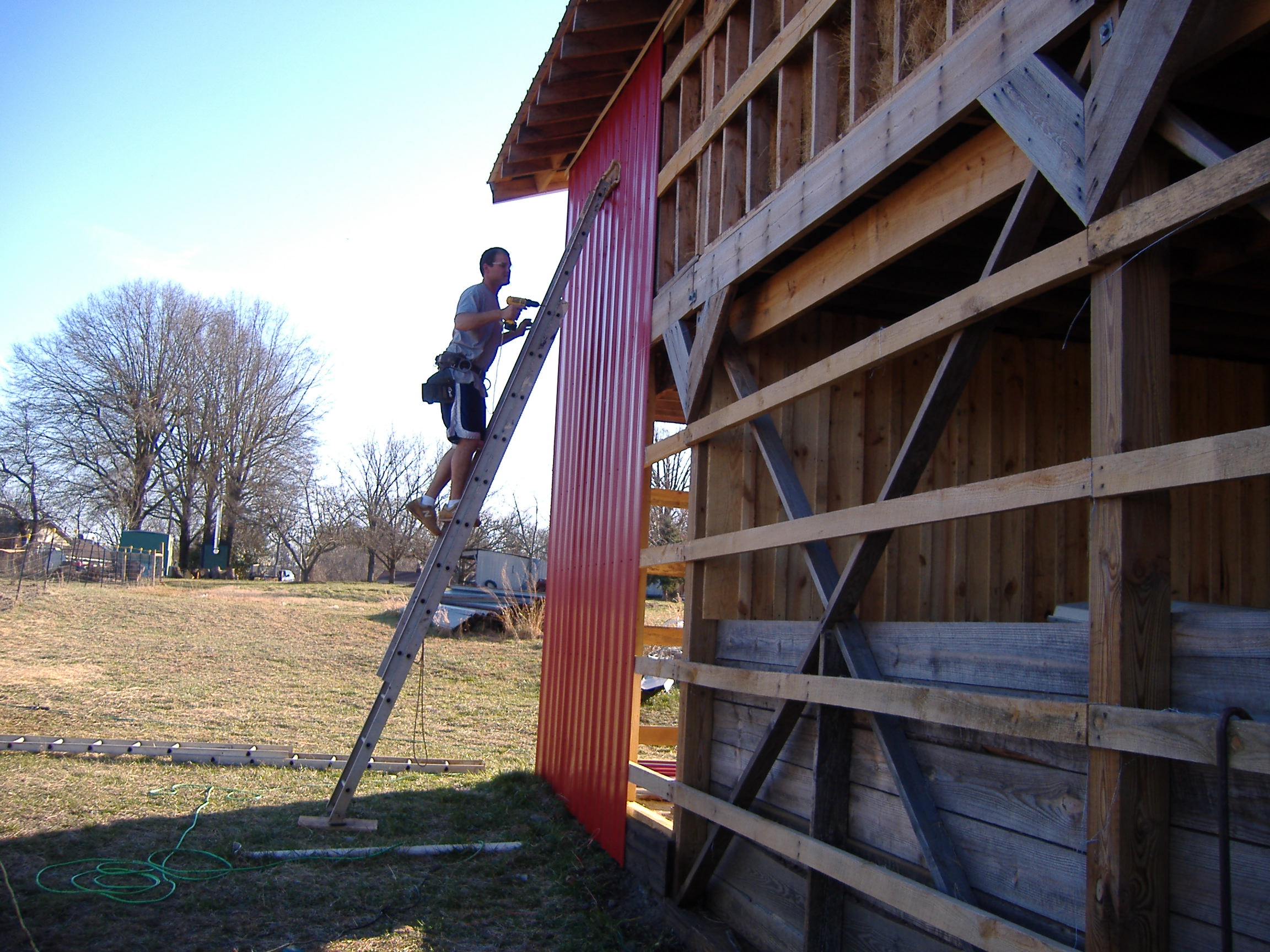

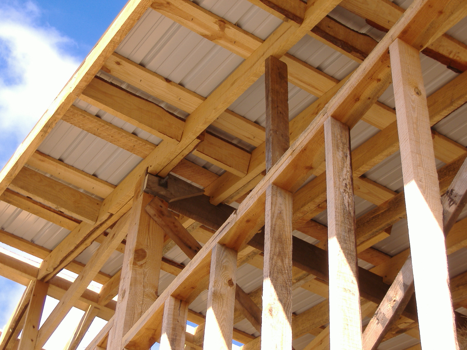

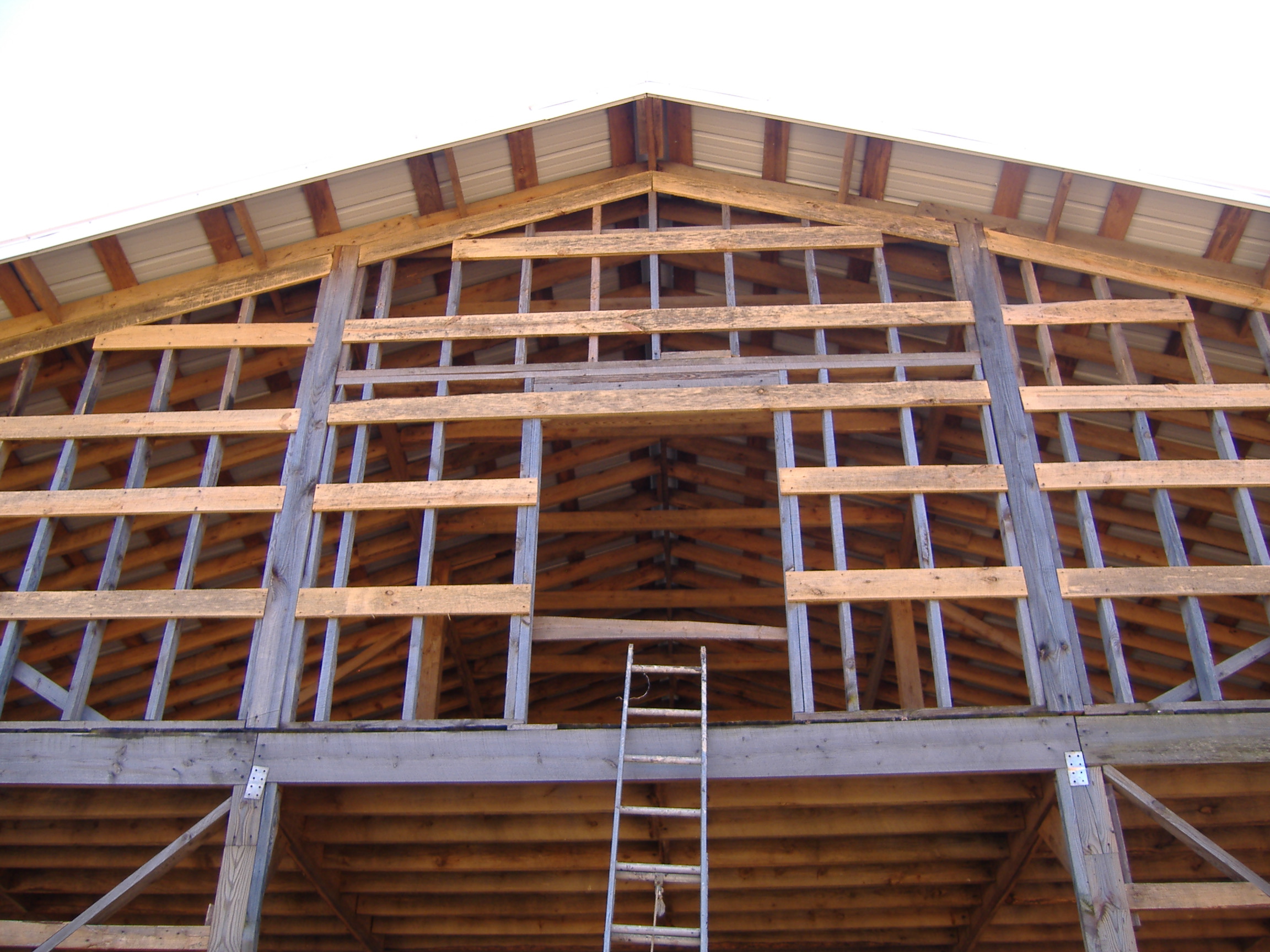

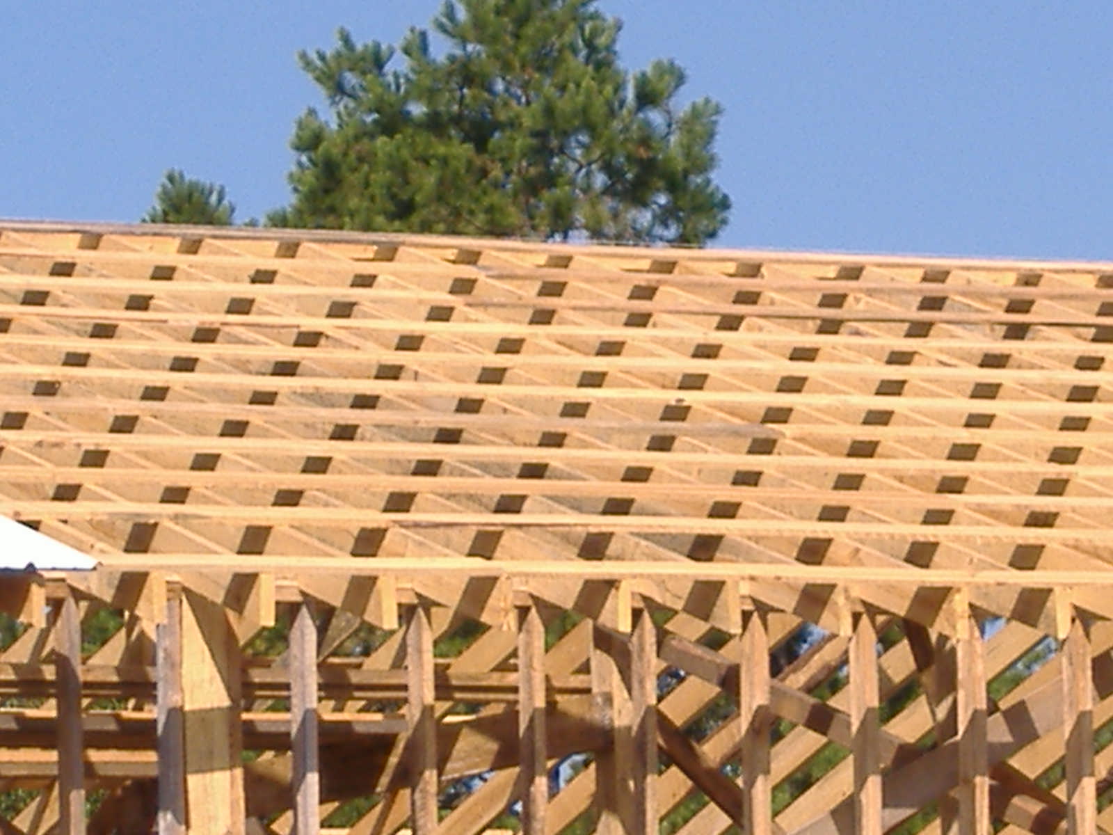

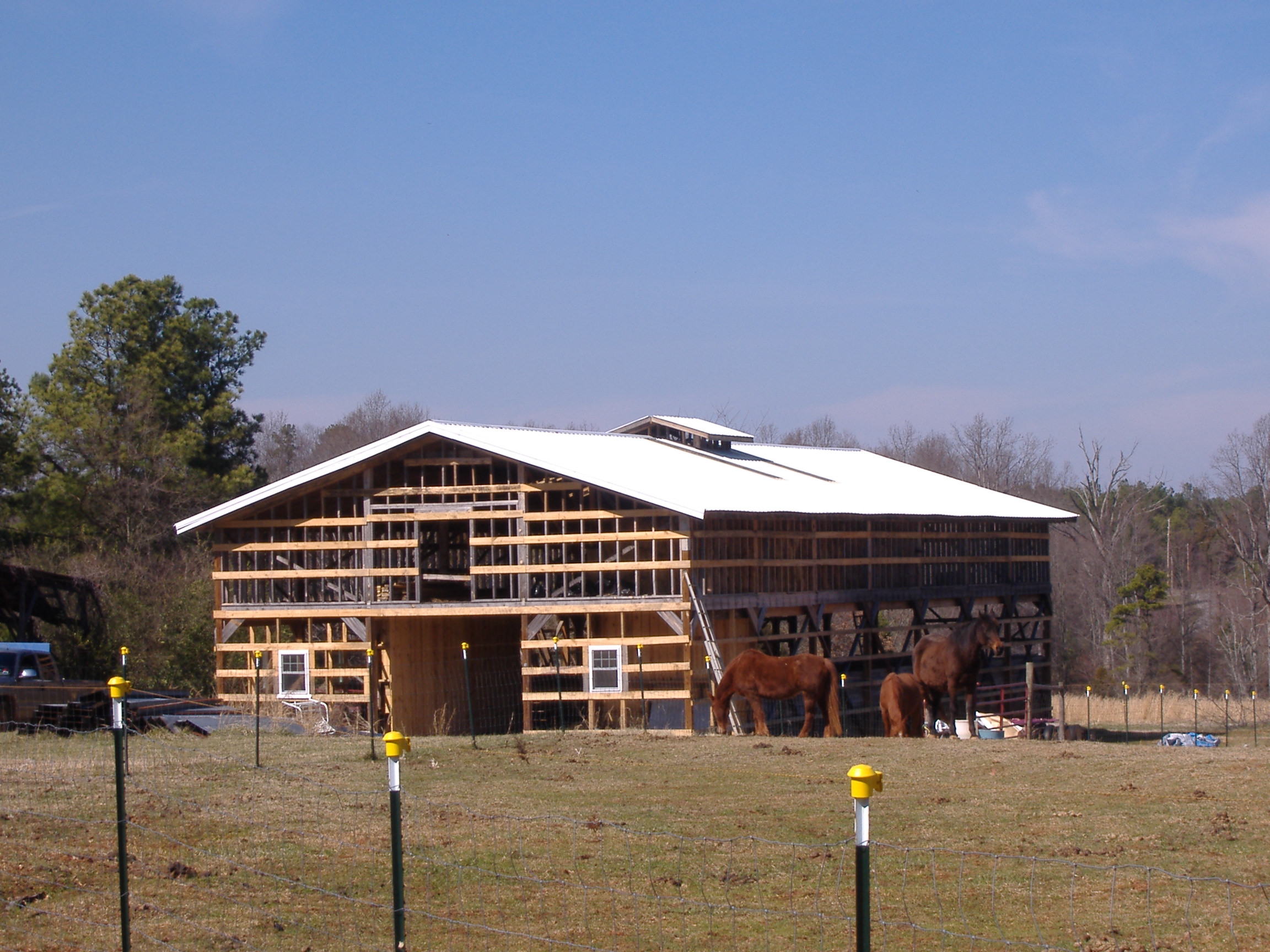

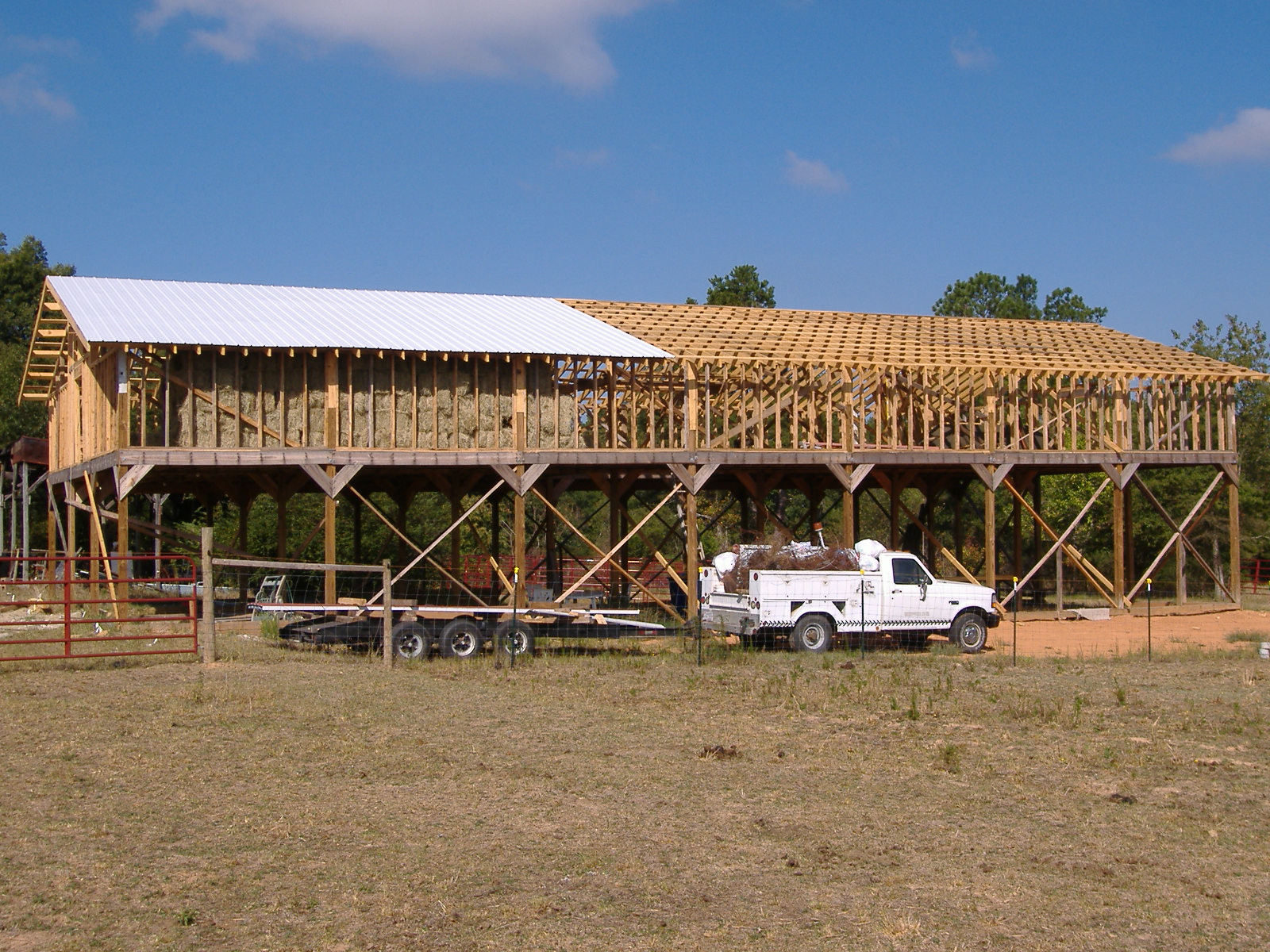

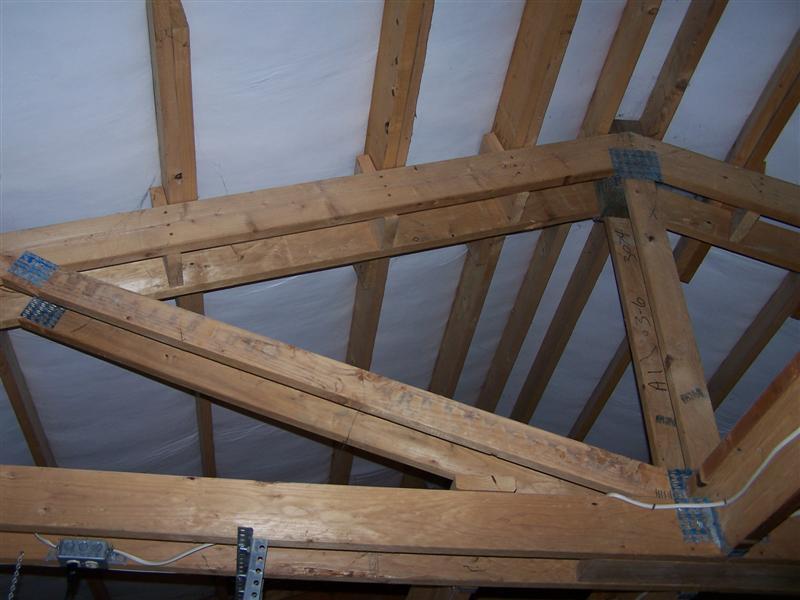

OK. It's been a month since I posted but here is the latest status on the barn. Most of the roofing system is done. Next is slats and metal.
Installed 6x6x10 posts on hay loft and tied in with 2x8x12
Next the 2x6x16 truss on either side were installed then the center ridge was installed with 2x6x8ft truss. Now this was a lot of lumber:eek: . I don't look forward to building another one. Hope it lasts. After this stage I called the insurance company to get it insured. Just too much labor to lose.
Enjoy. Metal will go on this weekend.

Congratulations on your progress.
I'm a little confused on your framing. You said you are putting metal siding and roofing on, but you framed the walls a and roof for sheething. Metal goes on purlins, and you don't have any. What are you going to attach the metal to?
Eddie
   / 14 Stall Barn Project 84ftx36ft
#20

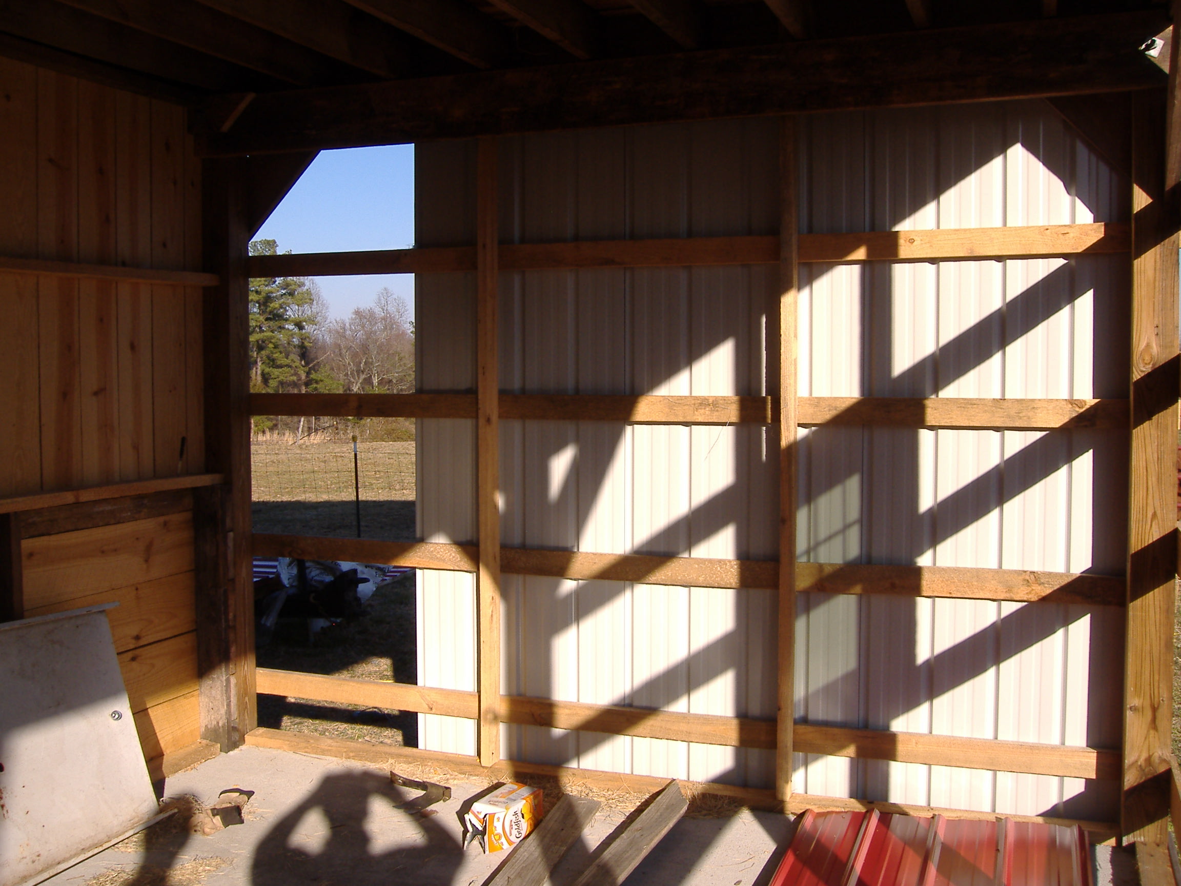

Hey Eddie, Purlins I think of wood that goes between studs,joices or trusses. But I think you mean slats nailed across the framing.
I haven't nailed all the slats on yet. I'll update with a photo Sunday when I get the rest of them on. The roof and hay loft will be slatted with 1x6's for the metal and the lower level with 2x4's since the span is longer without support. The cross bracing I used because I wasn't able to finish framing all the stalls before moving up to the hay loft and roof. You really don't want this thing falling down with all the lumber invested. My biggest fear.
I would be getting more done this weekend but I have to go to Georgia to get hay for the winter. It's just been too dry here for my field to make any hay. I don't remember the last time I payed $6 bale for hay. ouch!:eek:
