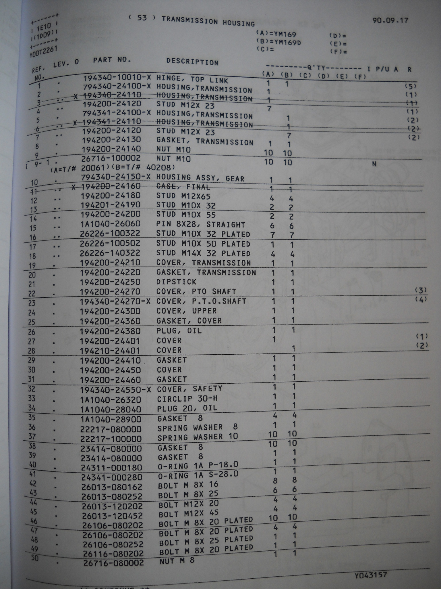

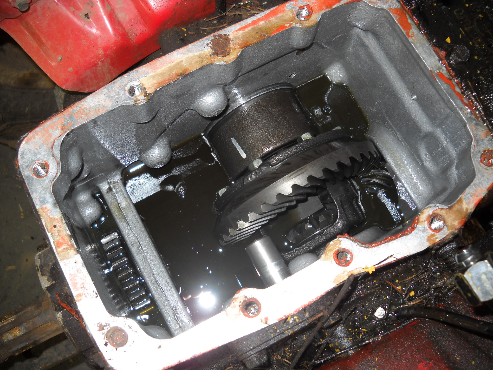

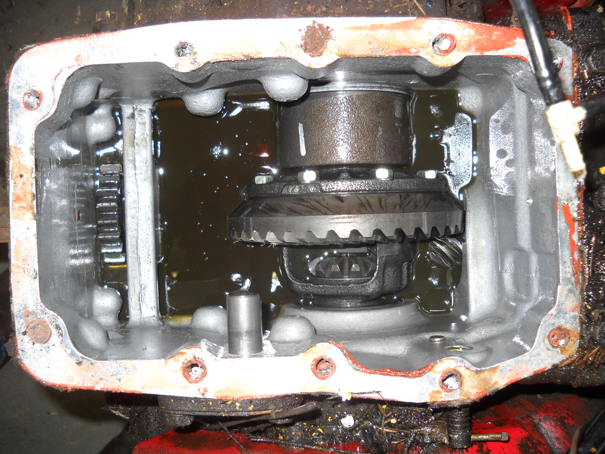

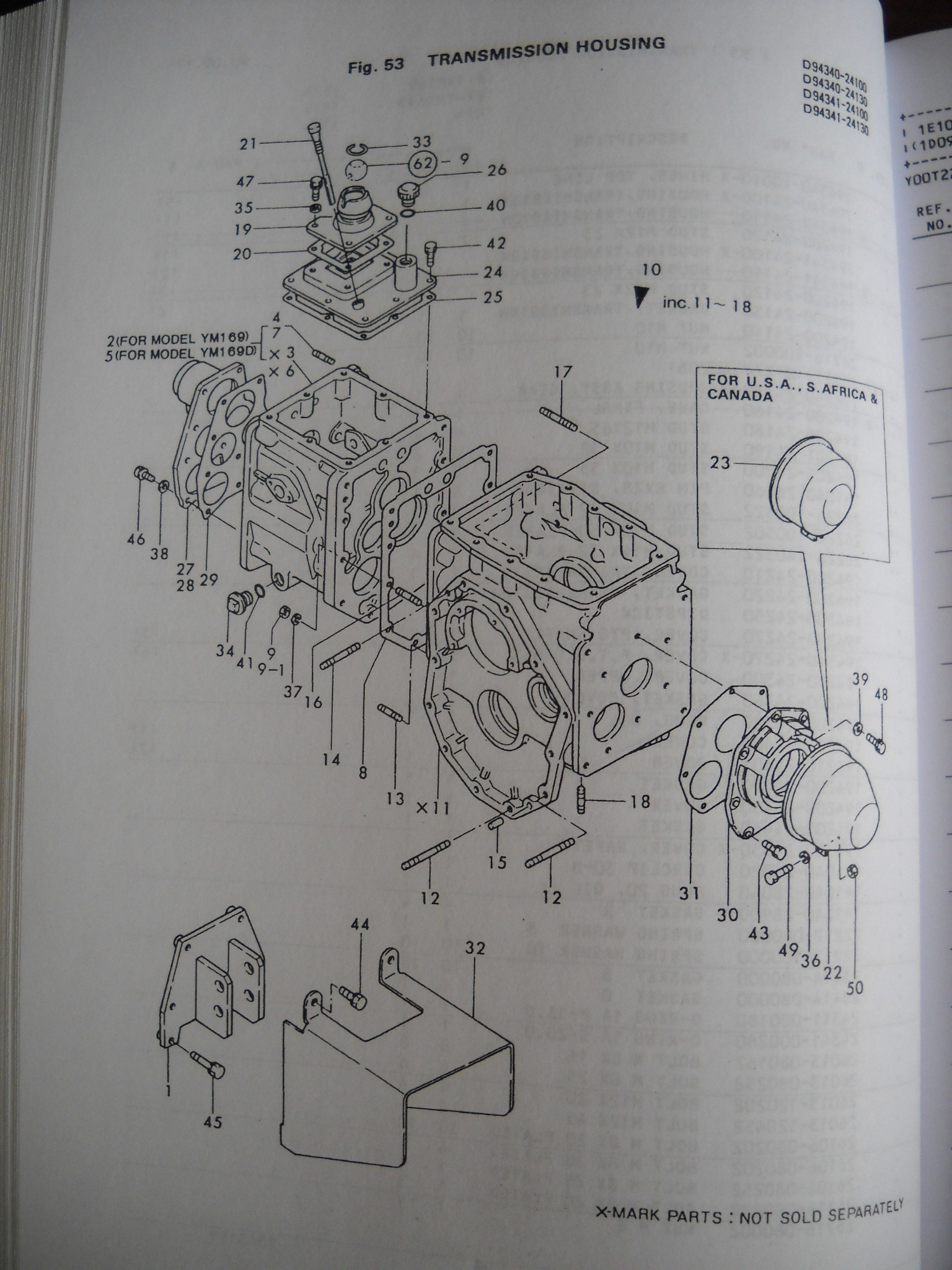

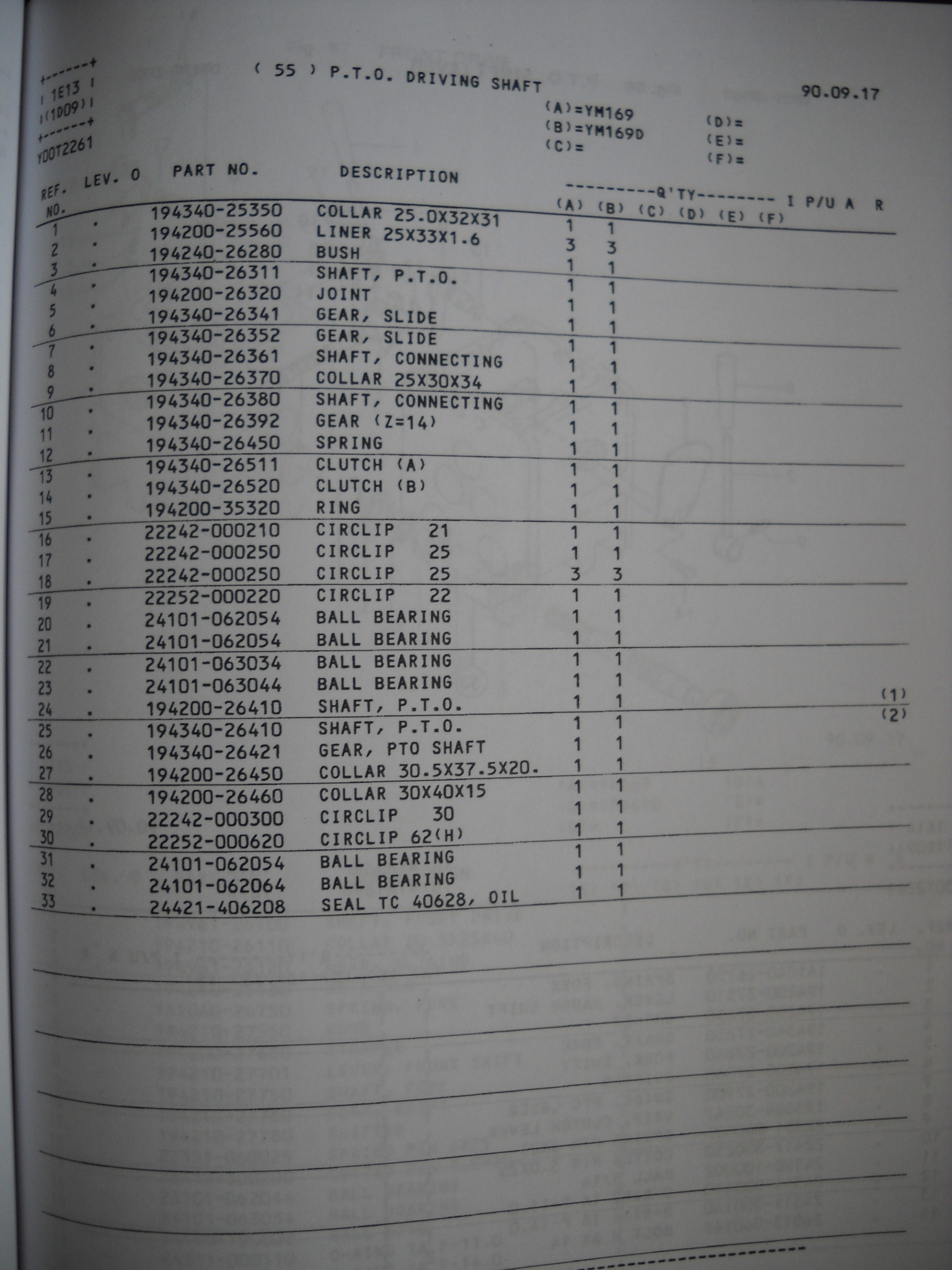

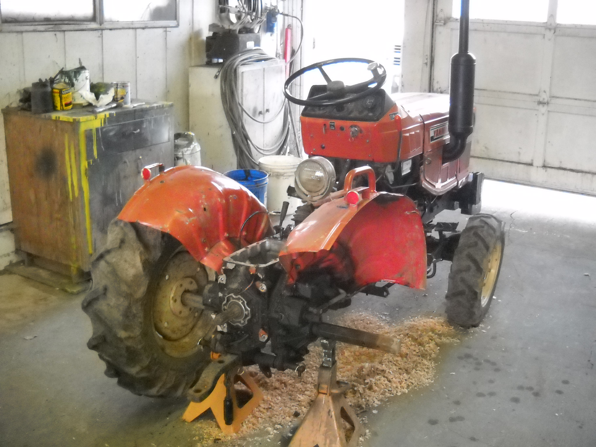

Yes, I was going to suggest the same thing. I have a 169D which is the domestic model to the 1401D. In my manual it shows the gears for your PTO. I have seen the inside of the tranny on my 169D but i took off the hydraulic assembly because I had a seal go out on the cylinder. It wasnt a hard job, but you will get a lot more access to the PTO that way. I didn't see it in too much detail as I had hydro fluid in there but it isn't to complicated. Hoye may have the parts needed as they have several whole 1401's in parts. If you don't have one already, I greatly suggest getting a parts manual, it helps a lot when it comes to things breaking because it gives you parts numbers and a good image on how everything goes together and how it all works. I have attached a few pictures from my manual and of when I had my Yanmar apart in the hydraulic cylinder seal replacement.

I looked at your tear-down pictures along with your copy of the manual. I do have the manuals that go with the tractor.
My understanding from looking at what you posted is that the drive to the rear tractor wheels and the PTO are directly related yes? That is to say some components are shared between the functions of running the tractor drive-train and running the PTO.
Do you have to remove the tire to get at the PTO or was that to facilitate your access to the seal you mentioned?
