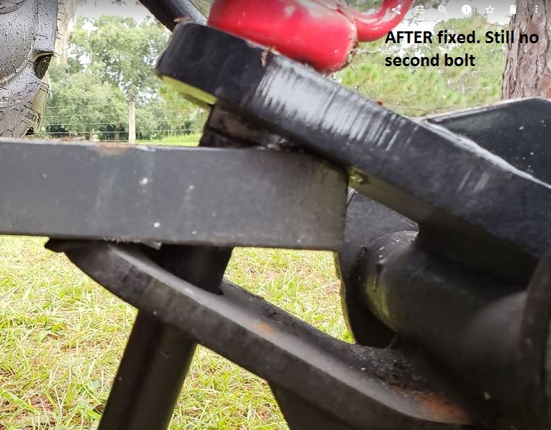

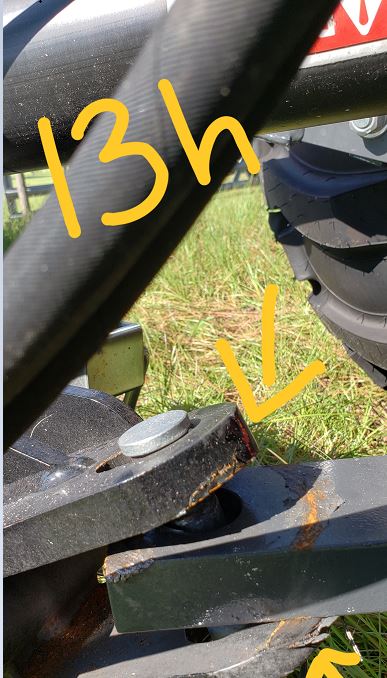

Thanks. Dealer has been out twice to fix. Originally there was only one vertical pin holding the batwing drivetrain to tractor. Second horizontal bolt was not even there, which I was told was normal...really?!?! So the nose was down a few inches and of course it was digging in. Once I added the second horizontal bolt at 13 hours, it was in a better position. They also delivered it with the 3 point not functioning. I gave them a second chance to fix and they still placed no horizontal (I did after they left.) bolt, the 3 point still dysfunctional and one batwing will not lower. On the day of delivery the hydraulic lines for the batwings were in the wrong female acceptors and were switched by delivery guy. There is more, but all this to say, I just spent $60k and cannot even use the assembly and the dealer is no help. I will add photos.

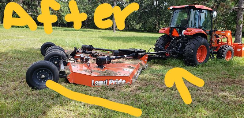

I have the same model batwing (towing with an M5-111). I think your issue might be one or both of these. First, the turnbuckles aren't adjusted properly. There's one on each side, and they control the height of the wings. Second, your front hitch is all screwed up. Compare how yours is hanging to mine, with that rear pin.IMG_0996.jpgIMG_0997.jpg

diesel, the biggest problem I see is the front is down too low, the hydraulics should suspend the front of the hitch as well as the back of the mower, if you are going into the far forward/float position on your lift/lower lever, you are going to have the droop in your hitch where it attaches to the tractor - now in bakers picture, if you turn the adjustment where more bolt is showing/lengthen the throw of the adjustment bolt, your wheels will touch the ground sooner thus raising the rear of the mower higher, you should be able to adjust that as needed - you also should be able to lower your mower wings to a specific height and even run with them up in the air if needed to mow valleys so as you drop the mower wings down, there should be no reason they will be dragging all the time, my skis on the wings only hit the ground when I go over a rise/dip in the ground, they are not meant to RIDE on the ground all the time, if your hydraulics are not holding the wings up and your hitch at the tractor is not raised up where the tongue is level, something is horribly wrong or you are either dropping it down too far manually or hitting the float position on your hydraulic lever.
adjust/lower, adjust raise, suspend wings, - most tractors use a split line/T for the two wing cylinders - one side will lower before the other so just keep holding the lever, it will catch up - like I said play with it, you will get the hang of it, these smaller tractors don't have the high volume pumps in them like the LARGE 100+ HP tractors, my 150hp tractor will flap the wings up on a bat wing like a bird but my smaller tractors are one at a time..........be patient and play with it, oh and raise it up/down, oh yea did I mention, practice going up/down until you get the hang of what it looks like to get the hitch level and wings suspended? ;-) very simple mechanics here not rocket science - and yes those cylinder stops might help on the wings IF you don't want to manage them by hand - let us know how it goes

First of all, one of your main issues is the connection to the tongue.
Get some large space washers and put these both above and below your drawbar in order to decrease the 'slop'. DON'T get too big of a pin, 7/8 - 1" should be fine. This will do 2 things. It will save your drawbar from the excessive wearing of the tongue. You can see it in your pic of the connection. And it will also level out the tongue connector with your drawbar height. It will likely take 10-12 thick 1" washers to do what you need it to do, and most will be above your drawbar.

After you have your hitch connected well, then you must establish 'front/back' evenness to level, at the height at which you want to cut 'normally'. Usually, this should be consistent at all heights, but I recommend calibration at the height at which you want to cut for the most part. This will be done by changing the long 'threaded rod' which runs along the top from front of the machine all the way to the back.
Finally, you have to insure the wings are level with the center. This can only be done by changing the turnbuckle and any options directly on the tire connection to the machine (if your machine has this ability). The turnbuckles are a little tricky in how they work and the effect they have, so read your manual.

Thanks to everyone. I'm still in the middle of this. I added a $12 bolt to hitch and leveled front end in about 10 minutes. Wing still won't lower. Could be driveshaft. Idk. This is a brand new unit. I have put more hours into working on it than using it. Dealer tried to completely drop out or send another person. I question the competence of anyone at this dealership based on this experience, so I asked for an independent Kubota mechanic. There is not one in this area...

Love the last part. Too expensive for me to have it set up this way at delivery, and after fix. I'll look at my manual for the rod and then check out turnbuckles. Tongue looks good now. Front back good too. I'll get picks, but with one Batwing stuck up ...ughhh
