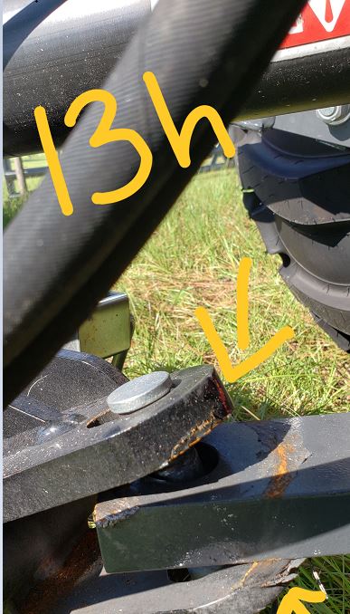

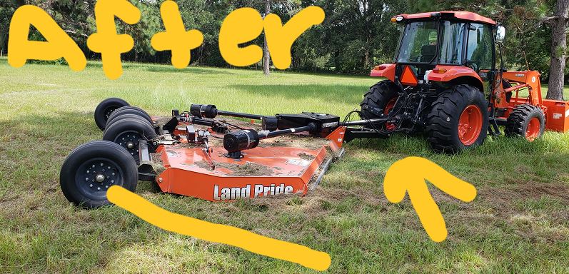

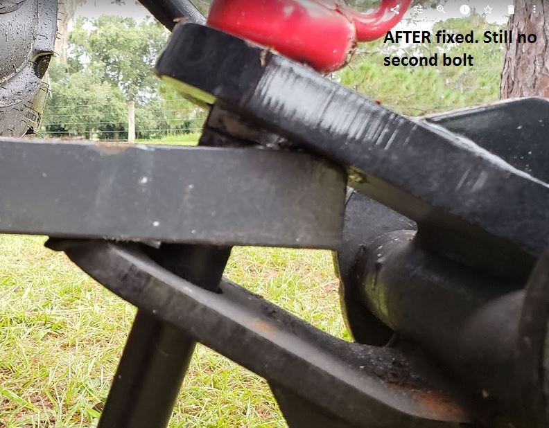

Thanks. Dealer has been out twice to fix. Originally there was only one vertical pin holding the batwing drivetrain to tractor. Second horizontal bolt was not even there, which I was told was normal...really?!?! So the nose was down a few inches and of course it was digging in. Once I added the second horizontal bolt at 13 hours, it was in a better position. They also delivered it with the 3 point not functioning. I gave them a second chance to fix and they still placed no horizontal (I did after they left.) bolt, the 3 point still dysfunctional and one batwing will not lower. On the day of delivery the hydraulic lines for the batwings were in the wrong female acceptors and were switched by delivery guy. There is more, but all this to say, I just spent $60k and cannot even use the assembly and the dealer is no help. I will add photos.

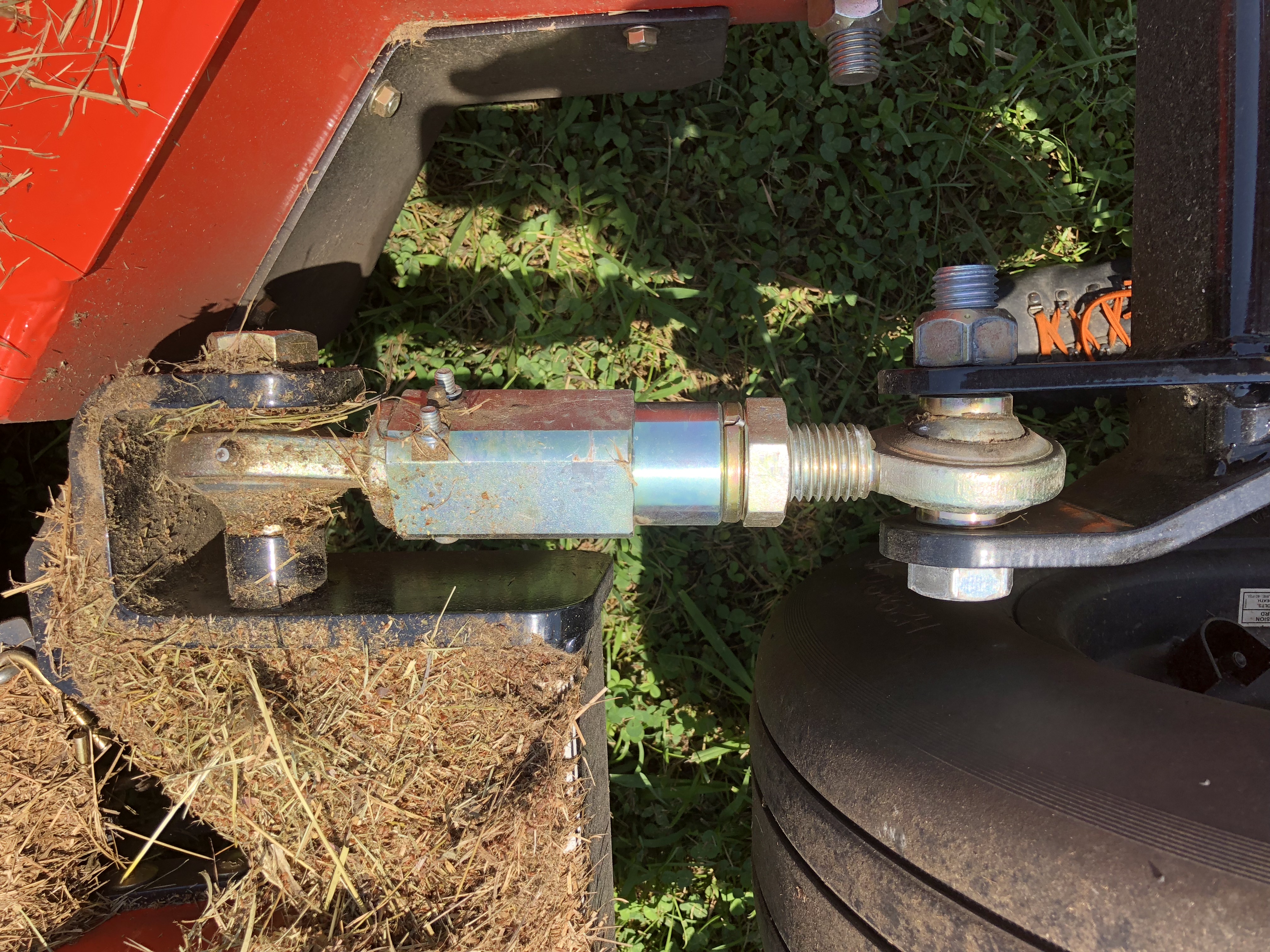

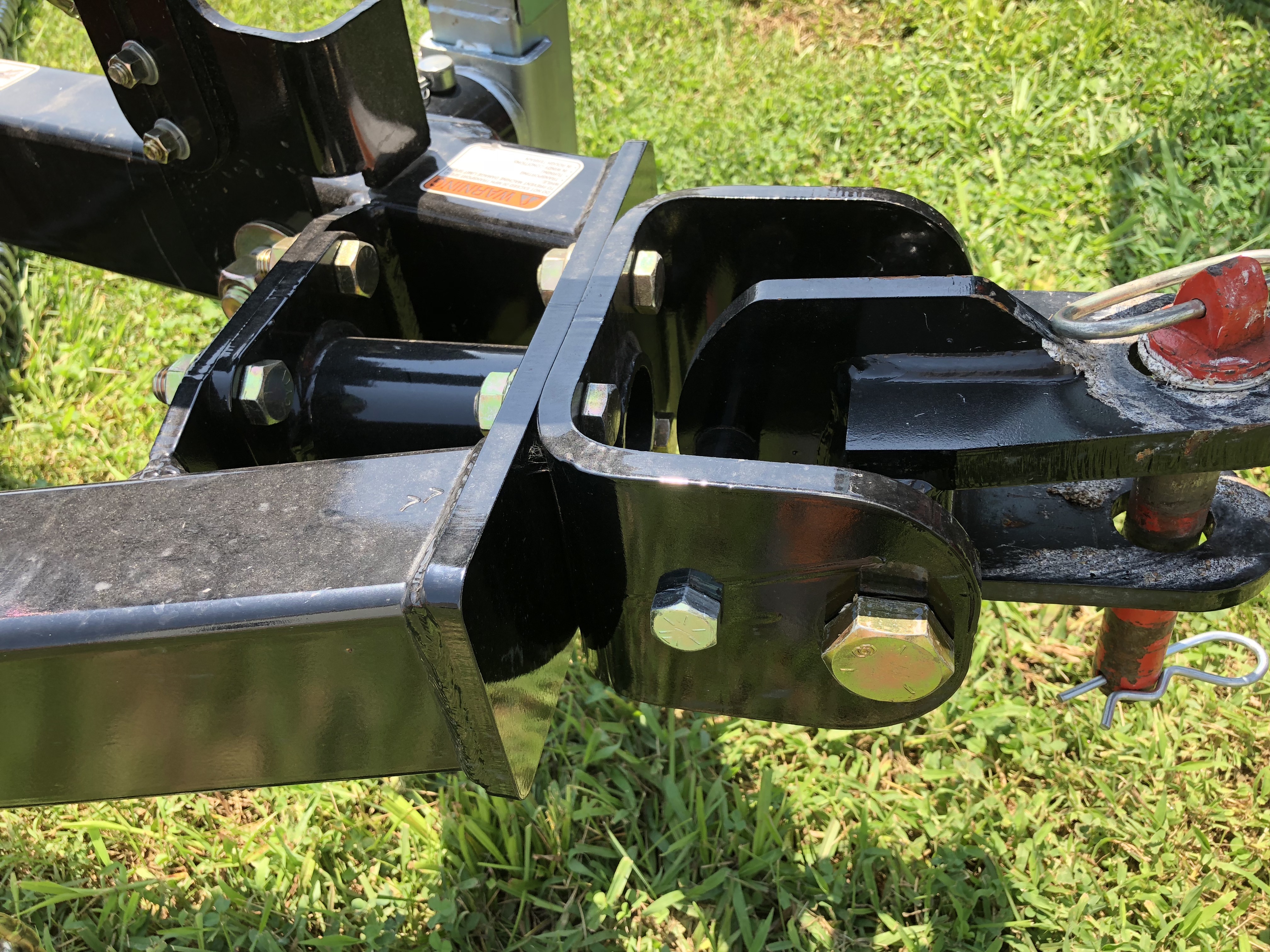

I have the same model batwing (towing with an M5-111). I think your issue might be one or both of these. First, the turnbuckles aren't adjusted properly. There's one on each side, and they control the height of the wings. Second, your front hitch is all screwed up. Compare how yours is hanging to mine, with that rear pin.IMG_0996.jpgIMG_0997.jpg

So, how does the mower follow terrain? I had a 16' finishing mower but a different animal as each deck floated from one another with it's own wheels.

I agree the hitch is jacked. There’s no way that’s acceptable.

If you're draw bar doesn't have holes for a top you could have it fabricated for one. This would make the draw bar forked so the pin has more up and down support. It would straighten up the LP hitch.

diesel, the biggest problem I see is the front is down too low, the hydraulics should suspend the front of the hitch as well as the back of the mower, if you are going into the far forward/float position on your lift/lower lever, you are going to have the droop in your hitch where it attaches to the tractor - now in bakers picture, if you turn the adjustment where more bolt is showing/lengthen the throw of the adjustment bolt, your wheels will touch the ground sooner thus raising the rear of the mower higher, you should be able to adjust that as needed - you also should be able to lower your mower wings to a specific height and even run with them up in the air if needed to mow valleys so as you drop the mower wings down, there should be no reason they will be dragging all the time, my skis on the wings only hit the ground when I go over a rise/dip in the ground, they are not meant to RIDE on the ground all the time, if your hydraulics are not holding the wings up and your hitch at the tractor is not raised up where the tongue is level, something is horribly wrong or you are either dropping it down too far manually or hitting the float position on your hydraulic lever.
