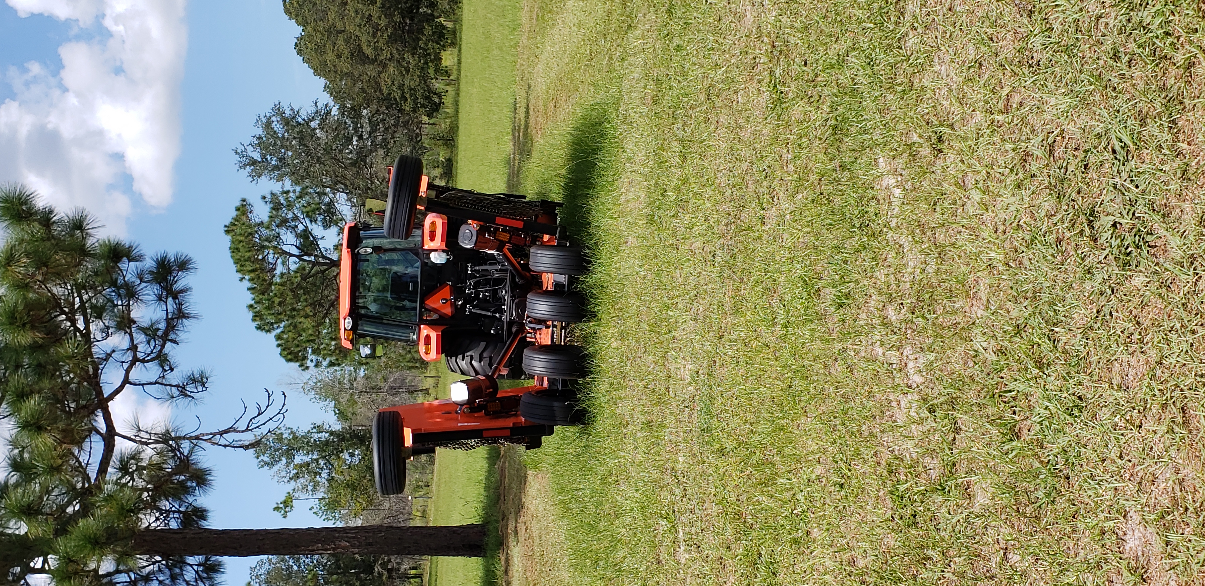

It is working as designed, but it is not set up correctly.
First of all, one of your main issues is the connection to the tongue.
Get some large space washers and put these both above and below your drawbar in order to decrease the 'slop'. DON'T get too big of a pin, 7/8 - 1" should be fine. This will do 2 things. It will save your drawbar from the excessive wearing of the tongue. You can see it in your pic of the connection. And it will also level out the tongue connector with your drawbar height. It will likely take 10-12 thick 1" washers to do what you need it to do, and most will be above your drawbar.
I have problems with my 'wings' sloping down in relation to the main center part. Kind of droop, so each end is cutting deeper than the middle. I 'had' your issue, to a lesser degree, early on. The washers helped.
After you have your hitch connected well, then you must establish 'front/back' evenness to level, at the height at which you want to cut 'normally'. Usually, this should be consistent at all heights, but I recommend calibration at the height at which you want to cut for the most part. This will be done by changing the long 'threaded rod' which runs along the top from front of the machine all the way to the back.
Finally, you have to insure the wings are level with the center. This can only be done by changing the turnbuckle and any options directly on the tire connection to the machine (if your machine has this ability). The turnbuckles are a little tricky in how they work and the effect they have, so read your manual.
Batwings are great when setup and working... but they certainly aren't easy to get that way sometimes. Especially when the guy setting them up doesn't know what he is doing.

hey diesel, just looked up the manual for your mower online, your mower does not have the long rods on top of the deck like some of these mowers like dadnatron is talking about - yours are below the deck near as I can tell in the pix - if you check starting on page 20 of your manual it tells you perfectly how to level the deck using the right/left adjusting rods at the rear of the mower and then the two outer adjusting rods are for the wings. It tells explicitly how to do everything and it sounds logical and simple. the pics are very good also as well as the instructions. the process of leveling the mower to the height of your hitch, using the cylinder stops on the deck height cylinder etc......
once you do this a time or two you will have it down pat and likely not need to move it much unless something gets damaged or broken or unless you change tractors with different drawbar heights. Personally I put my batwing mowers on my 3 point drawbar, I can hook on easier, I can raise/lower while moving to go over obstacles easier. Depending on your setup, that may or may not be a good idea on some of these smaller tractors, my mowing tractor is 150hp and cat 3 and I am dragging through stuff 8 to 12 foot tall at times most of the stuff I mow is 2 yr old growth so its gnarley!!!!

Thanks to everyone. I'm still in the middle of this. I added a $12 bolt to hitch and leveled front end in about 10 minutes. Wing still won't lower. Could be driveshaft. Idk. This is a brand new unit. I have put more hours into working on it than using it. Dealer tried to completely drop out or send another person. I question the competence of anyone at this dealership based on this experience, so I asked for an independent Kubota mechanic. There is not one in this area...
I have given them two options: Take the whole unit back and refund me, or take the Batwing and refund. I don't trust them to fix anything. And I'd be the one dealing with it if something else happened in a couple of months.

Love the last part. Too expensive for me to have it set up this way at delivery, and after fix. I'll look at my manual for the rod and then check out turnbuckles. Tongue looks good now. Front back good too. I'll get picks, but with one Batwing stuck up ...ughhh
   / 15 BATWING DIGGING TRENCHES IN PASTURE: Hydraulics? #37
Raise the wings up all the way. Go to the wing in question and undo one side of the drive shaft. I believe the end of shaft near the center gear box has a quick disconnect. similar to a regular PTO. It has a tapered bolt that just knocks out when the nut is removed. Once it's out let the pressure off the wing and see if you can slide it on off the splines. Once it's clear lower the wing and see if it goes all the way down. If it does then you have a twisted shaft. I've had to use two chains and a tree to pull the shafts apart using the tractor. The inside shaft will be the one twisted.
It won't take but a second to remove the nut and bolt and you'll know real qick if it's a twisted shaft.
Make sure the drive line is clear of everything when you start to lower the wing so it doesn't hang on something..

hi diesel, one wing wont lower or both, sorry I didn't see that in the words above, for some reason I was still stuck that the wings were dragging and cutting trenches - as for the washers and bolt and holding it more level.........well that is a bitter sweet combination and also a designed feature that will allow some extra give/relief when going over uneven ground - kind of like putting a chain on the top link of a 3 point when using a RMM - that way you don't high center - these big batwings only have so much clearance on the solid/straight drawbar vs using on the 3 point lift arms - you can get it perfect on level ground sitting still BUT as soon as you move any little bit or if you were to watch your hitch while driving across a field, you would be amazed at how it fluctuates - any pix of the wings stuck in the air? would they not go down after you made hitch adjustments to level things out? maybe something you adjusted affected them or ? man I wish I was close to you I would drive over and we would get that sucker working for you I cant even imagine how maddening/frustrating/disappointing that has to be -
