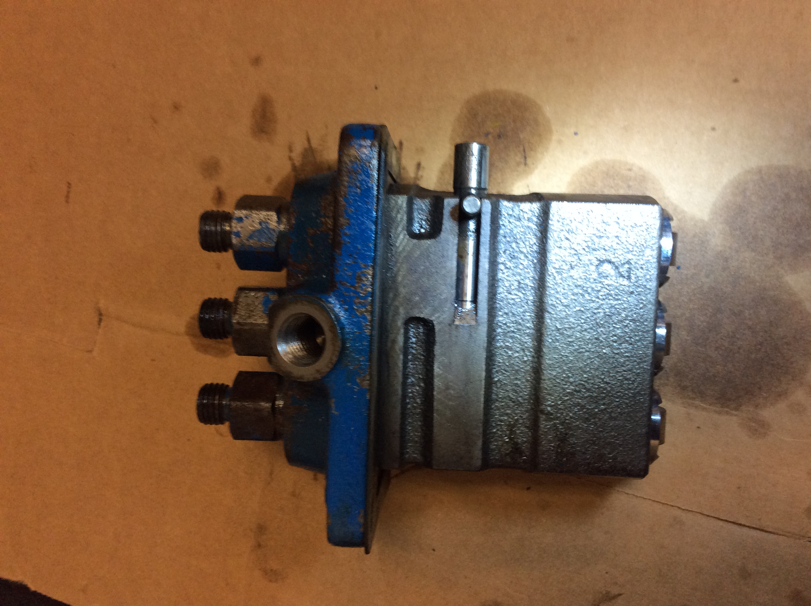

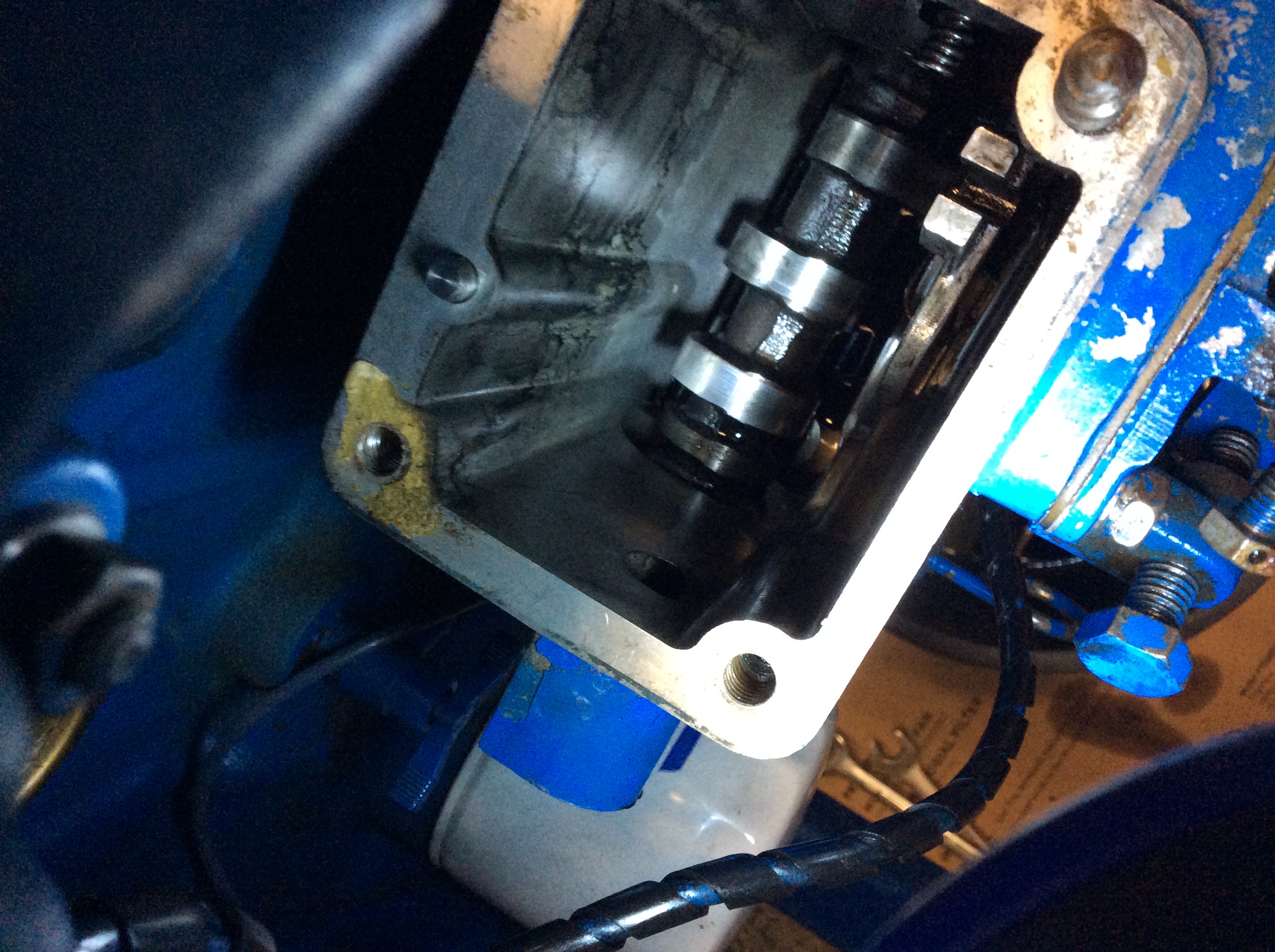

Started digging into the pump as far as I dare without screwing anything up. Was hoping I would see something obvious, rust, plugged screen, bent part, but I haven’t seen anything like that.

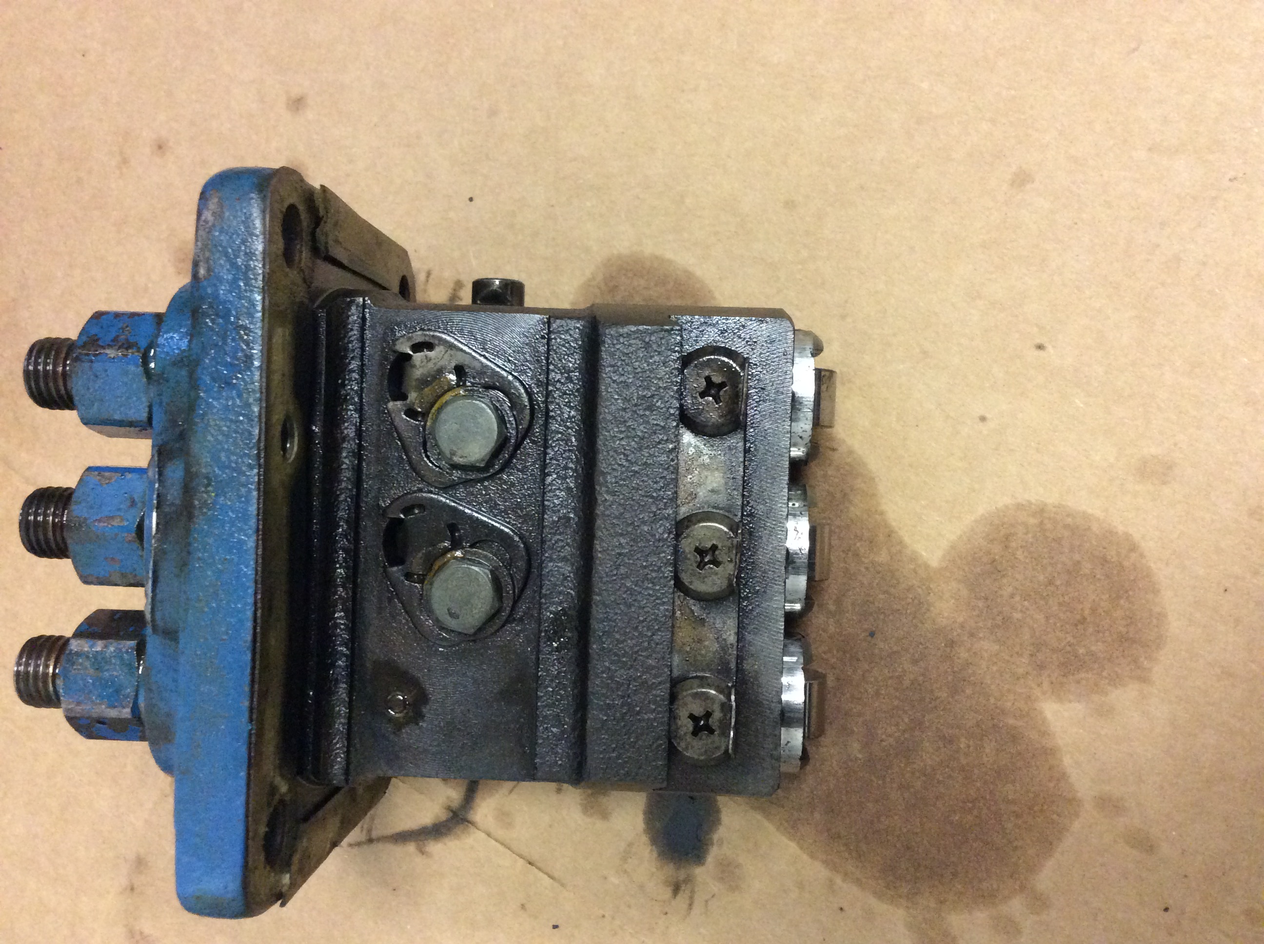

Pulled the pump cartridge out of the pump body. There was no signs of obvious damage or wear. The rack slides nicely back and forth with no resistance. Should there be some? I noticed there were teeth on the back side of the rack shaft like it engages a gear or something inside the cartridge.
Here the rack is slid to the left (Full stop) position.

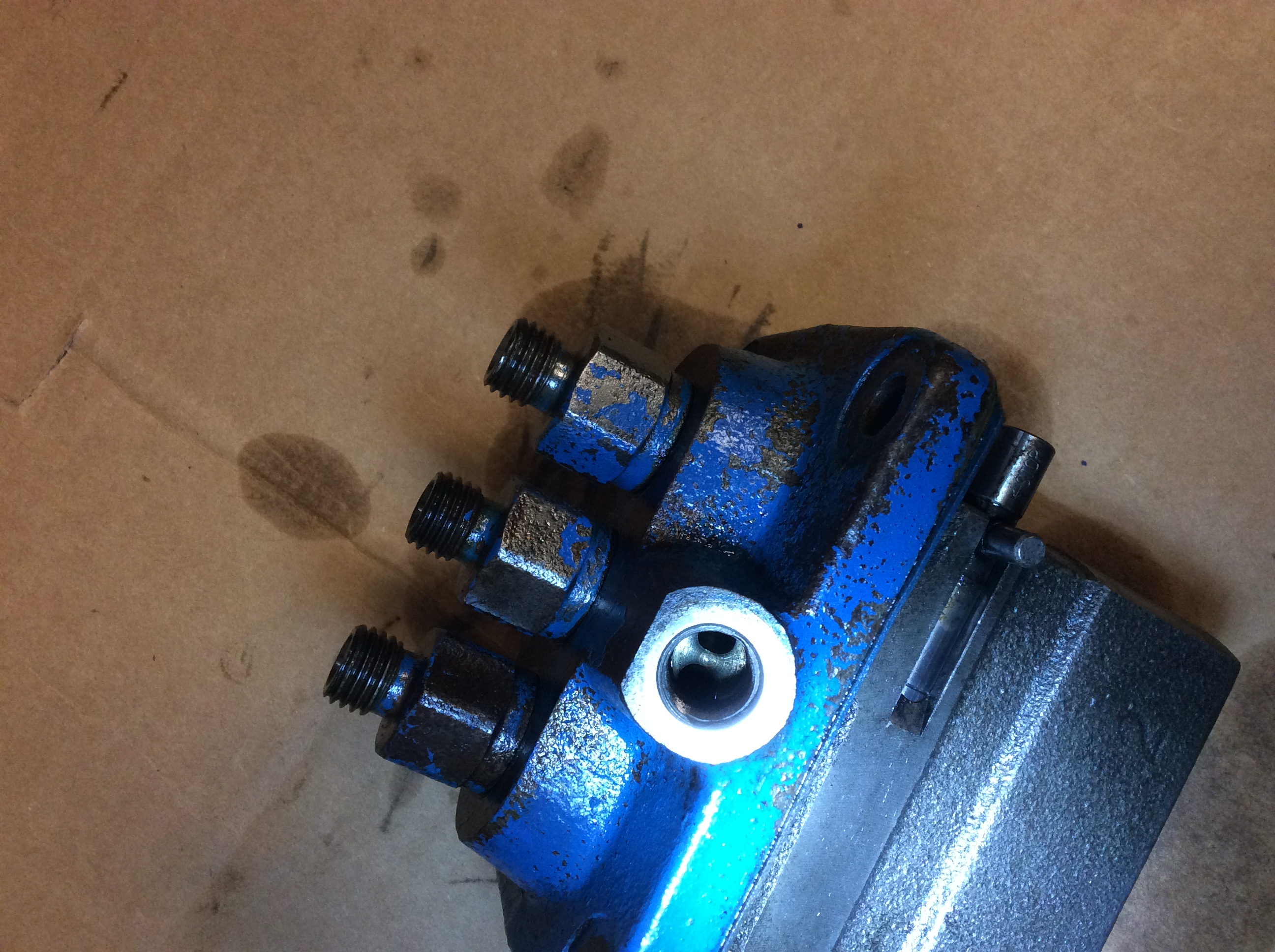

Took the banjo fitting off to check for blockages, found none. Checked the intake port here, and as you can see it is clean.

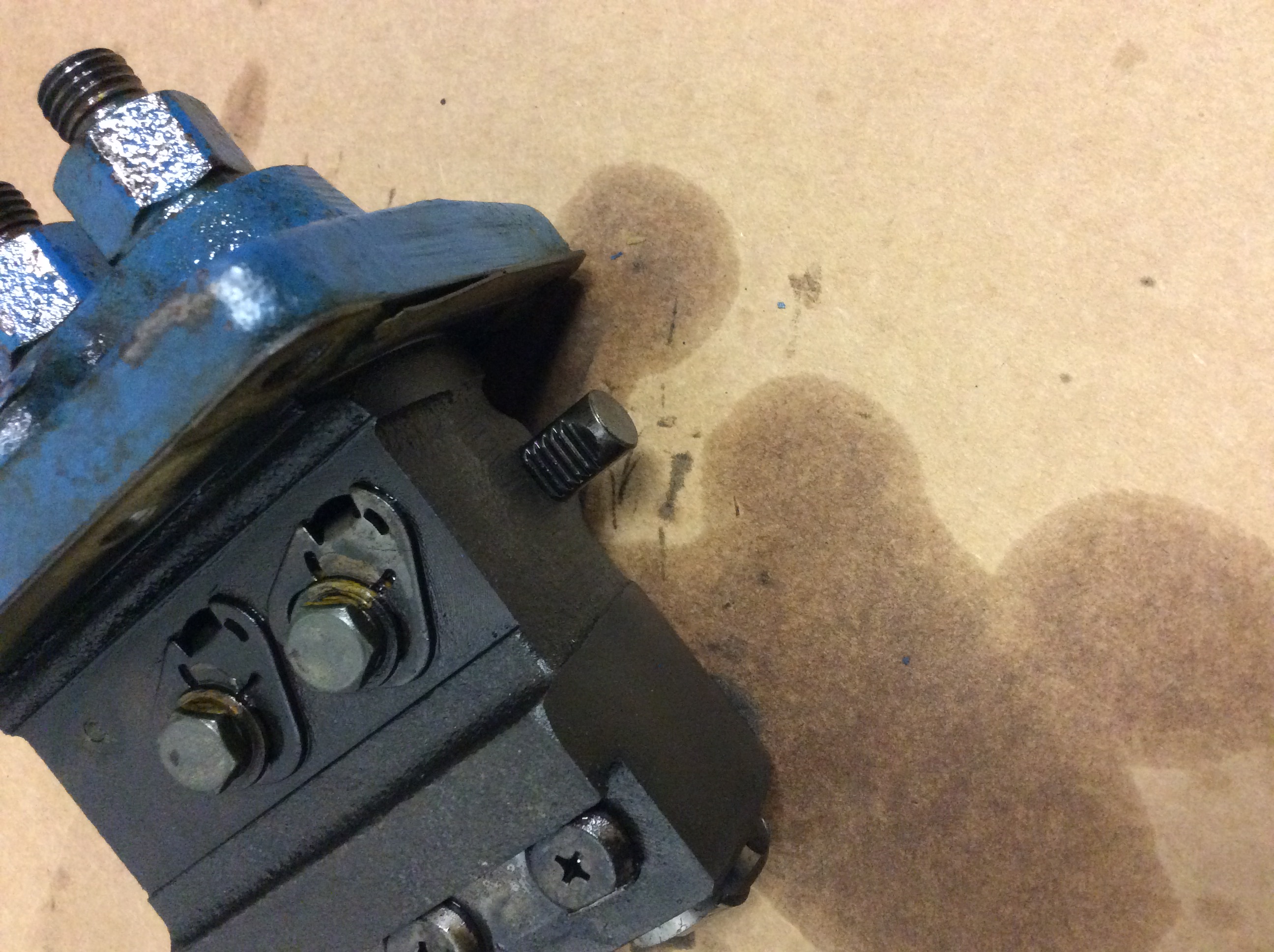

The back side of the cartridge has some retaining clips and bolts that hold the barrels in I guess. I don’t see any obvious issues back here. While sliding the rack back and forth should I see something move inside? I don’t see anything like that happening.

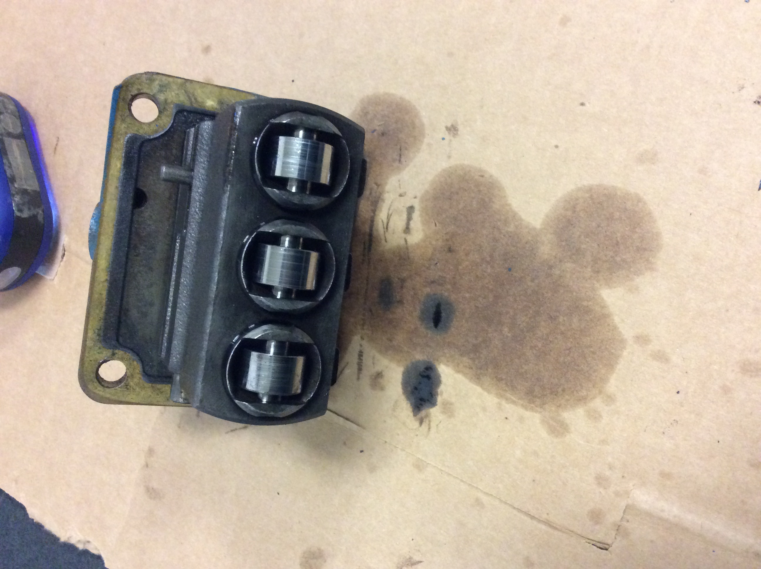

The bottom of the cartridge has three roller tappets for the pumping cylinders. I was able to push on these and felt no obvious problems and they returned to position nicely.
The back of the rack has teeth, I’m just not sure what they engage inside. It slides back and forth very easily like it is not engaging anything.

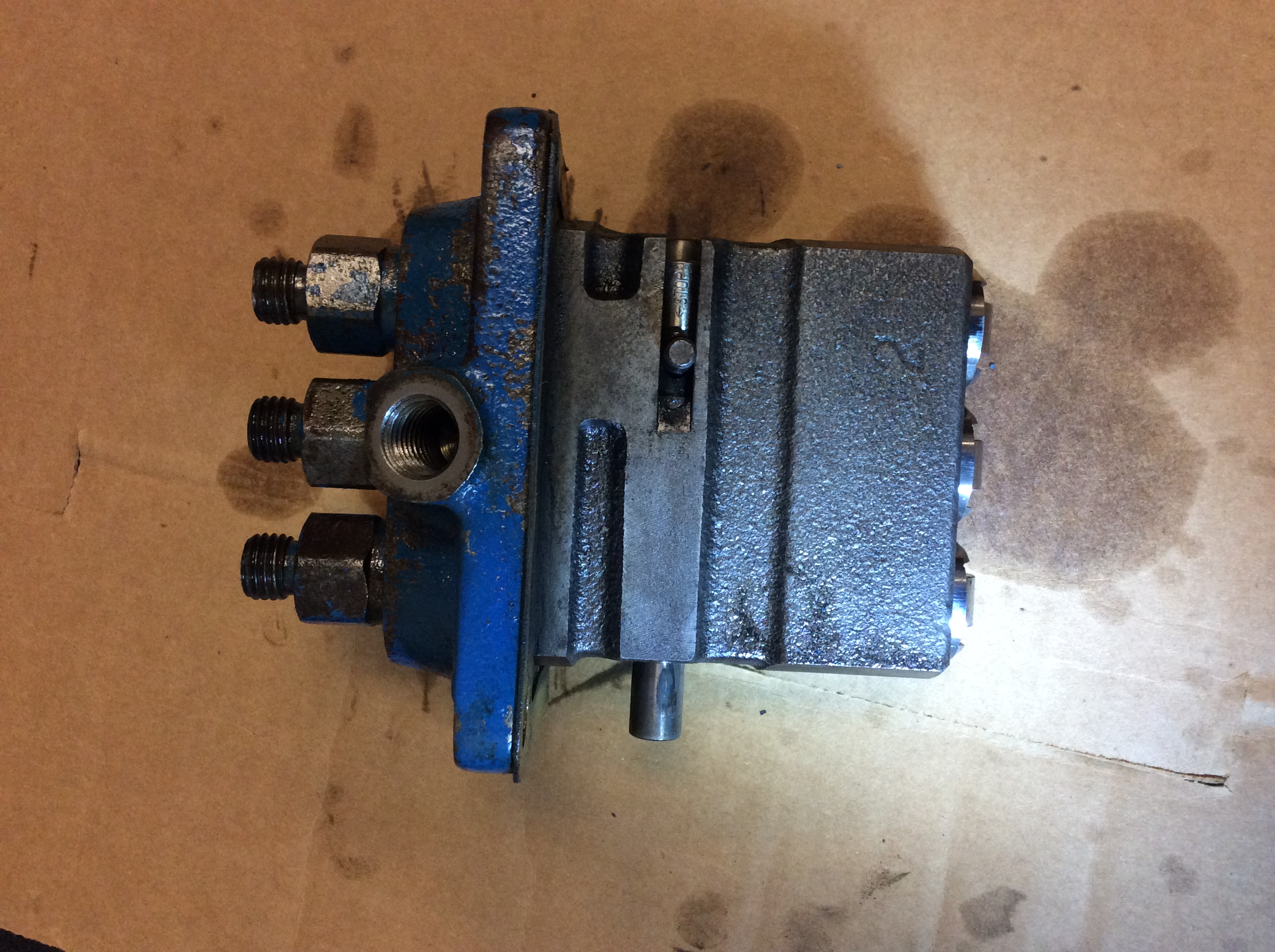

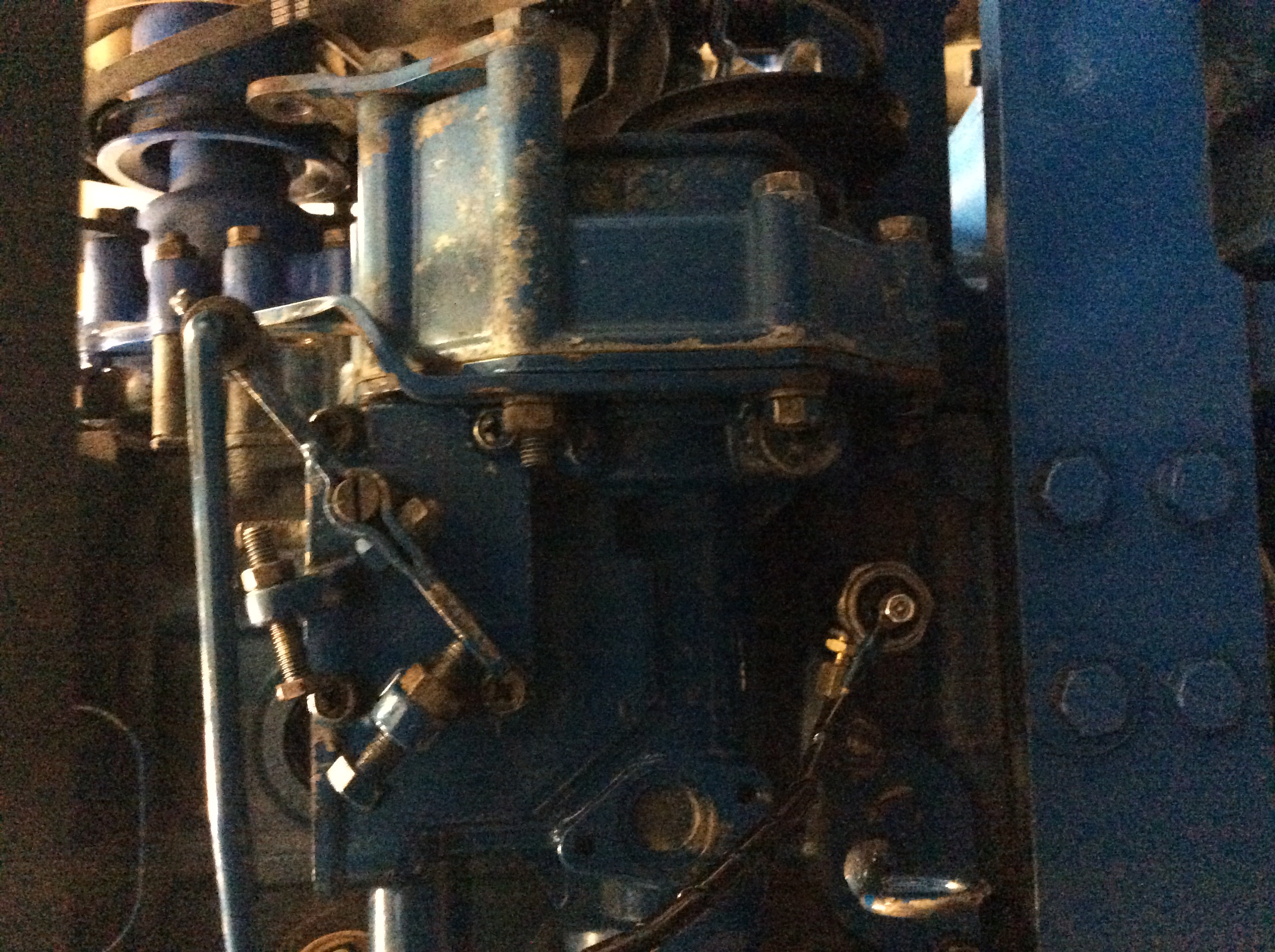

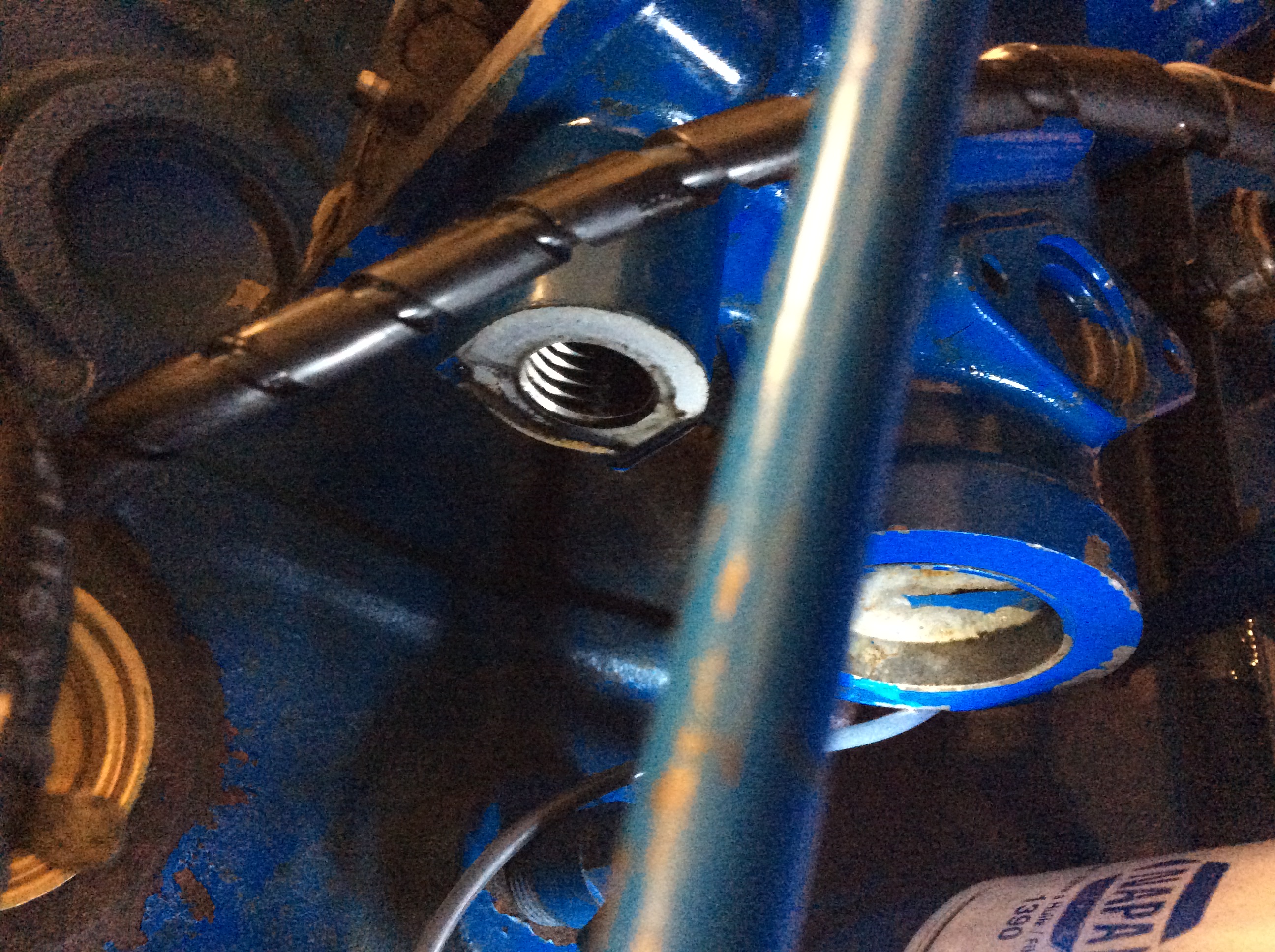

Inside the pump body looked normal to me. No metal chunks, corrosion, or obvious damage. The governor spring on the right side compressed and returned to position fine. The fuel rack actuating linkage did not appear bent or damaged, it moved freely, and the return spring was attached and not stretched.
There was a plug on the back side of the pump that appeared to serve no purpose. I removed it thinking it was an oil fill hole, but that is not the case.
There was little to no oil inside the pump. I tried pouring some in to fill it a bit, but it just drained into the timing cover. It must be lubed via the engine oil system somehow.

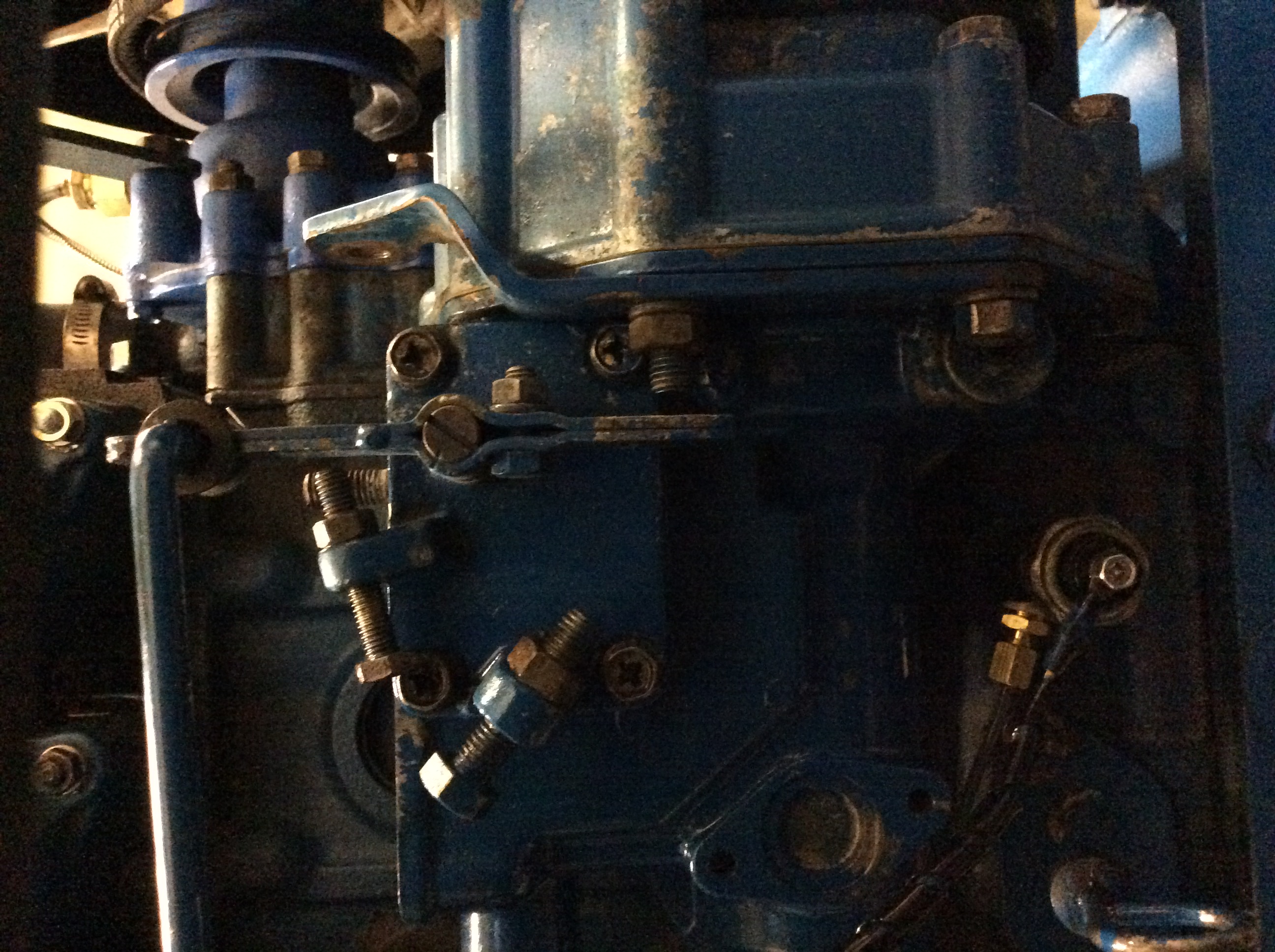

This is a comparison of the throttle at stop and full power. In the stop position it contacts the stop bolt, in the full power position it does not contact the stop bolt.

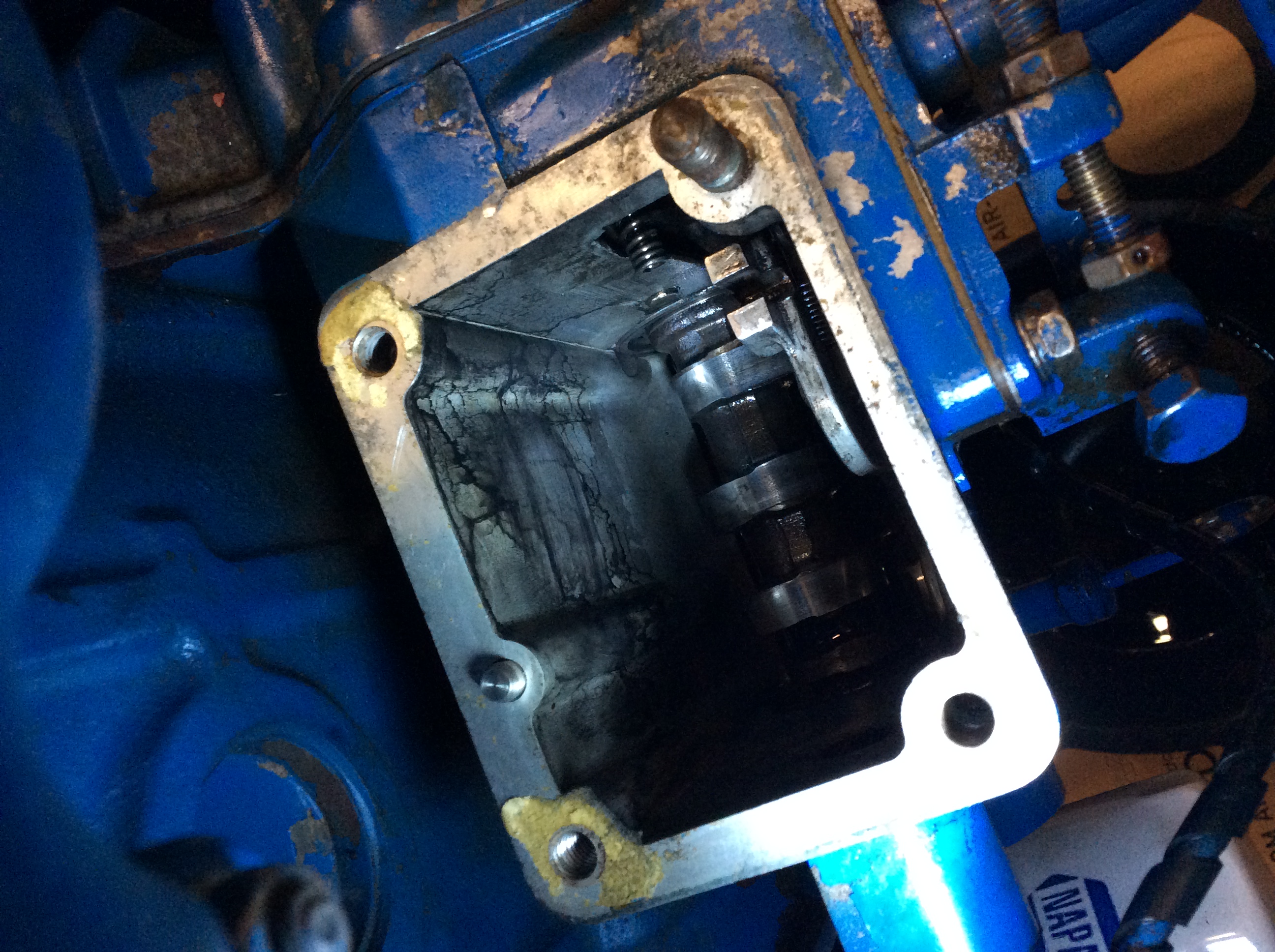

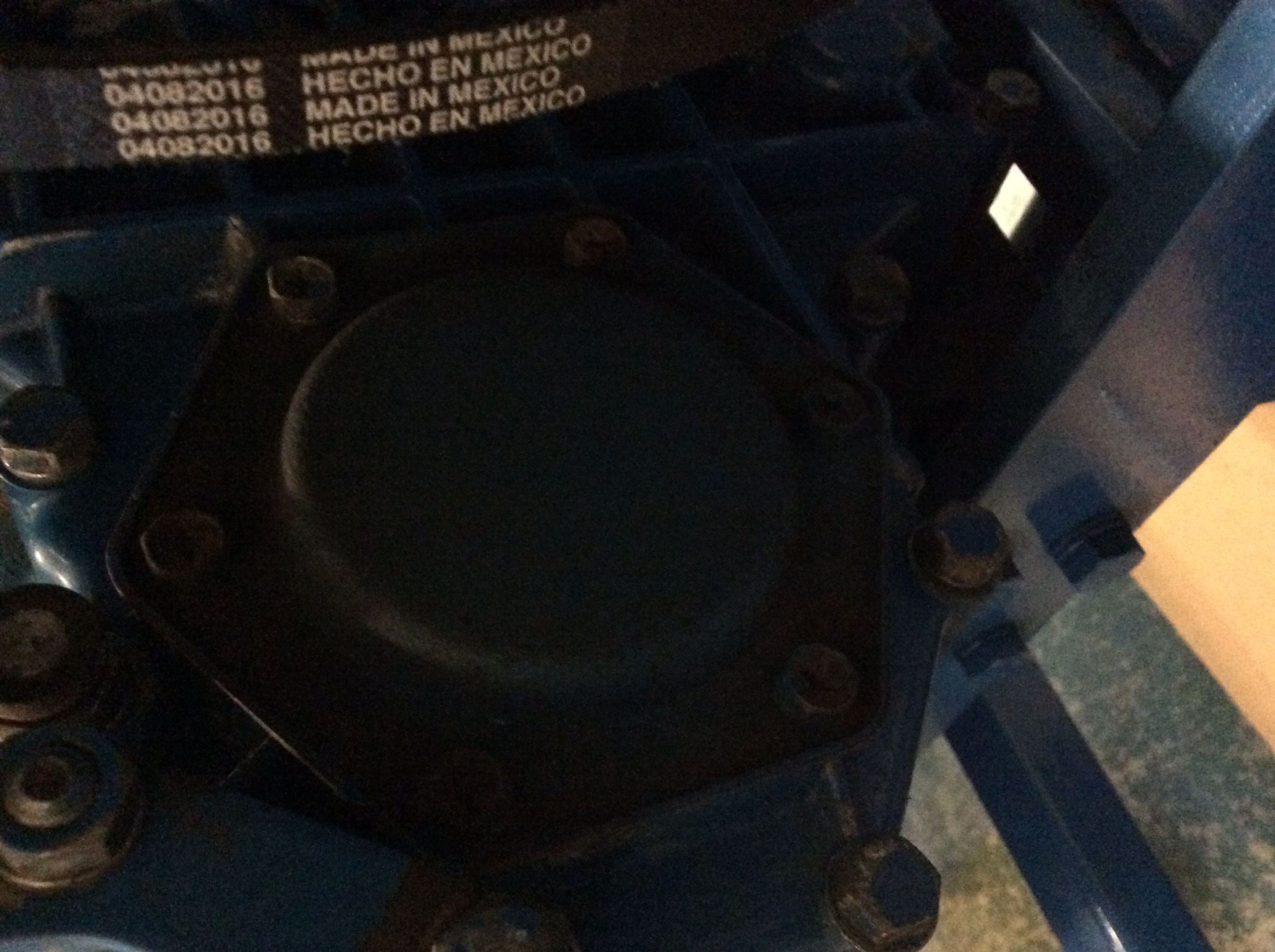

My next step is to remove the access cover here and inspect the governor for damage and see if the timing marks line up on the gears.
I’m hoping someone has some ideas here, because I’m fresh out. I suppose I could pull the timing cover and re-time the pump, but that is some serious work. Maybe send the pump out for rebuild? Any help is appreciated.

No, this thing has me spun. I’ve been researching Diesel engine surging issues, and usually an air leak in the fuel delivery side, or fuel obstruction causes this. I drained the tank and checked for leaks around the shut off valve fitting and also checked flow rate out of the tank. I found a deteriorated rubber gasket around the tank fitting, but not sure if this has anything to do with the surging problem.
The engine will surge up to an almost over speed condition if I move the throttle up to any setting other than idle. I’ve seen enough run away videos online to be scared of blowing the engine.
After I replace the fuel tank gasket, I’m going to pull the side cover off the fuel injection pump and check the linkage again with the pump installed in the body.
If that don’t fix it, I’m probably looking at a governor issue, which sucks because parts are an issue with this engine.
