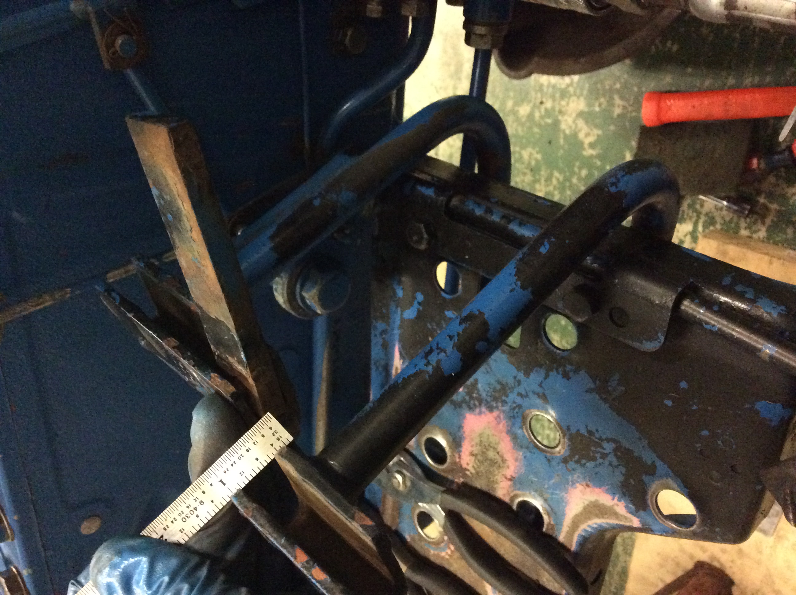

I like those for sure
Much easier to hook up and get everything set right. Pull the pins, spread the arms, attach the implement, re-install the pins. Way, way better than the turnbuckle style.
Even if you have to modify a set to get it right, it would be time and frustration saved in the long run.

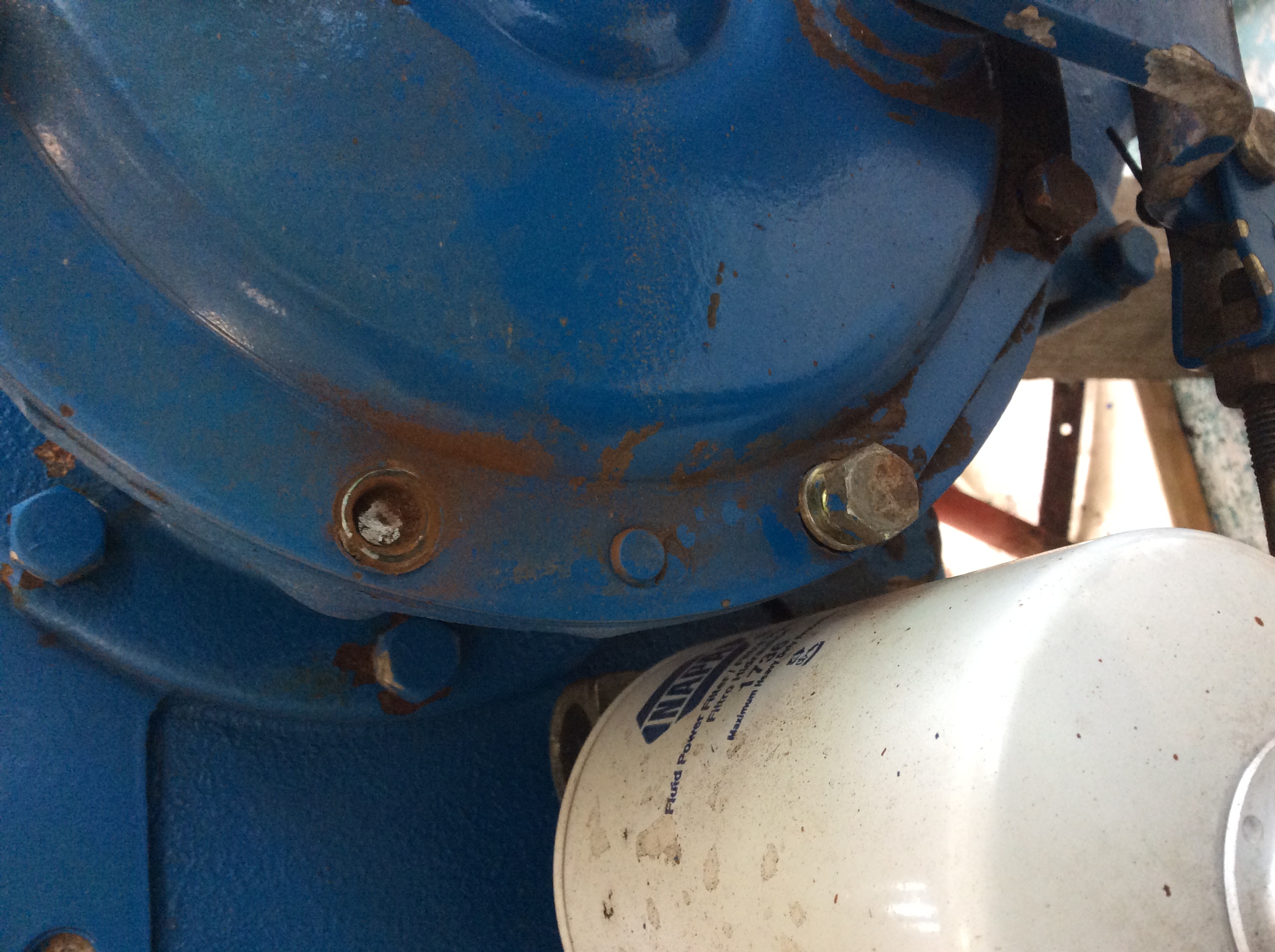

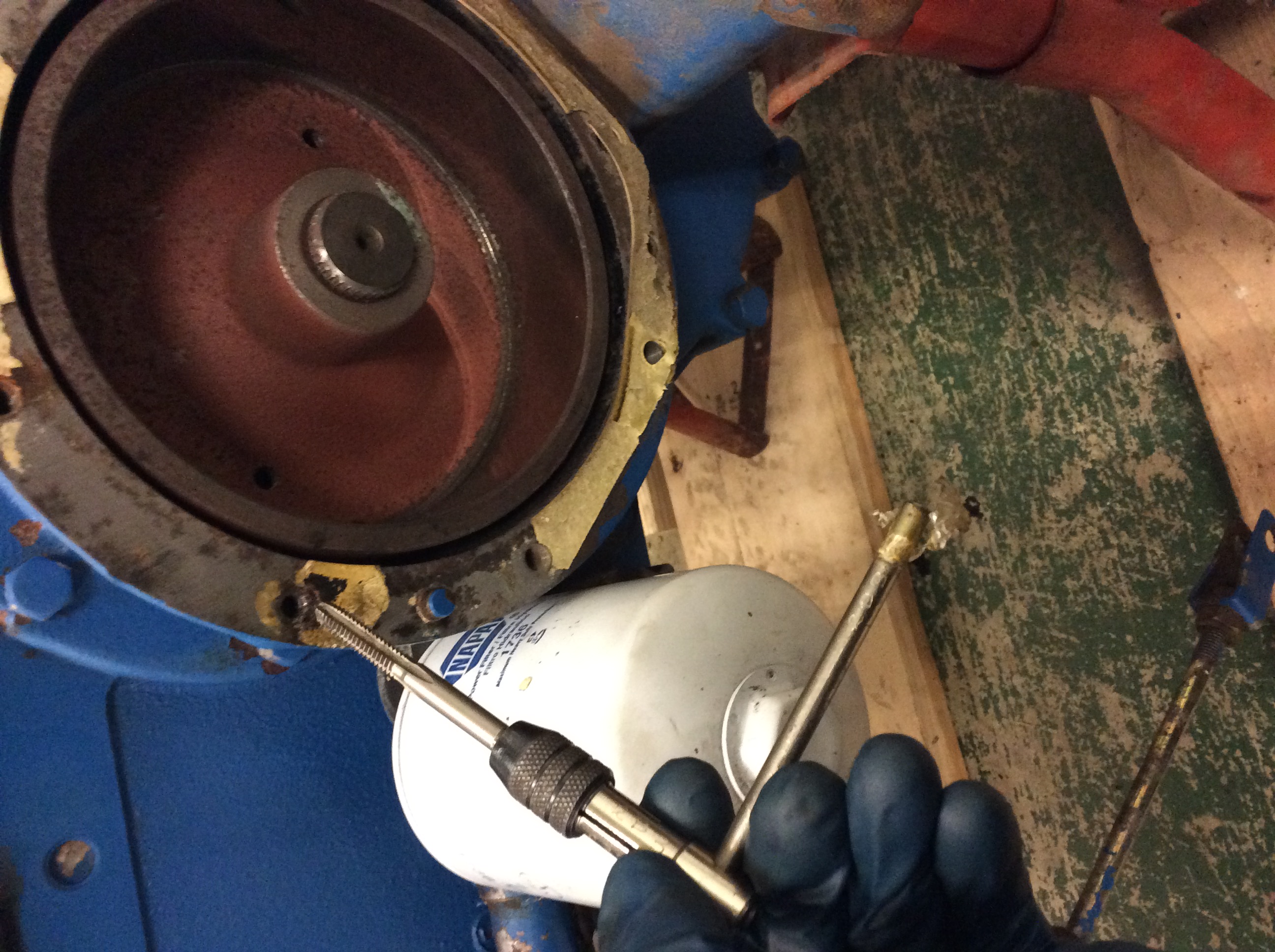

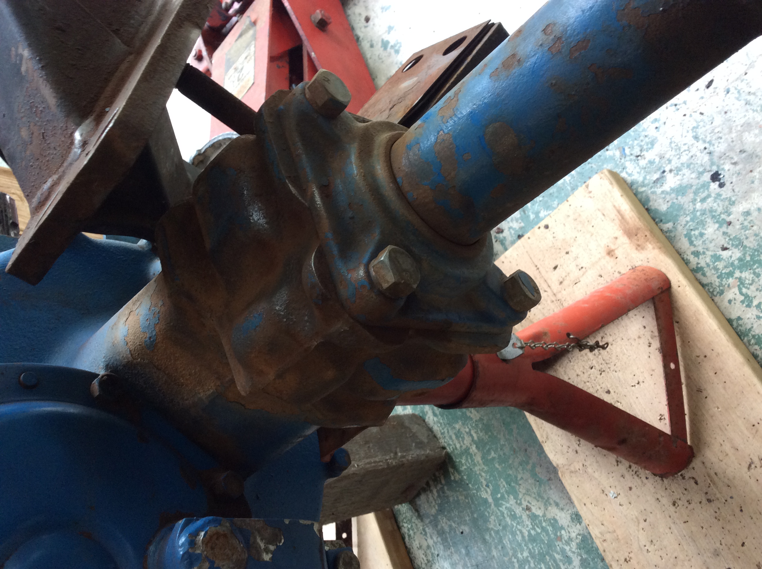

Started removing the bolts for the brake cover and the first one I try to remove breaks off in the casing...aaargh! Put the impact gun away and get out the ratchet, and the rest of the bolts came out without too much trouble. Guess I'll be practicing my ez out skills latter.

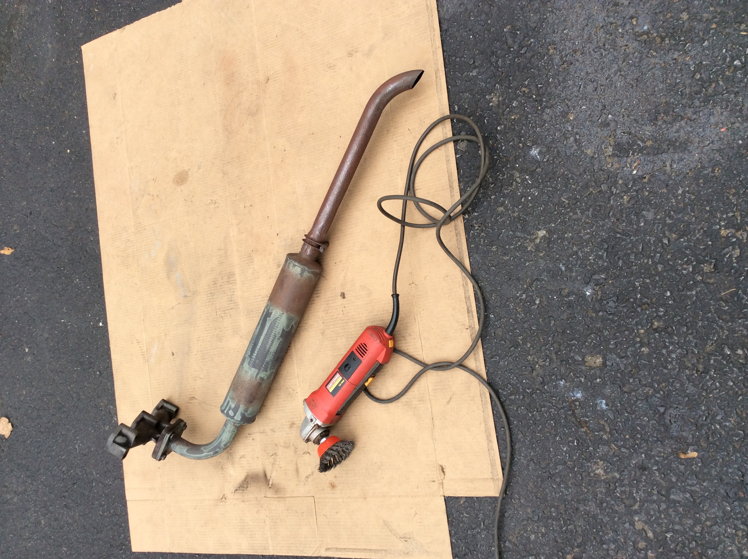

Got the exhaust cleaned off, wiped down, and painted with high heat paint.
Got the area around the axle where the rops mounts cleaned off. Need to paint this as the rust is pretty bad.

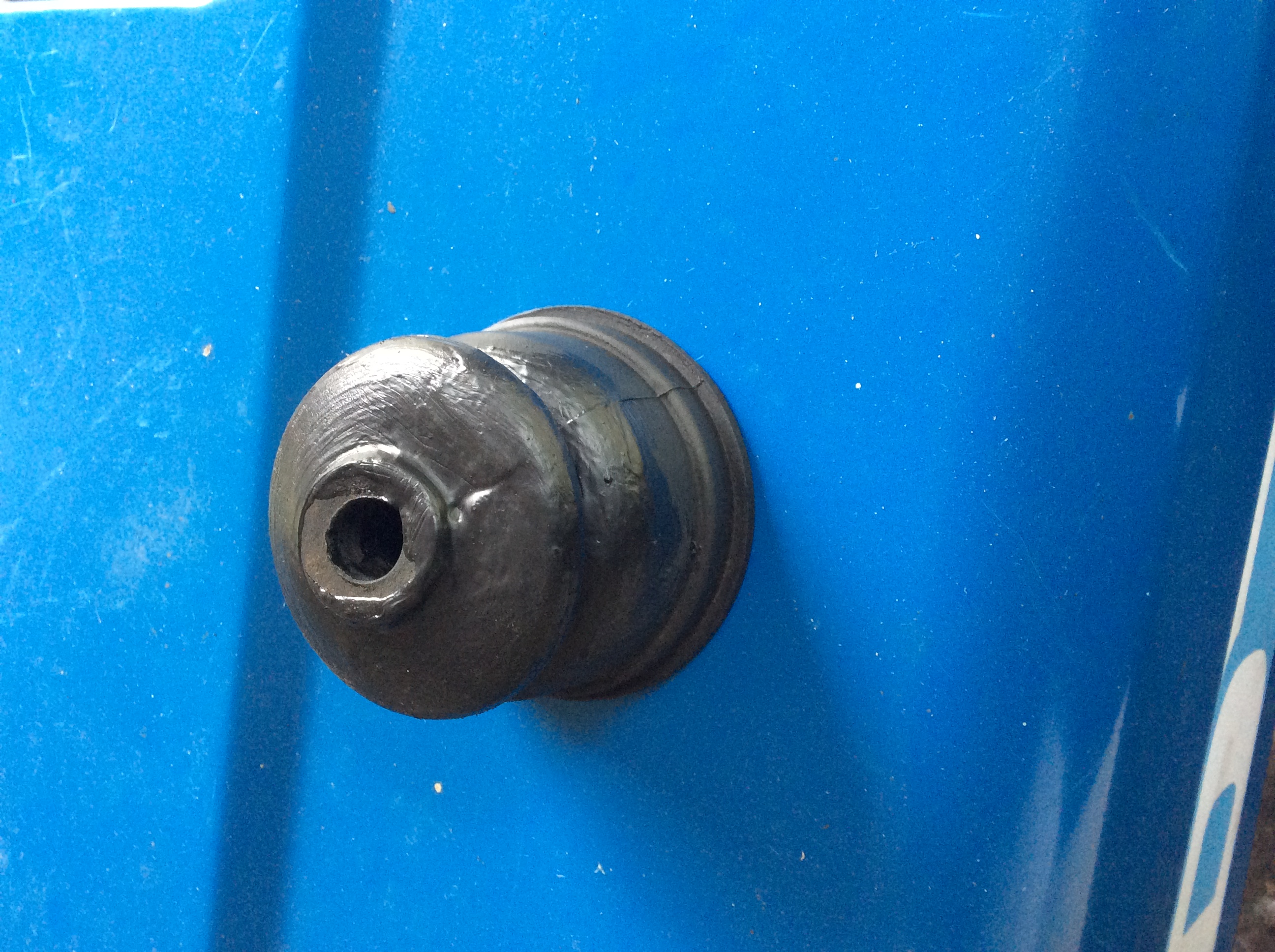

Finished up the shifter boot. Has about 5 coats of liquid tape on it, nice and flexible.

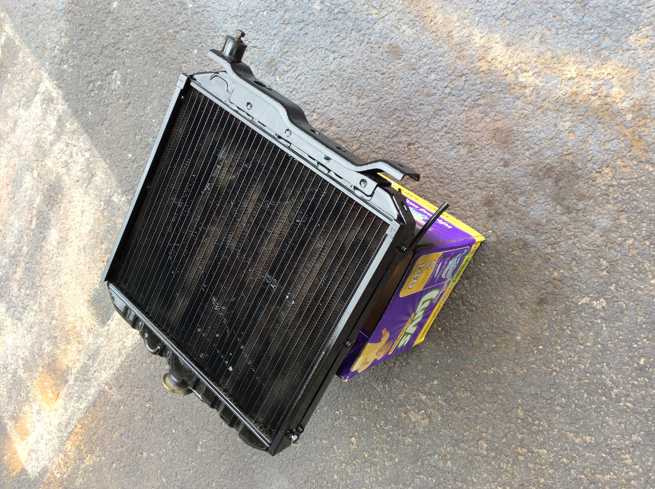

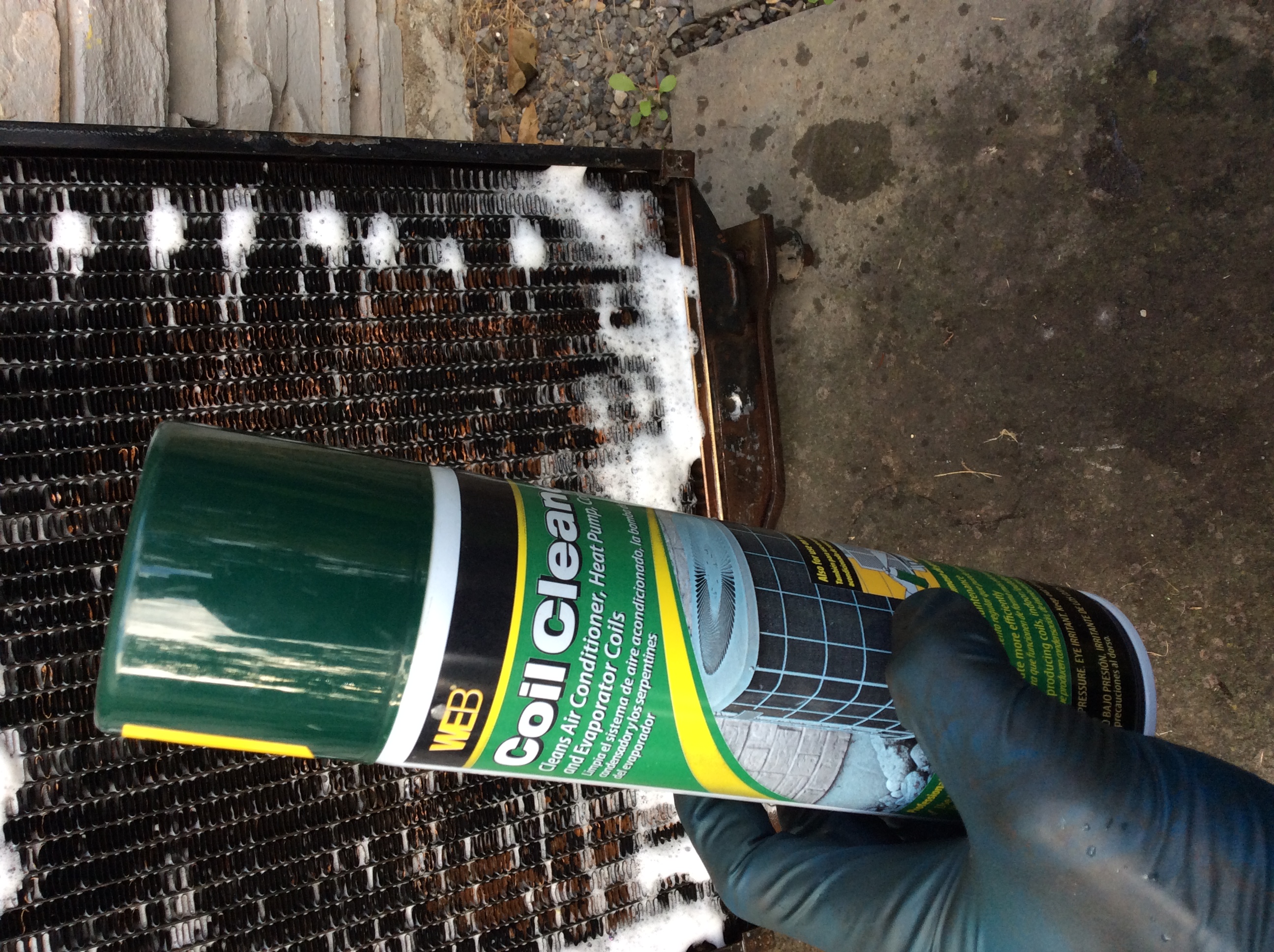

Cleaned the radiator good today and straightened all the bent fins. Will paint it tomorrow.

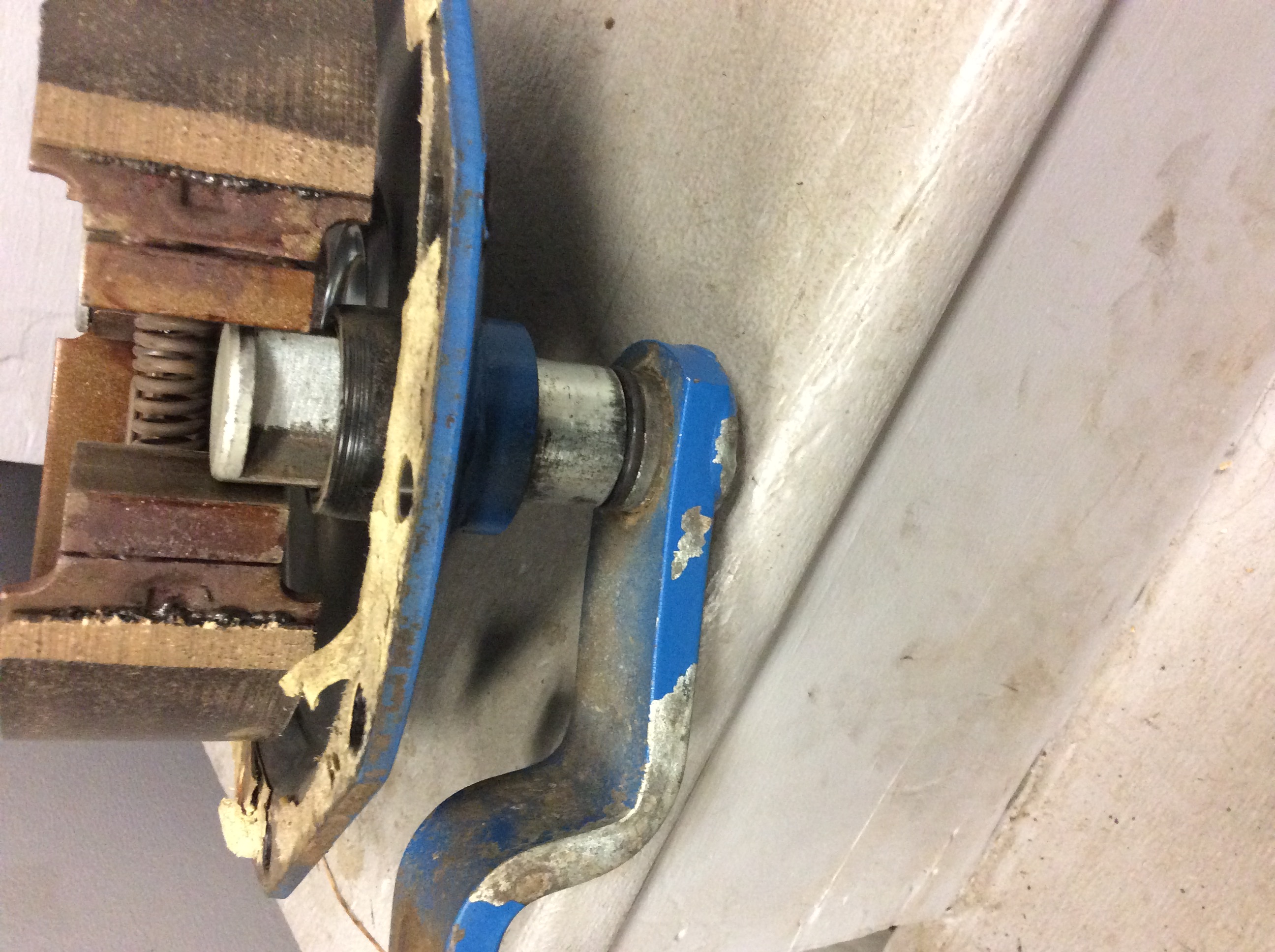

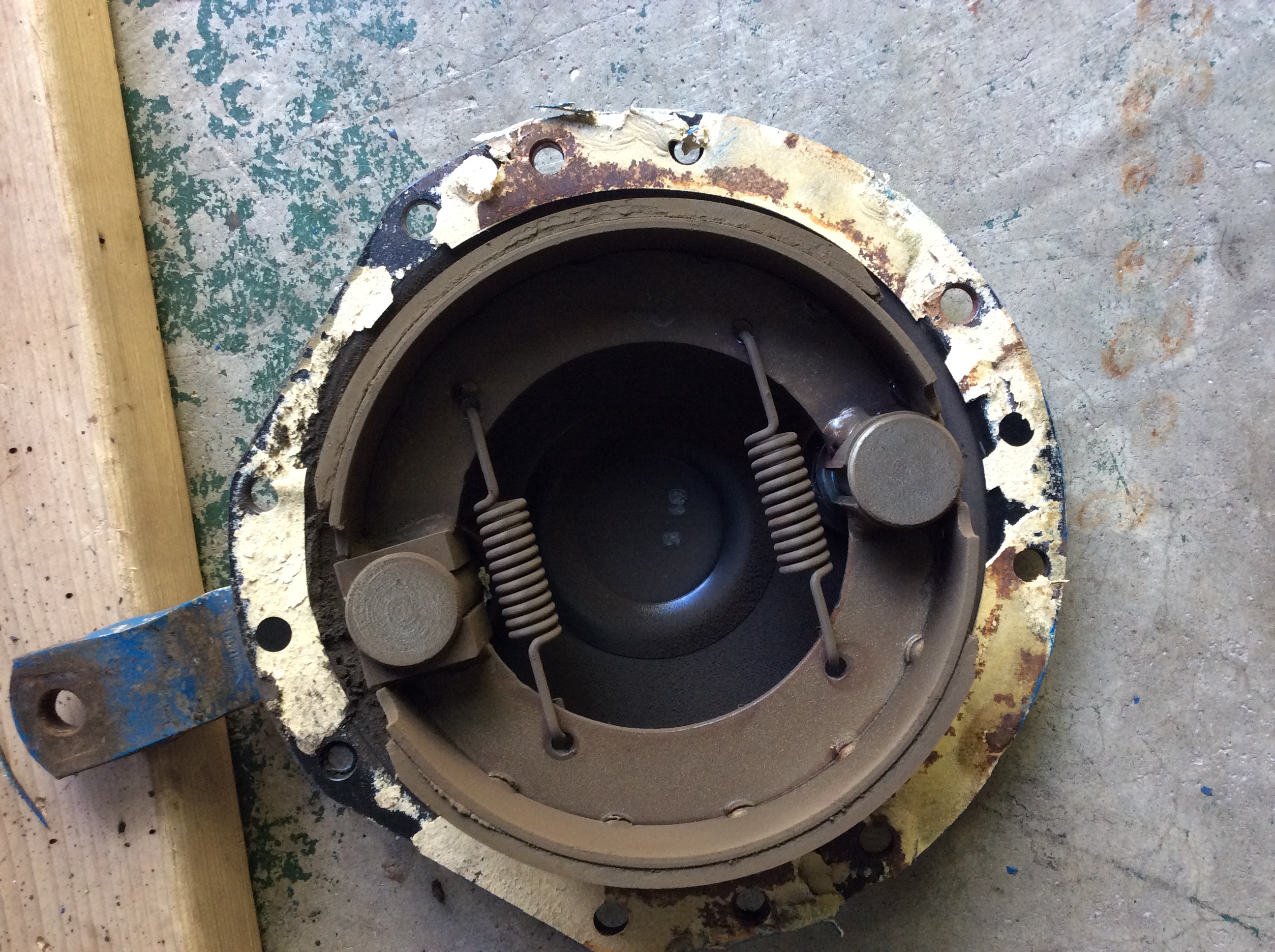

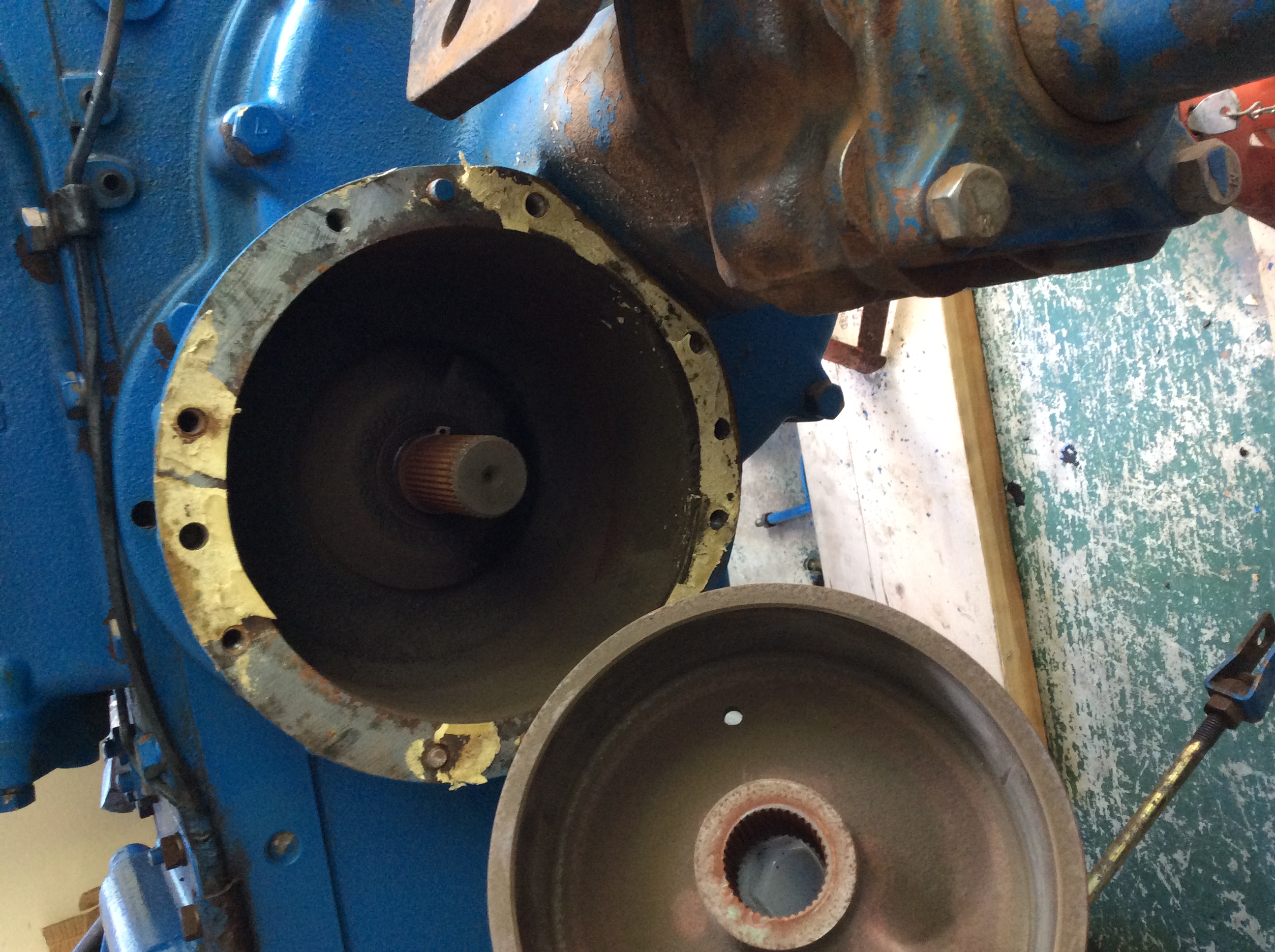

Removed the brake housing, what a pain it was to get off. Some genius used a gasket dressing and essentially glued the thing shut. There is no fluid in here, so don't see the need for such shenanigans. On a positive note, everything looks good inside. Some cleaning and some lubrication and I will slap it back together.

Brake drum removed. No scoring or rust, will slap a coat of primer on the back, clean the shaft and housing and reinstall.

Got the brake housing broken off bolt drilled and tapped.
Removed the shoe spreader and cleaned and lubed everything.

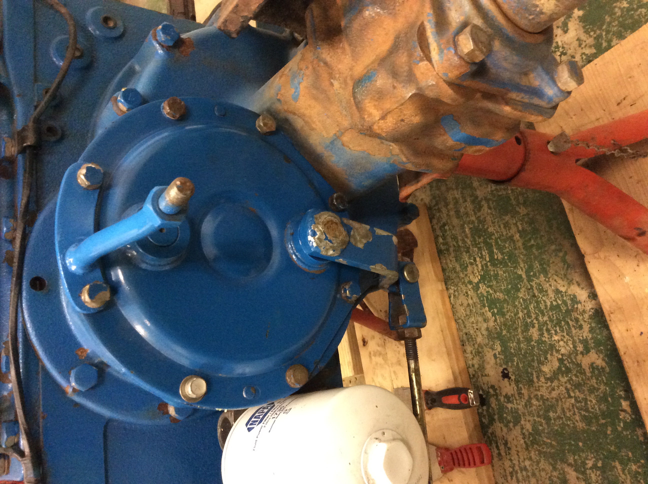

Threw some primer on the back of the brake drum and some gasket sealer on the mating surface. I just reused the old destroyed gasket as there is no fluid in here, and New Holland is very proud of a new one.
The housing back on.
The left brake adjusted to 1" of free play.
Primed and painted the radiator as there was some rust on the lower half.

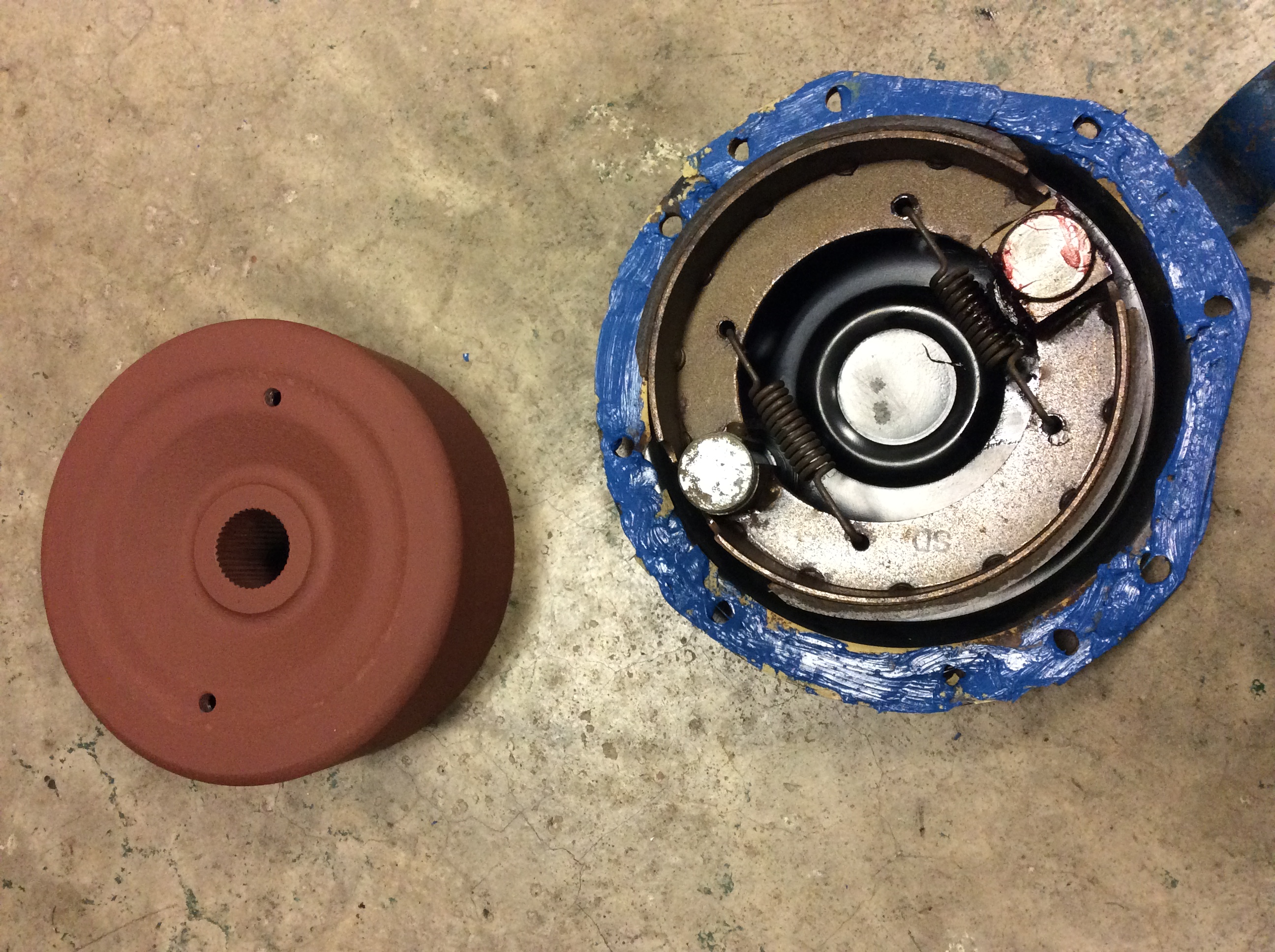

The right side brake pack looks wonderful too. The shoe limit is 3.5mm, and I'm at 4.5mm. They are only 5mm when new. Going to finish cleaning, lubing, and install it back on the tractor. Will adjust this side to 1" pedal travel too.
