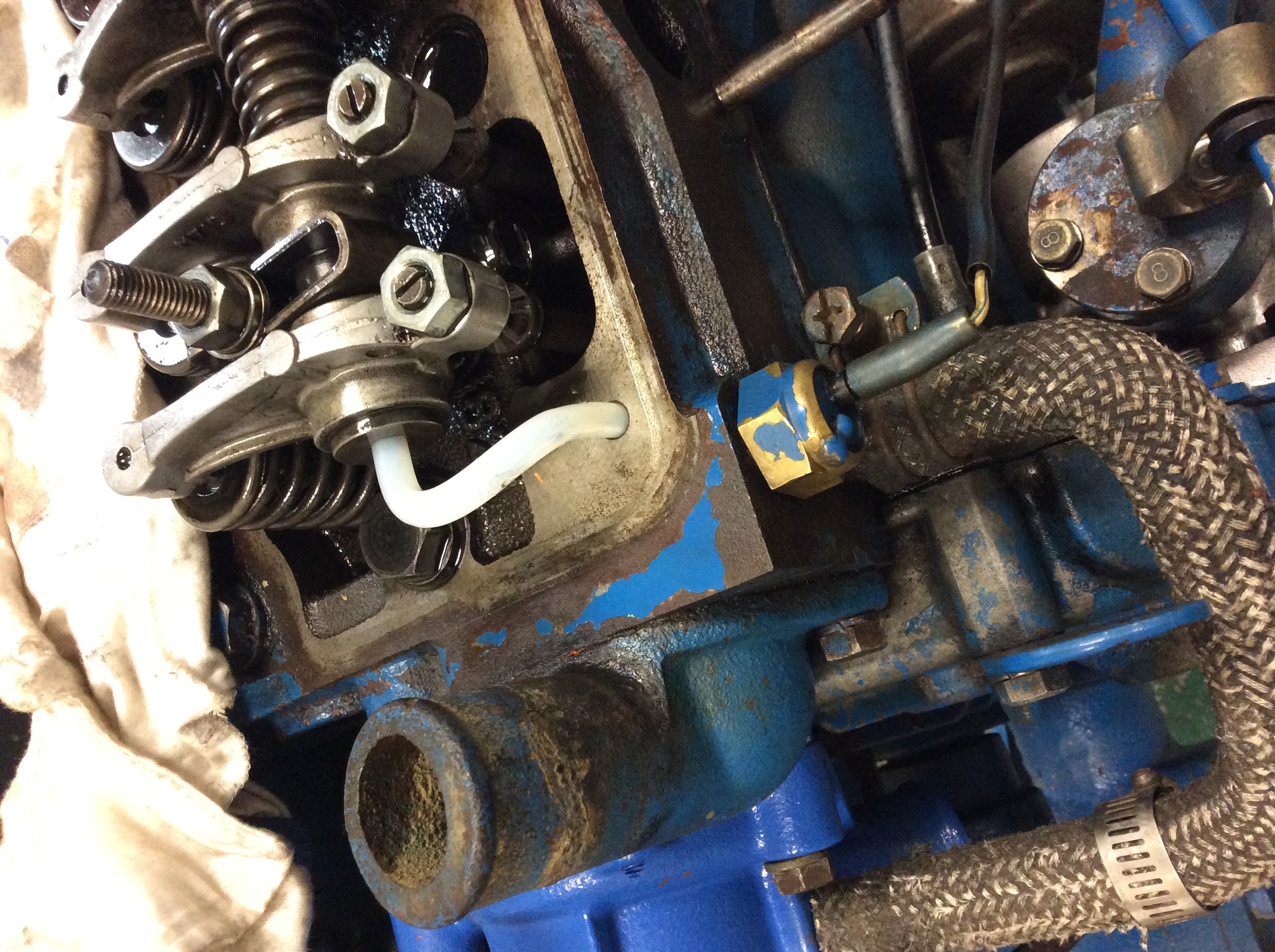

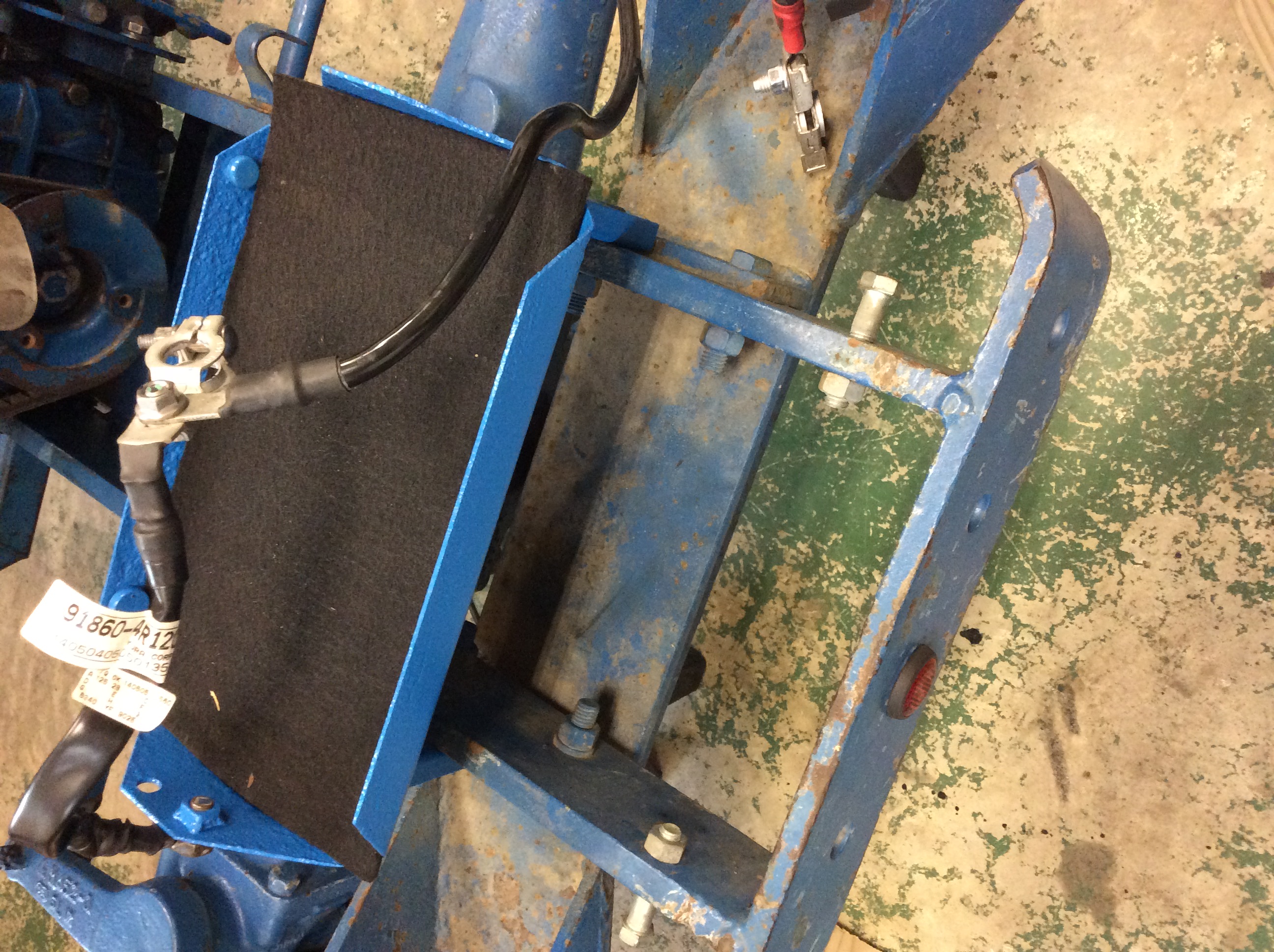

Battery box installed with new ground cable and backing soda infused battery mat.
Found some plastic tubing that was the perfect size and can resist temps up to 500 degrees. Will run the tractor a bit and see how it is holding up. I'm hoping it doesn't pop out as there is nothing holding it in. It was very difficult to get in the hole, but with heat and pressurized oil, you never know.

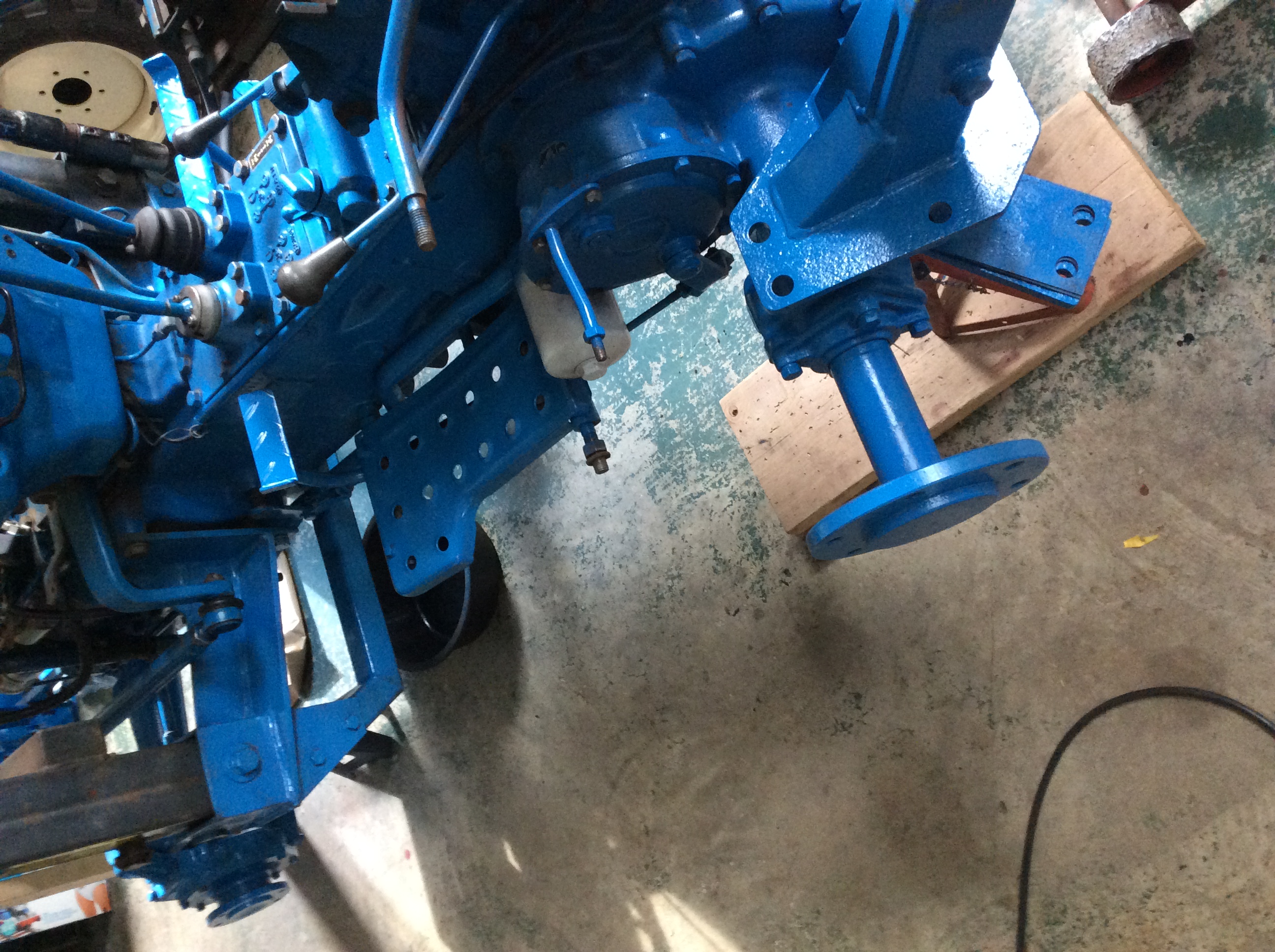

Drained the front differentials and out drives. The fluid was nasty!

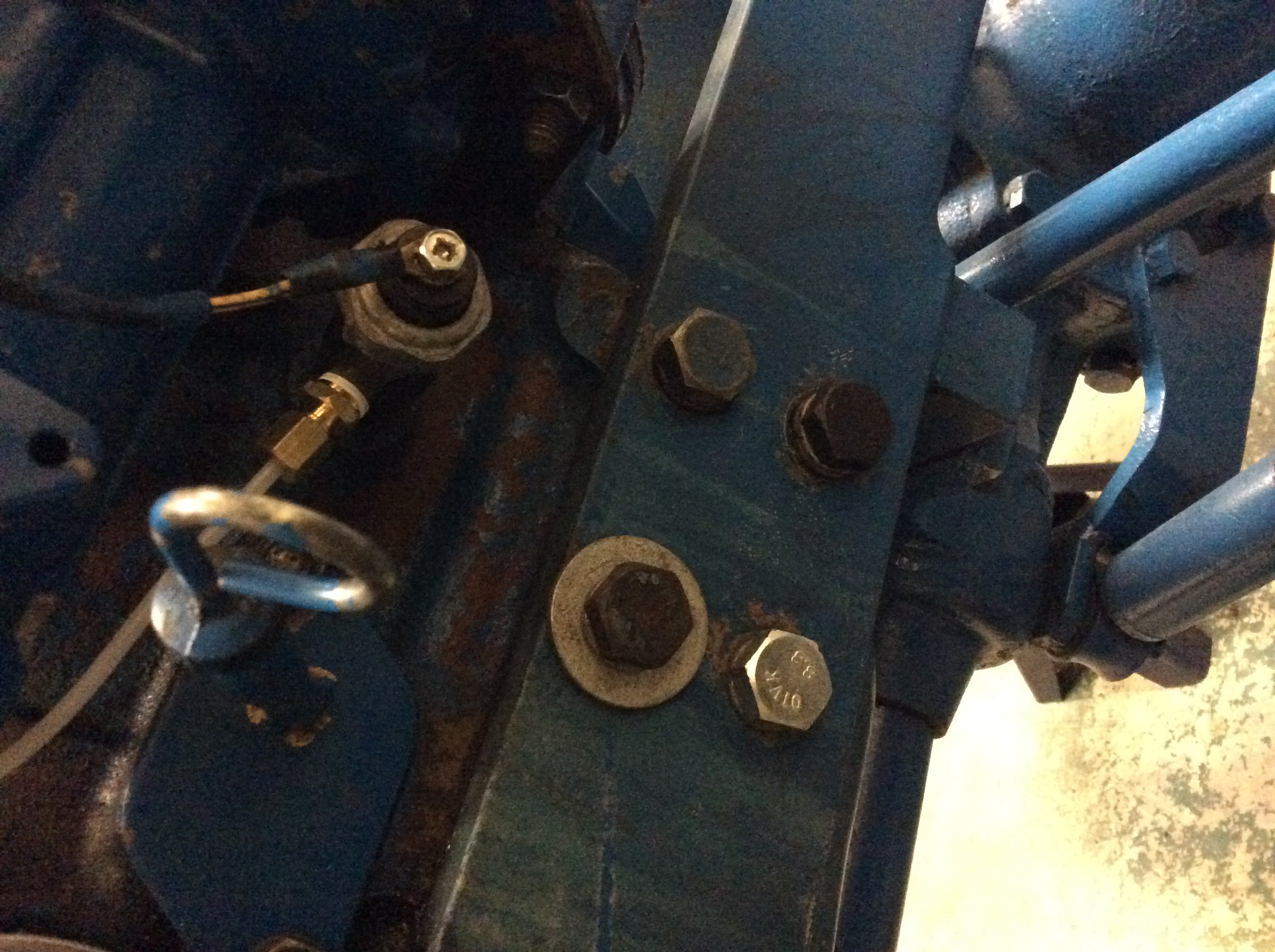

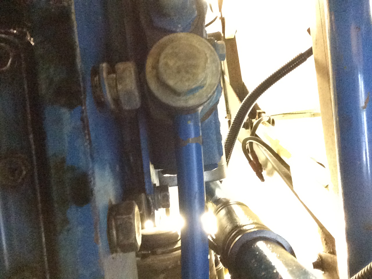

A warning to other 1510 owners! I found four of the six front frame mounting bolts on the left side finger tight. One was backed all the way out and the only reason it didn't fall out was it hit the back of the power steering pump. Definitely glad I looked up in there, that could have been a bumpy ride had they fell out.

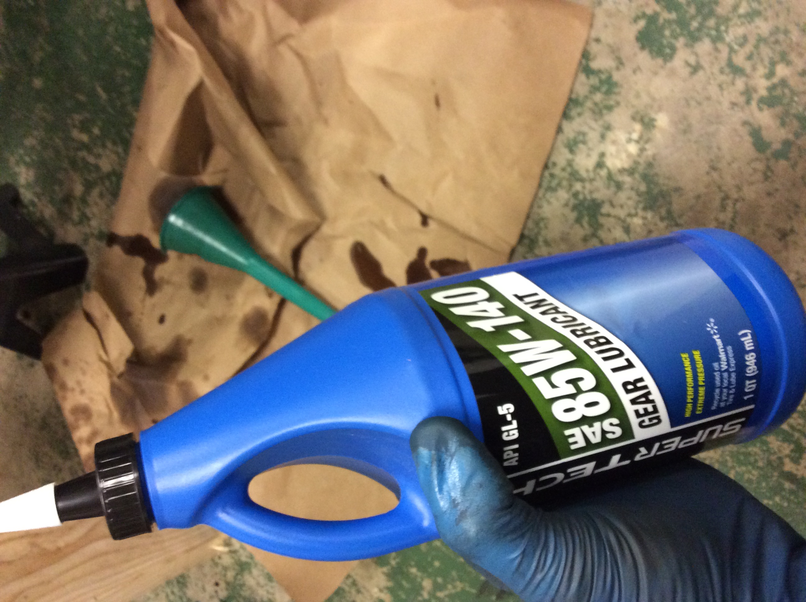

little bit done tonight after putting the kids to bed.
Putting gear oil in the front diff and out drives. They had gear oil in them when I drained them, so I went back with the same. It took exactly four quarts.

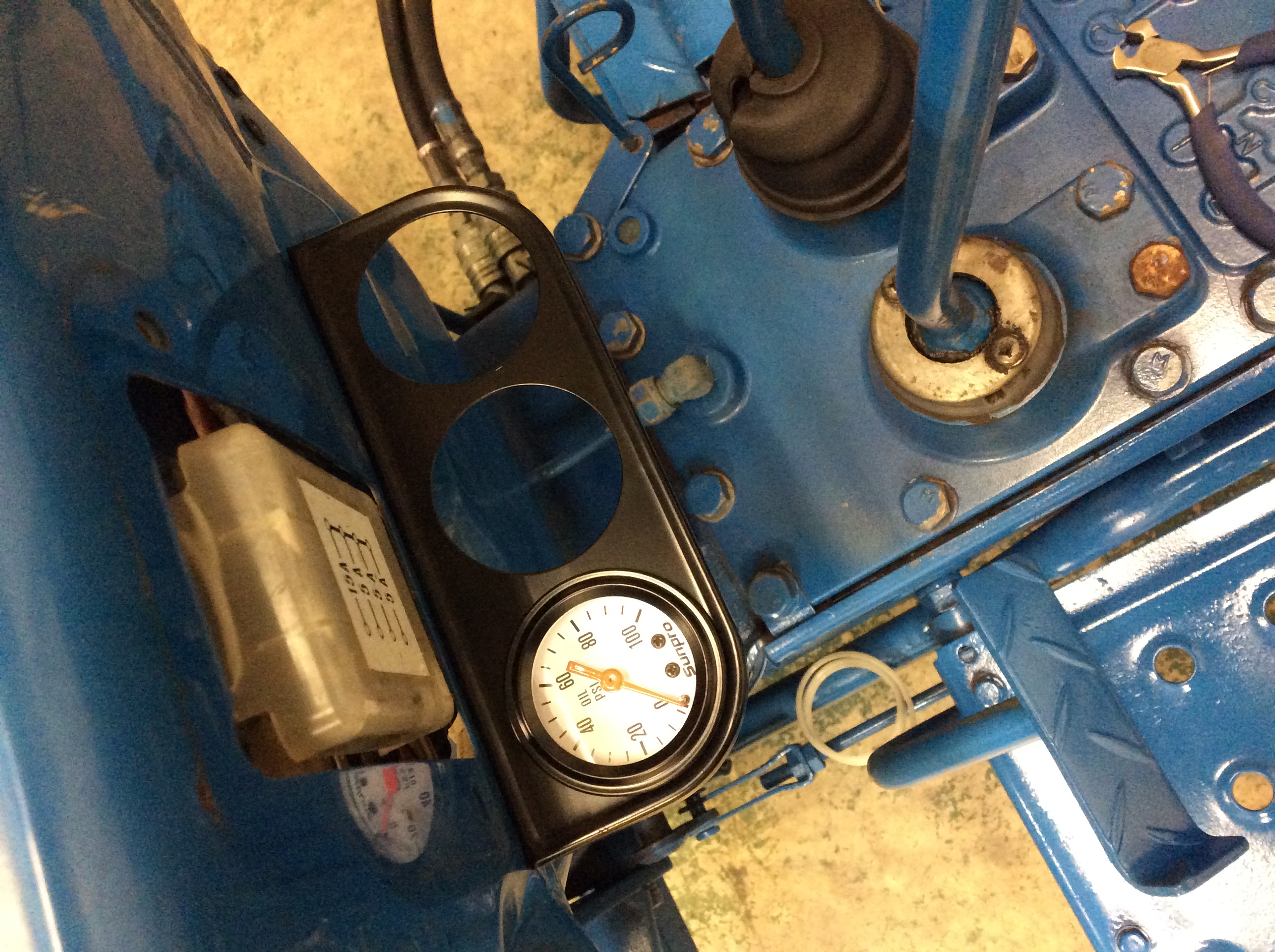

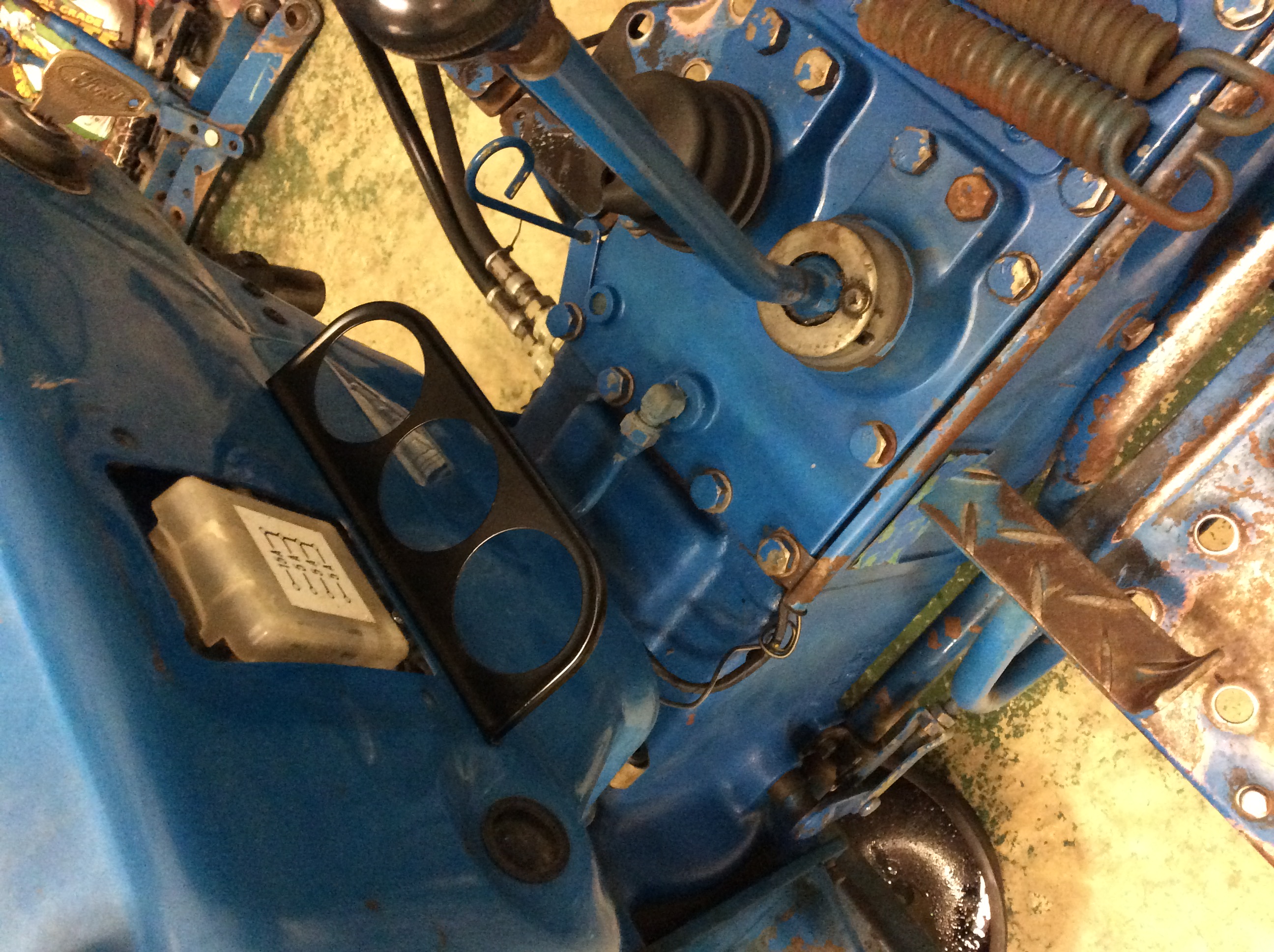

Got the gauge cluster bracket installed.
Next is some painting...

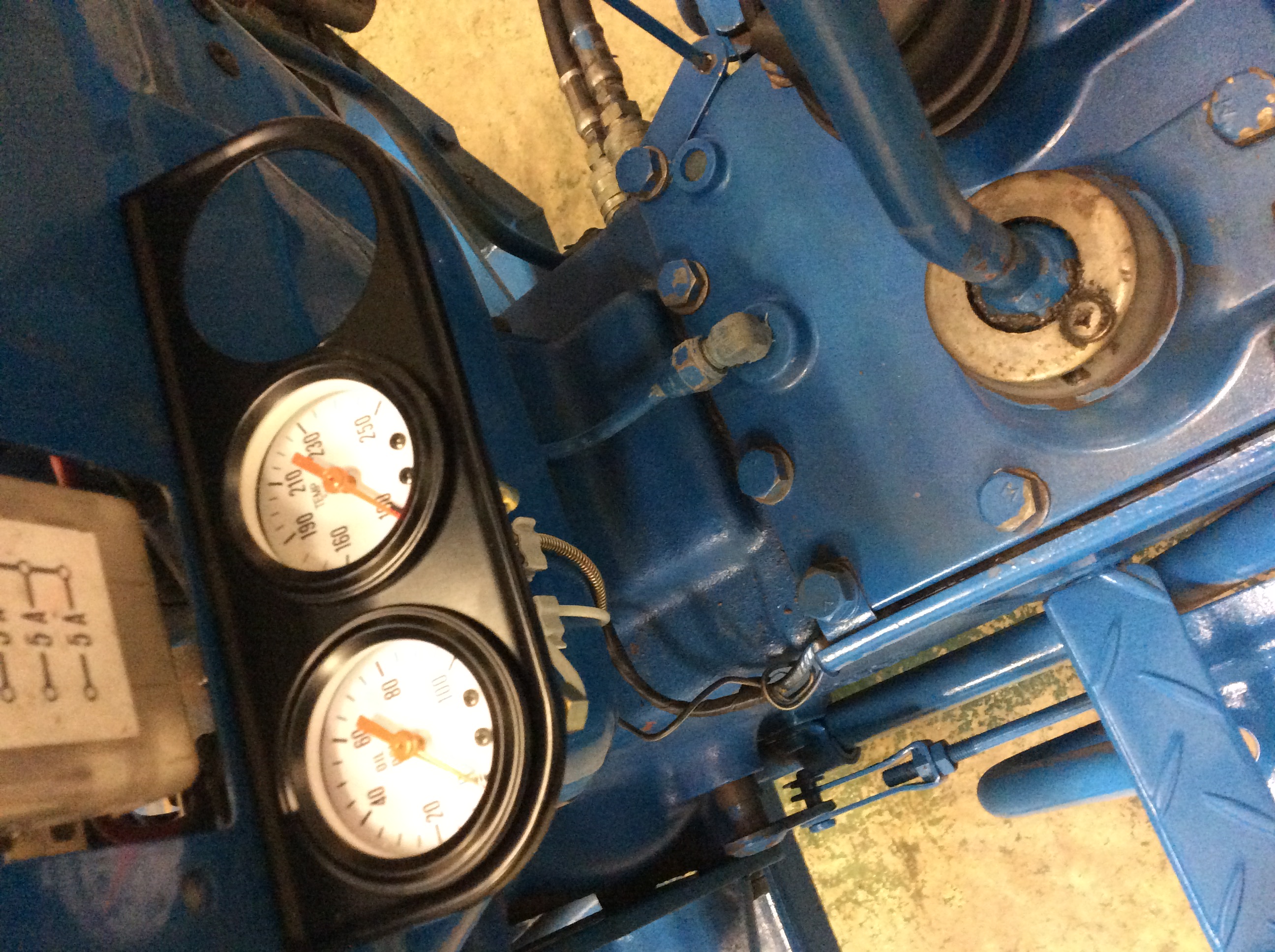

Some progress.

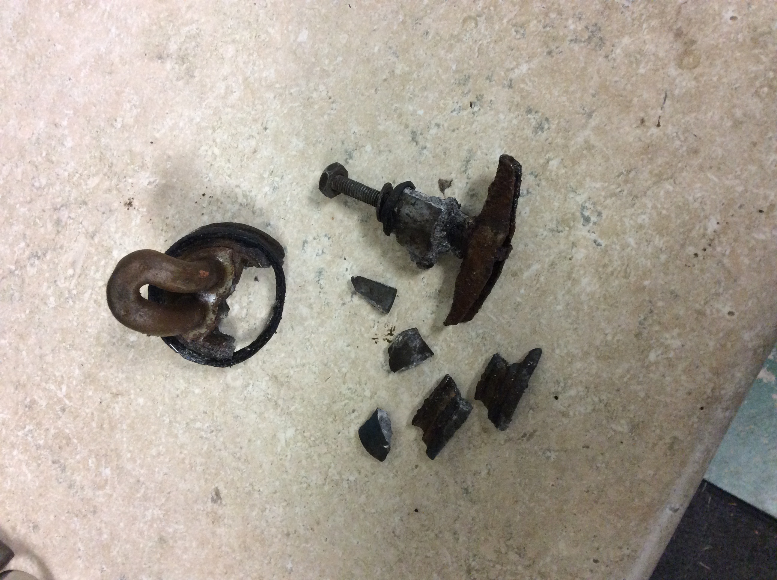

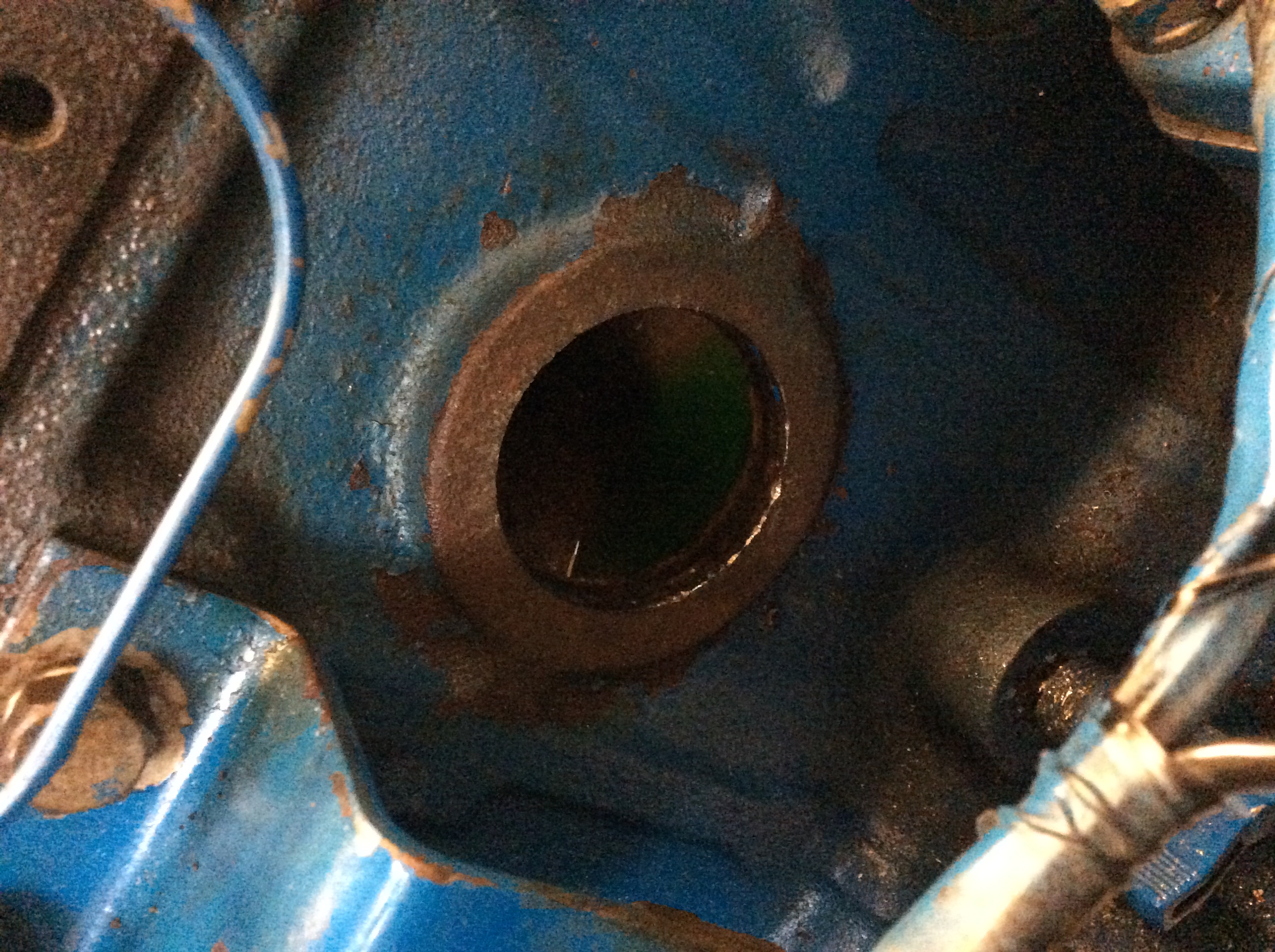

Got the block heater out finally. I drilled holes across it and then slid a hacksaw blade in and cut it in half. Few whacks with a drift and hammer and she poped out in pieces. I measured the hole and it is 40mm. I found a Katz brand online for $15. Hopefully it fits.

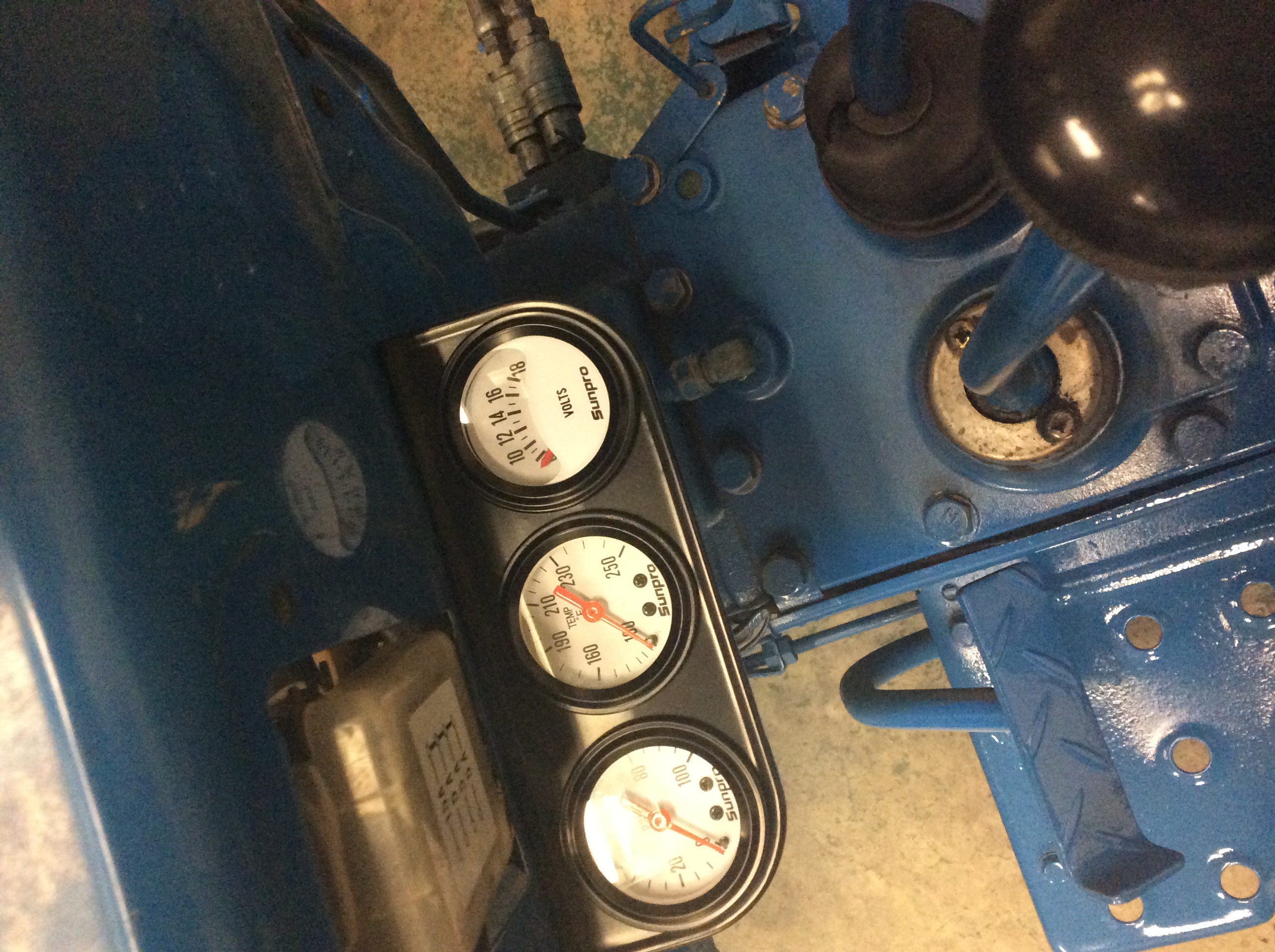

The oil press gauge and T fitting installed. Found a fitting online with the proper BSP thread pitch, fits great.
The water temp gauge installed and sending unit in the water pump housing.
Have to get some more blue paint and finish that up before the weather turns sour on me. After that the hyd fluid gets changed, stay tuned.

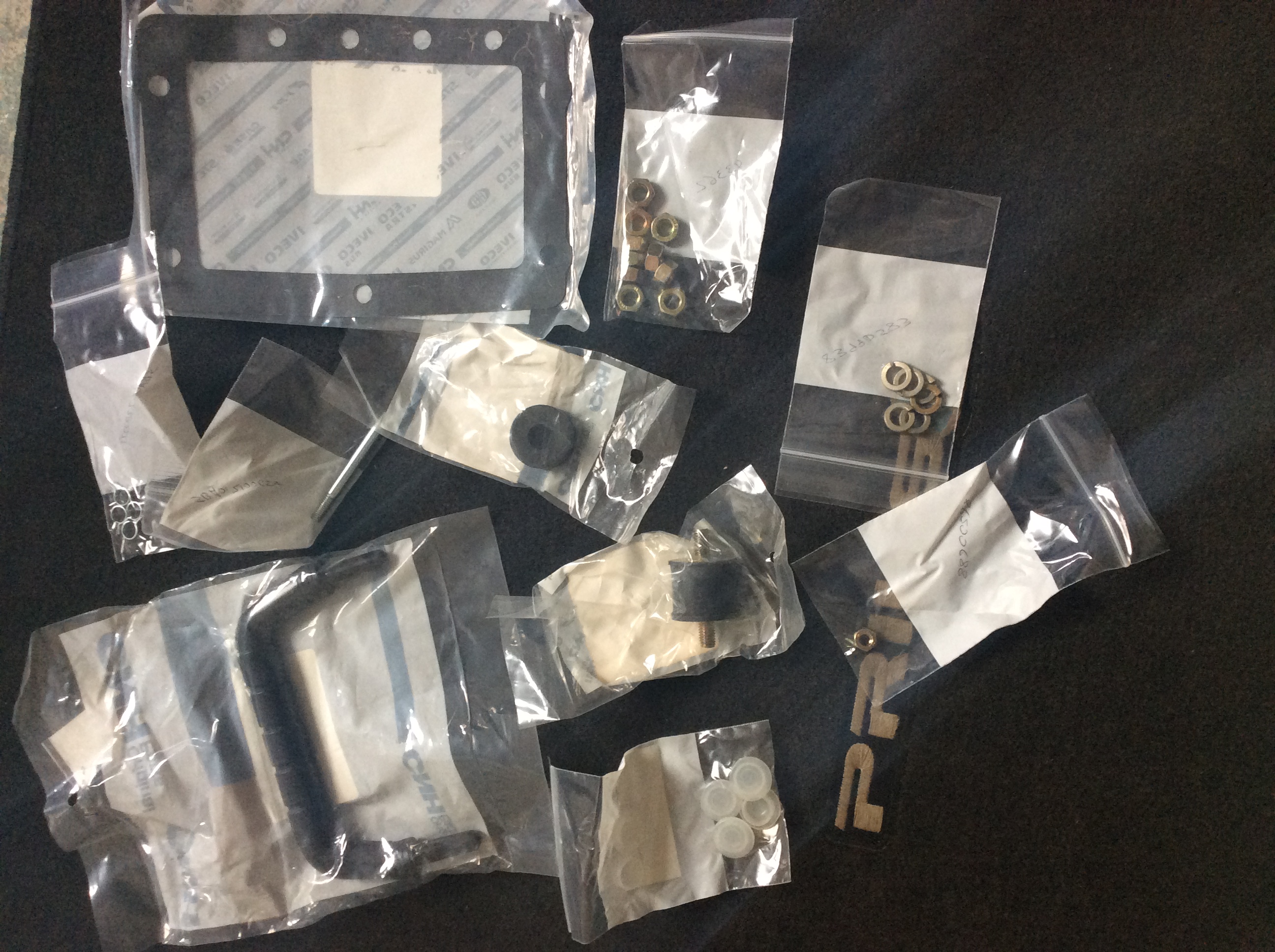

Got my Messicks order today.
Will finish up painting this afternoon. Hoping to drain the hydro fluid tomorrow night, and remove the cracked hydraulic hoses.

Got the rest of the painting done.

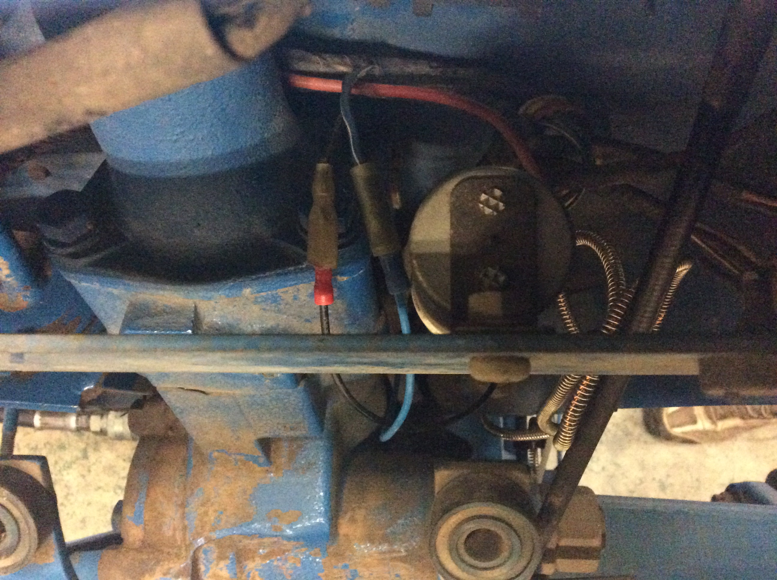

Also, installed the voltmeter. Tied it in to the available front pto wiring that wasn’t being used.
