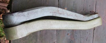

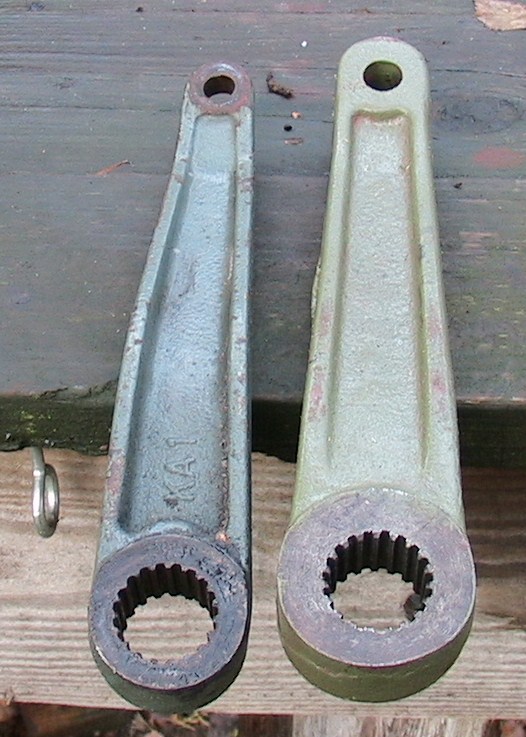

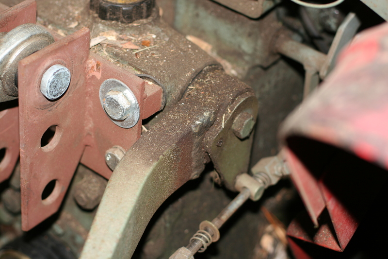

I thought I would update the thread. I got the new lift arms that I ordered from LMTC--Wayne is a good guy to deal with. I had a friend coming over from the States and he brought the arms with him. I expected beefier arms, but this was surprising in the difference between the old and new. What a contrast!
They are so much thicker than the old that the original rototiller lift did not fit well at all (I had to spread the sides of the top bracket of the lift links.) I believe that it is time to modify the links so that they fit on a standard lift pin on the arm.
So all is well and we're back up and running.
Mike
   / 1510 D Upper lift arm broke #20
I'm a little/lot confused about what didn't fit. Don't you just have to bolt the pins to the upper arms, slip on the lift links and secure with a clevis? The only brackets/yokes on the links should be at the bottom.
