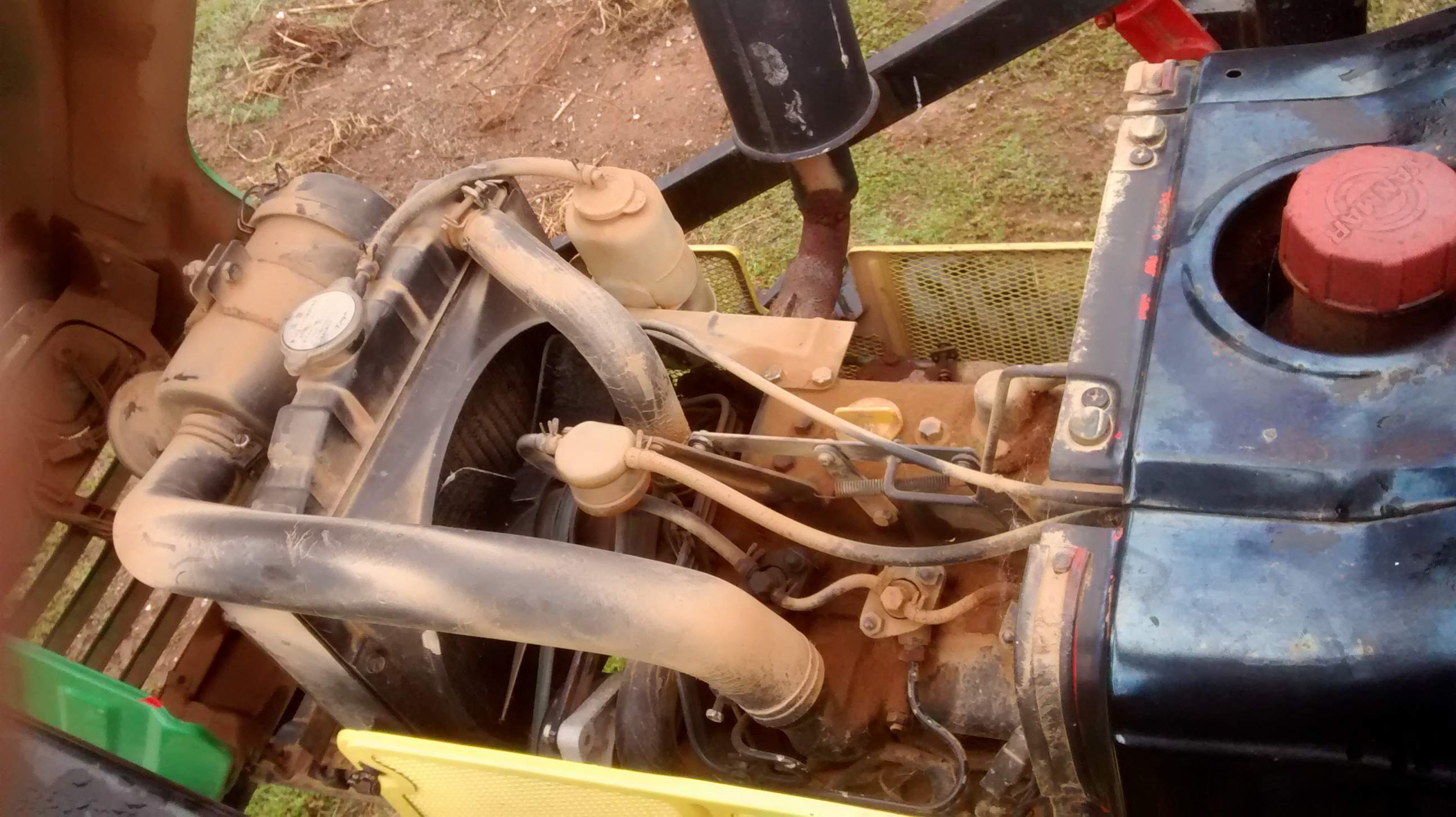

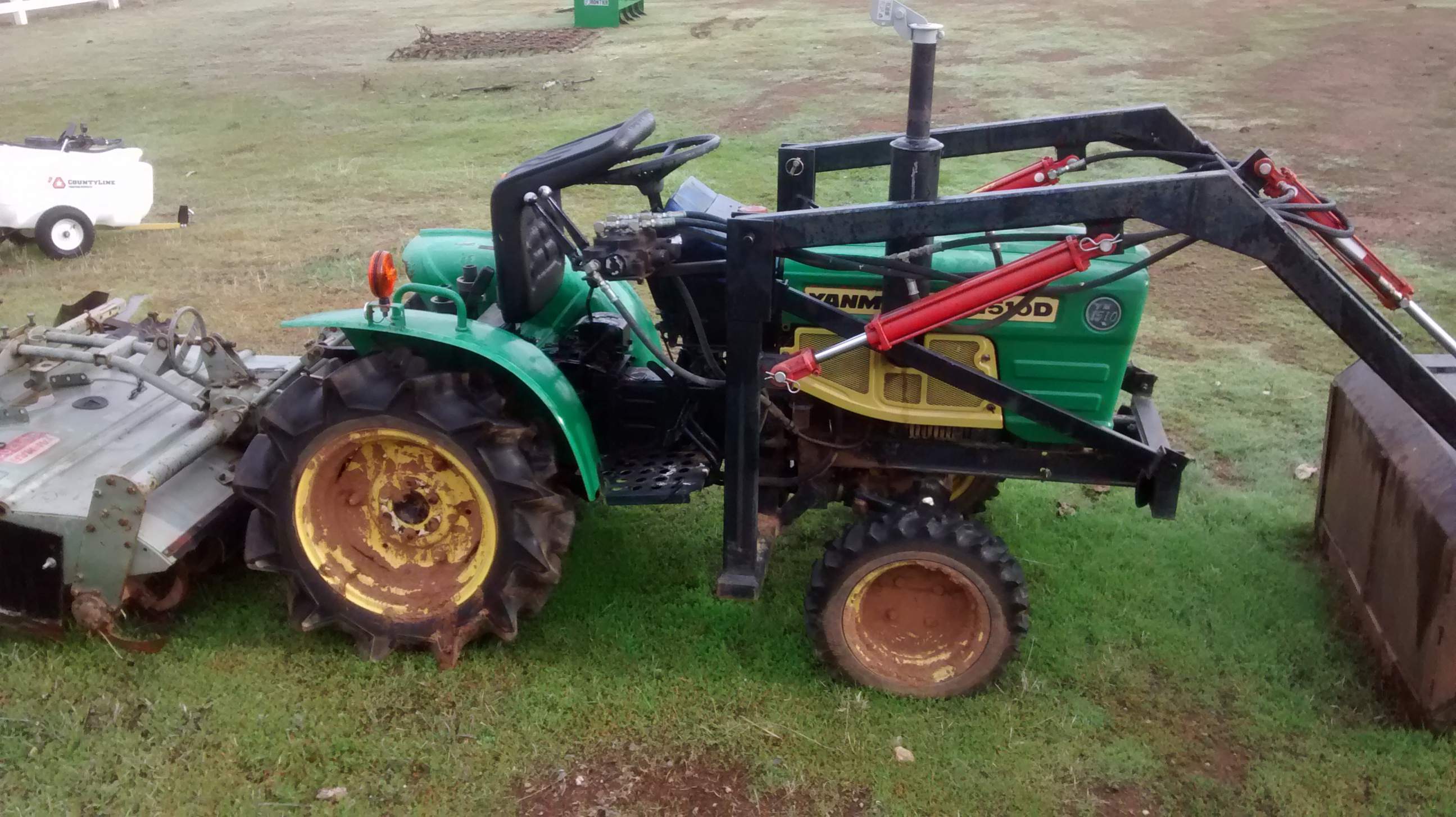

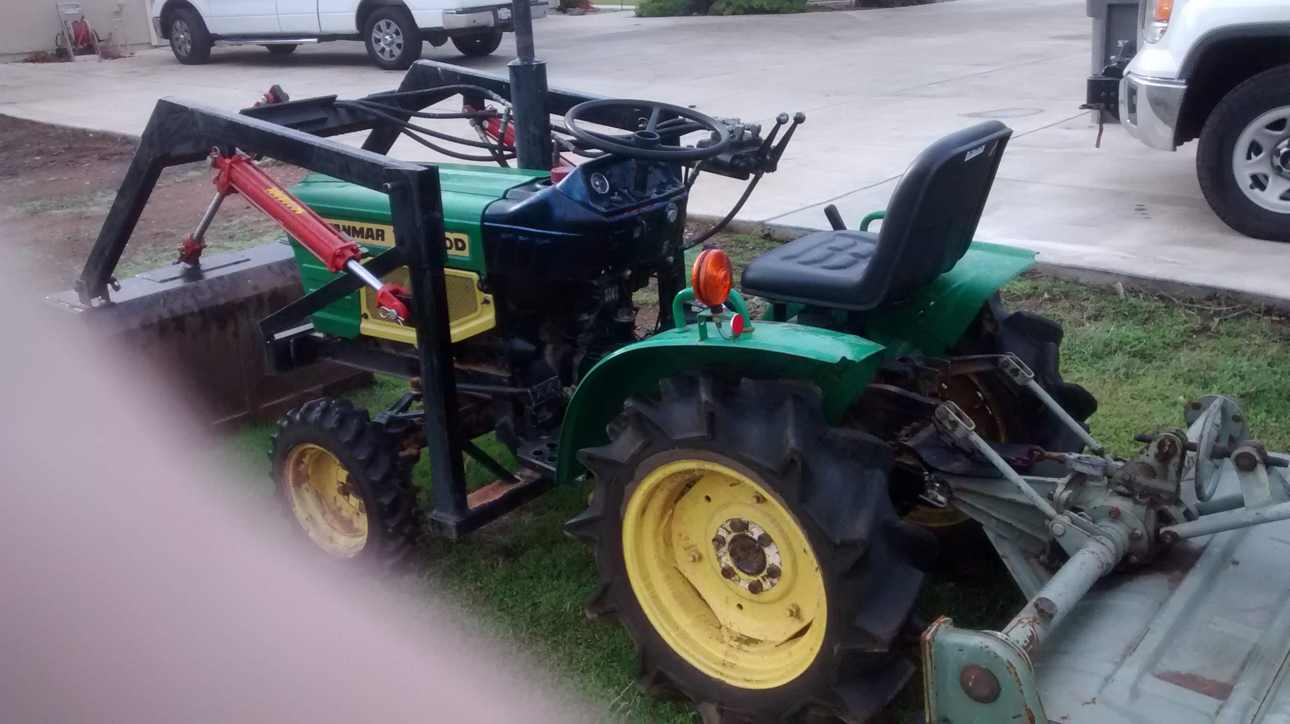

Thanks for the link California, that is AWESOME!!! I will be using that.
It is not the $8k 155D
I think 30 HP is a little big for what I want/need
We were not too far off on price, I came up a little but he wouldn't budge.. maybe in a few weeks one of us will budge a bit. I probably would have split the original difference but it does not seem like he is in a hurry. Hardest part I had was pricing out what I thought would be a downside of the 2pt yanmar tiller which is not as easy to switch out along with the lack of ROPS. Maybe I was a bit low, maybe not Used tractors are not the most liquid market around here.
/ 1510D Advice #42
That 2-point proprietary tiller will be a PIA for anyone who wants to use alternate implements on that tractor so I think its reasonable the tiller is near valueless for pricing the combined rig.
