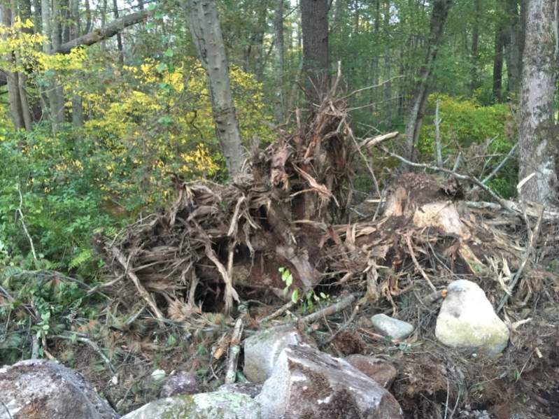

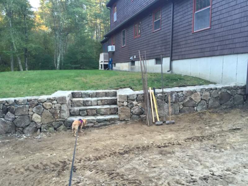

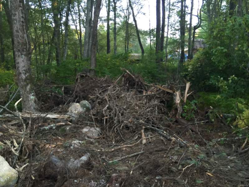

Cut and stumped 19 huge pines and build a stone wall harvest rock from my woods hours add up quickly
