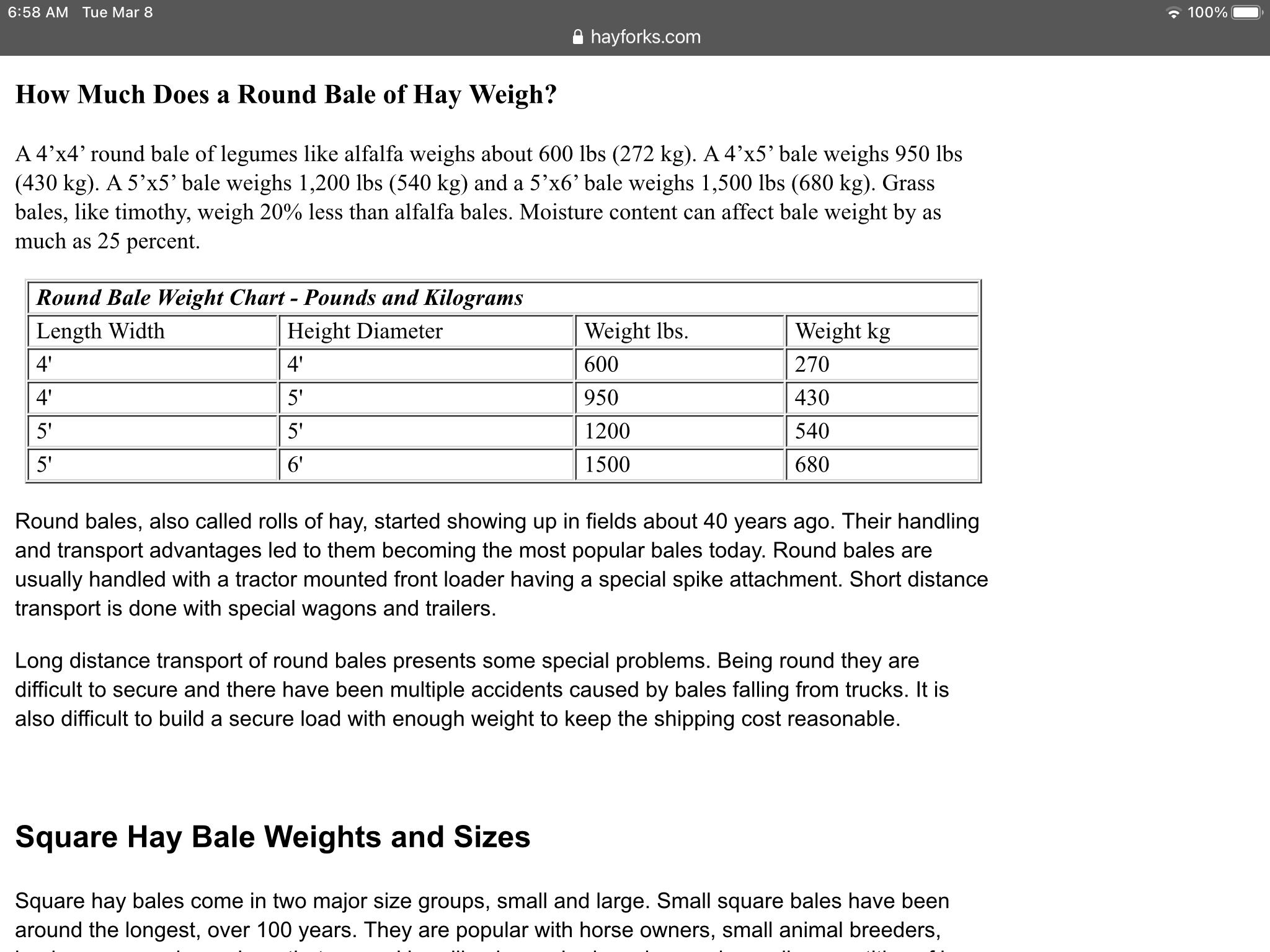

Also noteworthy that very seldom would a 5’ round bale weigh 2000lbs. Never seen anything close to that.
It would have to be soaking wet to weigh 2000lbs.
Ive made about 20,000 super dense 4x5’s in the last 10 years and they were about 950-1050lbs average. Even if it was a 5x5 round bale, it might weigh 1300.
2000 lbs is what my dense 4x4x8 square bales weigh.
If your loader can pick up 1200-1500 lbs, you’ll be fine moving any dry 4x5 bale and almost any dry 5x5 bale.
Not to get into a peeing contest but where I come from a "5 foot bale" means five feet wide. So yes you can have your bales made smaller in diameter and thus at less weight. It is easy if you have a Bale Command or similar baler control. Not so if you have manual controls. Most "five foot balers" will make a bale 6 feet in diameter and they are near 2000 lbs in weight.
Fair enough. I was going by 5’ in diameter.
Might be a regional thing?
6’x5’ bale is much bigger, but still have a hard time seeing 2000lbs from one.

My little B26 can move 5x5 bales to the feeder. It’s 1200# lift goes along with the chart. Not my preferred tractor for moving and stacking loads of bales.

Yes. The star developes when the core bounces fairly loose in the chamber till the belts finally start to tighten.
I always check the density of the bales first. If I can't get my stretched out fingers in, the 5x6 weighs more than 1500 lbs. Can I get my hand in up to the wrist, it's somewhere between 1300 and 1500. If I get my whole arm in, it's loose and less than 1300.
